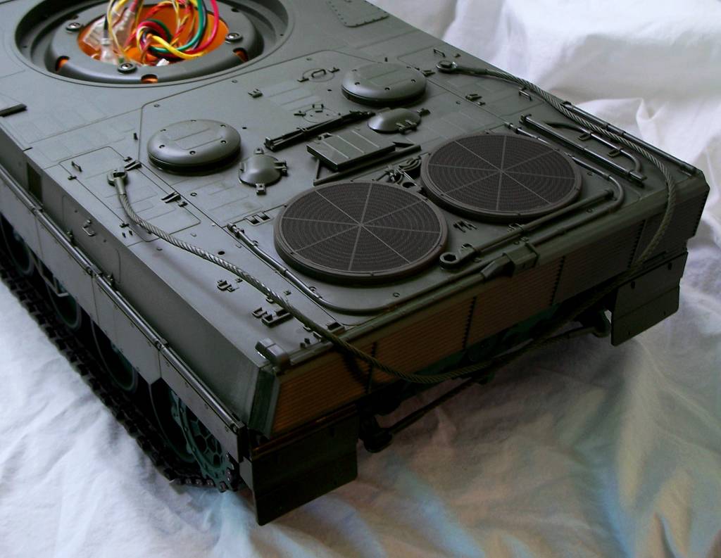

I believe the radiator covers are removable because they conceal the rear two screws for attaching the upper hull. One thing I did with mine that you may want to consider is adding a few pounds of ballast weight in the nose. With the weight of the engines in the rear and the turret centrally mounted the tank's center of gravity will be towards the back. This makes the Leo drive and negotiate terrain a little strangely compared to the real thing. These tanks carry enormous weight forward due to their heavy front armor protection. The model's nose shouldn't "bounce" up over stuff when driving. I did the same thing to my Pershing and it runs much more realistically now. It's just a suggestion...

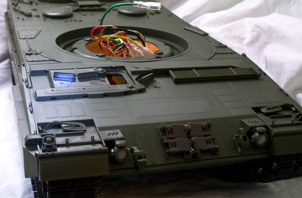

Well guys,
I must apologize for not really keeping up with not only this thread but the documentation of my build. I kind of felt there wasn't very much interest. But since the thread has been brought back up, here I go.
The past two days have been a complete nightmare....something I don't think many would expect to face althoughI've read some people having this issue. While my impatience to test drive the Leo around before it was finished got the best of me, it served to be a useful choice. I discovered the lower plate of the turret was hitting the radiator grills and folding them. For some time I couldn't figure out exactly what was going on, so I went back through the instructions hoping something would reveal a fix or something I overlooked. I even flash forwarded to see if there was going to be another part expected to be glued or added so it catches to thebottombackside of the turret. Nope.
This discovery was noticed after I had completed the wiring. Sigh.....
So, I had to dismantle and disconnect everything so I can start with the turret assembly all over again. Step by step, Imonitoredthe back half of the turret for properclearance of the radiator grills. All looked well, until I began the wiring process. Bit by bit, the back half was slowly but surely lowering the more I bundled wires, put the DMD back there, the lower it got......tillfinallythe battery was added and down it went. Pretty frustrating stuff.
I think I can wire a leo with my eyes closed now, because I've done it four times (gonna have to do it one more time for the painting process, dang it!) On closer examination, the back panel sagged a bit...basically slightly warped on a downward angle with no weight added..., butnoticeable. I didn't want to add any type of wedge in the rotation ring to raise the overall height of the turret. Only two possible solutions came to mind. Add a ton of counter weight to the front of the turret and hope this corrects it (which I doubt since the front stayed level as I added everything).....or correct it. So what I had to do was applyintenseheat with a heat gun having the panel laying flat on the surface of a marble table and pray it doesn't warp it altogether. Since thick abs can with stand a good degree of heat, it's a really touchy situation to get the right amount of heat before melting point.
Well, needless to say, it worked or I would be posting something that used to look like a Leo.
Thebottomplate is as flat as it should be with no warping.

<div style="margin-top: 0px; margin-right: 0px; margin-bottom: 0px; margin-left: 0px; padding-top: 0px; padding-right: 0px; padding-bottom: 0px; padding-left: 0px; background-image: initial; background-attachment: initial; background-origin: initial; background-clip: initial; background-color: rgb(255, 255, 255); font-family: Arial; font-size: 12px; ">Yeah, when routing and bundling the wires, it's pretty hectic. But as you get to the 11th or so wire, things start to fall in place, lol. I had to utilize the battery panel and route 3-4 cables underneath for a bit more cleaner look than adding them to the wrap around.<div></div></div>Here's how you remove the battery Chris.
There's a lock knob that you twist off to remove the upper half. It's normally hidden behind that panel that I still don't know what it's for on the real thing, (me thinks its a stowage area) but looks cool when it's opened......like elephant ears on a cockroach, lol.
