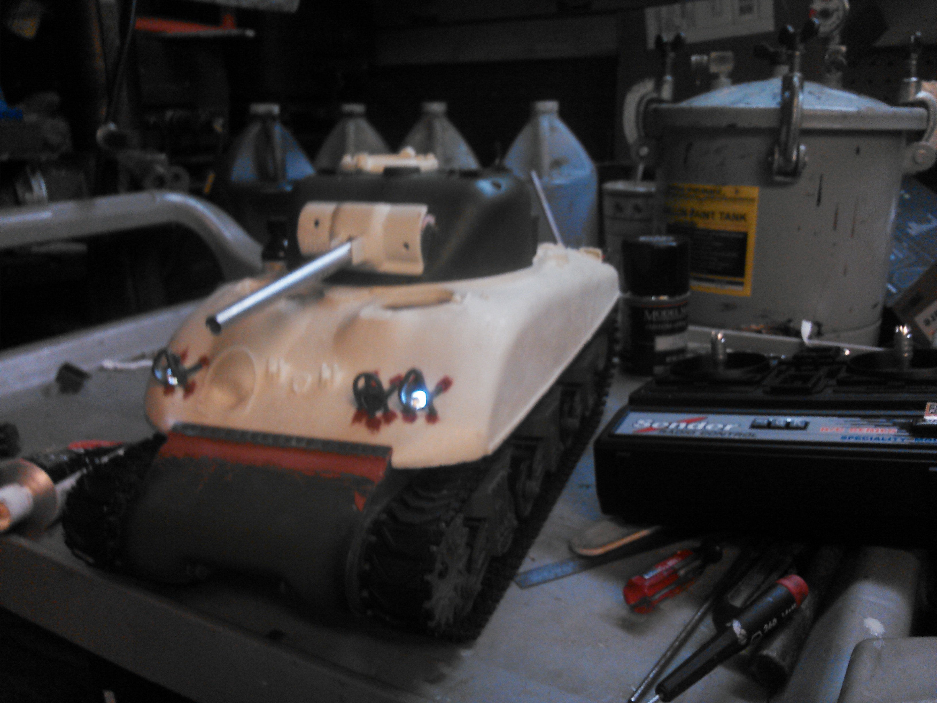

So I got the LEDs installed and soldered to the buss and then glued in the brush guards, accept for the rear, they don't fit right since they came off the flat rear of an A3 so I will make new brass ones this weekend.
I put it all together and fired it up. The lights all work and the turret rotates great.
Then I puttied some welds around the brush guards to fill in the holes they are mounted in.
http://www.rcuniverse.com/forum/atta...mentid=2081281http://www.rcuniverse.com/forum/atta...mentid=2081282

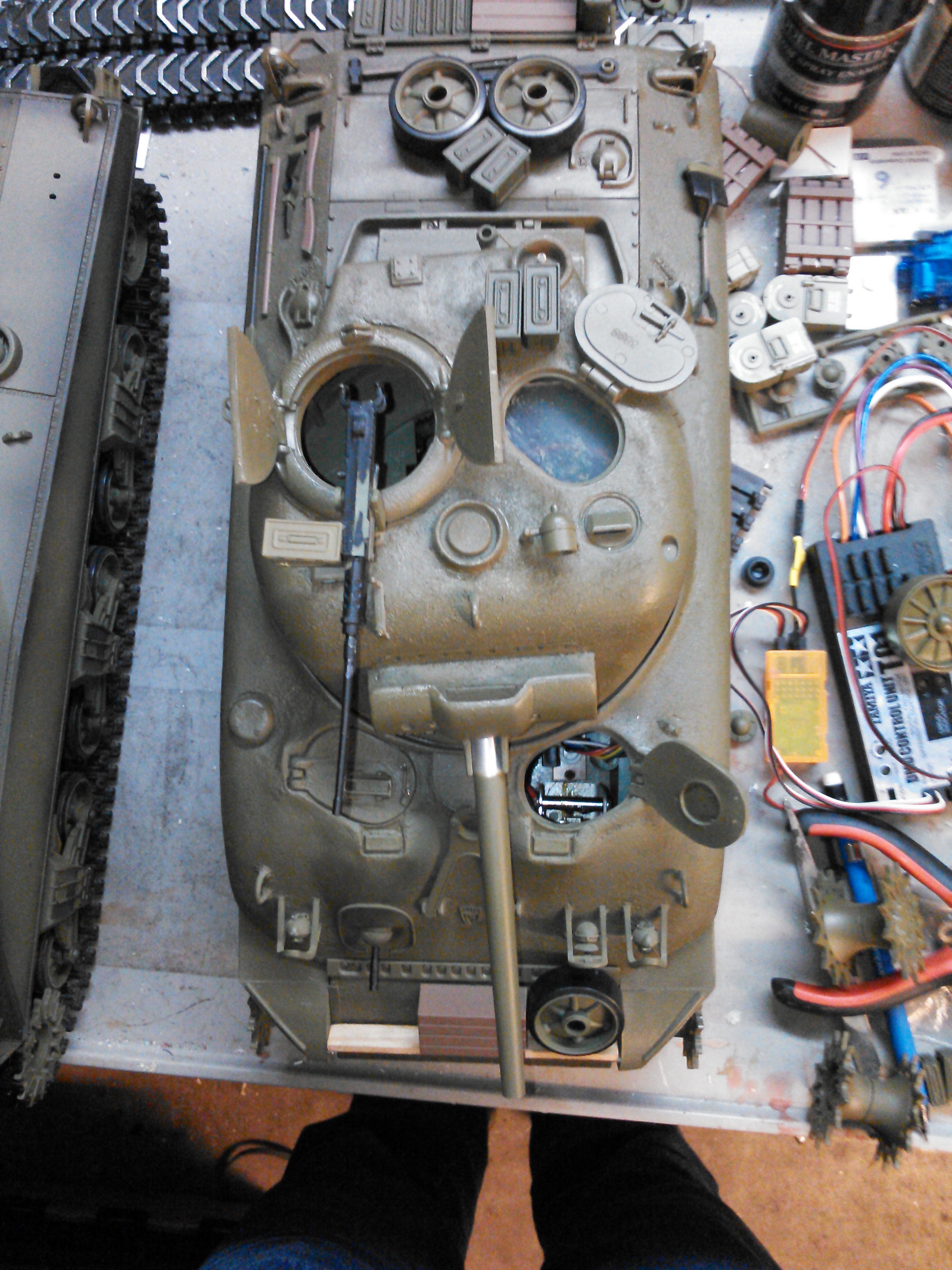

I got the hatches set up and hinged along with finishing the welding putty around the brush guards.
I also finished mounting the fenders. I cut grooves into them along with the hull and added dowels to help with strength and hopefully they wont break off.
Then I got ambitious and decided to try texturizing the transmission cover. I used Bondo brand spot glazing putty and tried several brushes. I found that the shortest brush, about 3/16 long and extremely stiff worked best. Its an artist oil painting brush (left overs from grandmas hobby)
The process took me a little bit to get down and I had to clean my brush in some laquer thinner every few minutes because the putty does begin to dry and clog up. I also was able to smooth out some areas I got too thick, by dabbing with a drop of thinner and spread it back out. Overall, I am very happy with the results. Its very durable when dry, I have rubbed it with my finger and it does not rub off or flatten down. I cant wait to get to the turret and then spray some paint on it!
