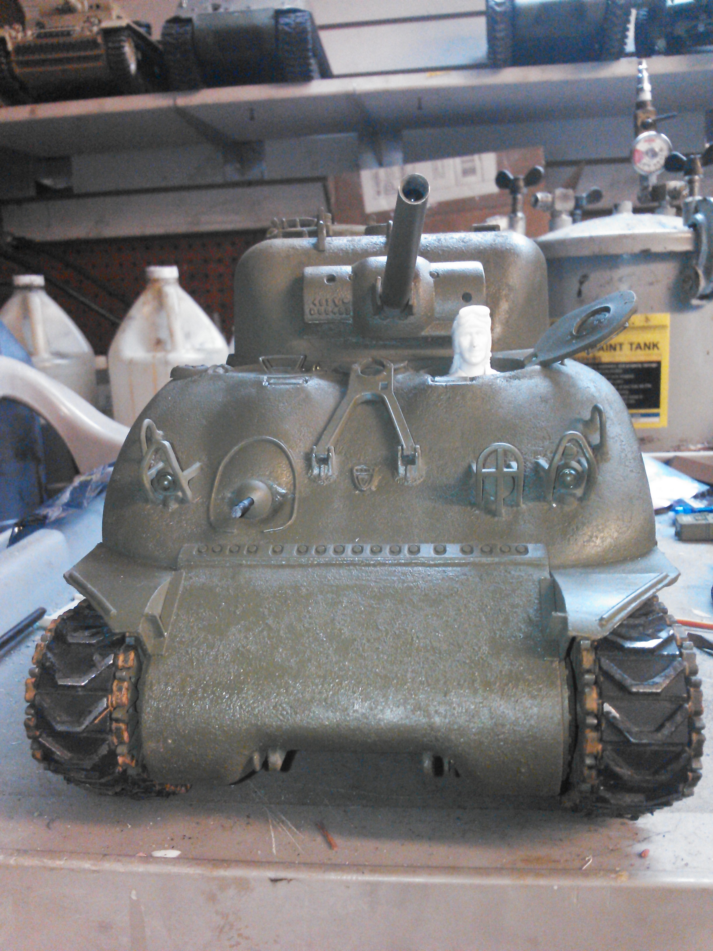

RichJohnson 04-03-2015 09:06 PM
6 Attachment(s)
Still working out the BARC4. Ive got some throttle glitch coming out that makes the idle sound pop and start throttle up sound and back to idle, when the motors are idle and not moving and the stick is centered. Not sure what is going on with this. I thought it was from the ratchet stick but switched to the self centering spring stick and it still sound glitches, though not as much.
Any way, a few photos overall with my driver siting in the tank, He has to be sat in place by lifting the body because his shoulders are too wide to drop through the hatch. He sits right on top of the relocated on off switch. He, and my other figures are made by Sol model of Korea.
http://www.rcuniverse.com/forum/atta...mentid=2086216http://www.rcuniverse.com/forum/atta...mentid=2086217http://www.rcuniverse.com/forum/atta...mentid=2086218
TOOLS, I painted weathered and mounted the tools. Lighting aint so great but you get the idea.

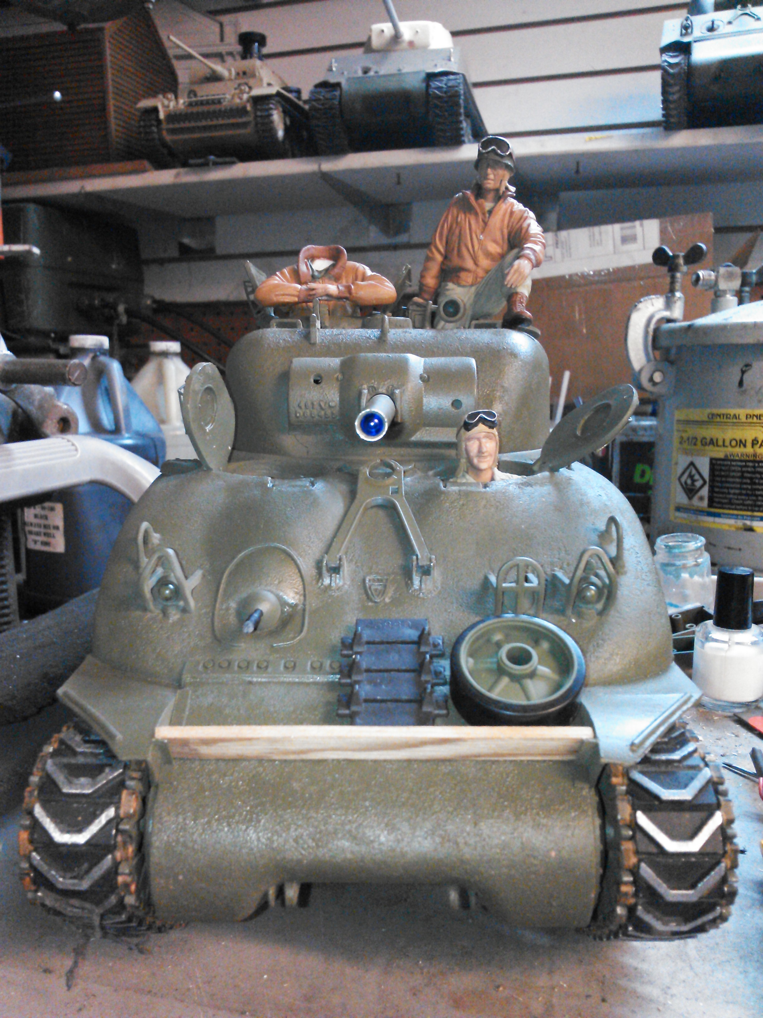

3 Attachment(s)
I did some driving and testing today. The tank drives pretty nice. Overall the BARC4 does what its supposed to and it will stay in this tank, possibly forever. Mainly because the mating IR receiver base is semi permenantly mounted in the turret. I can modify turret operations if I get another radio and move elevation off onto a separate channel. If I can find a radio with a toggle on top that goes both directions with the servo (unlike my dx5 which only does landing gear one direction) then I can run my continuous servo elevation with that single pole double throw toggle, hopefully I can make it momentary too.
So I started working on my crew. I haven't painted a military figure since I was maybe 14 or so. Been a long time. The figures aren't completely assembled yet since some parts cant go on till they are painted as they would interfere with painting.
