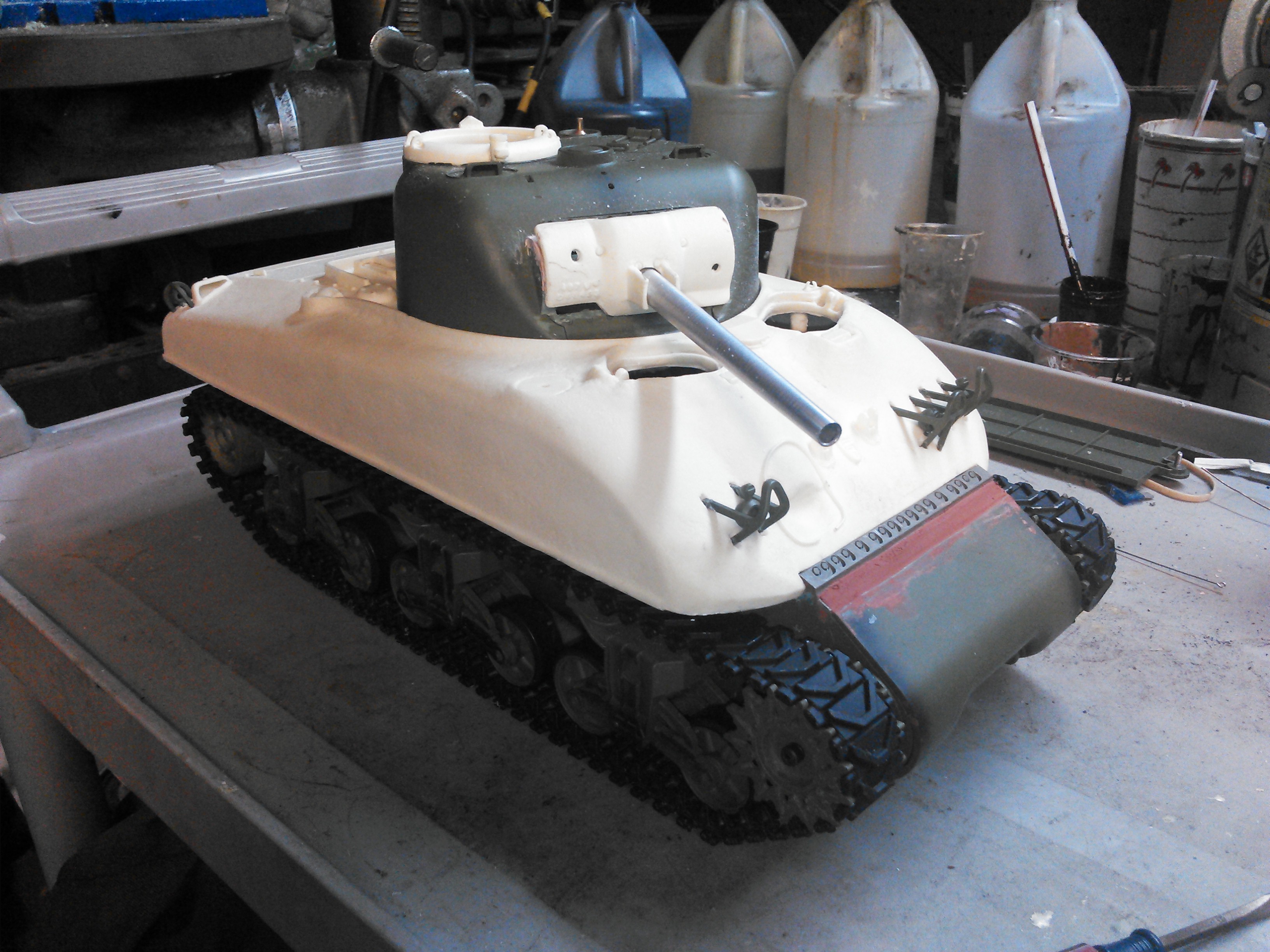

I just finished up a power jam build session tonight. Went too late on it but when the mood is right you have to strike.
Last night I started by tearing apart a new HL metal upgrade M4A3 105 which I was simply going to convert to a 75W with a hobby radio, BARC3 IR and maybe recoil.
Ugh, here is where I went tonight.
Urethane parts by Nick Aguilar. I am going to machine off the vision coupola and install an early split hatch. Also what you cant see is I leveled off the rear vent from the top of the bustle that only the 105 Howitzer model had. I will fill the hole with a blank out and putty it over maybe tomorrow.
Needed something to build while waiting for parts for Katy Cat, my EZ8 build, and not quite ready to build the 75 mount for the Half Track TD yet..

Is that bondo holding the brass tube in place? Bondo is one of the tools in my bag of tricks. It is easy to shape as it hardens.

Yes it is bondo. Bondo is a great filler adhesive. I glued the barrel tube to the mantle and then began fitting it against the tilt mech on the HL turret. I had to oblong the hole in that part lower to get the mantle to line up on the turret, then I tacked it with CA let it dry, and filled the square cavity with bondo. I need it very strong, I have a baby that will probably get his hands on it.

I have decided i cant stand the look of the mount for the gun, the mantle sticks off the casting on the turret way to far forward. In comparison of photos, the mantle should sit about half as close to the turret face. The curve of the casting gun mount should be much more shallow and gentle. Im going to take my new gun mount apart and file down the high curved castings of the 105 mount.
Just look hard at my middle photo in first post. Then go look at a 75 sherman photo broadside on google and my model will hurt your eyes.

The 75mm should also sit a little higher in the turret than the 105 as well.
(altho I must admit that I left the pivot point where it was and just ground back the front like you have)

Another alternative is to buy the 75mm turret parts from the MATOMART Sherman parts page. I plan to do the same for some of my 75mms that have elevation issues. Many moons ago we cast some rotor shields and mantlets to do the conversion but I want to try the new stuff ASAP.

The HL turret is much smaller at the barbette than the Tamiya that Nick made his casting for, so the hole for the turret was huge. I coated the turret ring with lots mold relase along with the rotation gear and used bondo and built a barbette ring for the turret to rotate in. The turret rotates pretty well but is a tad sticky still in one spot so some more trim fitting or sanding is needed to get a nice clean guiding rotation. I have shim stock and plexiglass filled in the cavity of the under side of the engine vent where the rotation motor will mount, I have already test fit it there just need to drill screw holes.
The process of building up the bondo barbette was first I used just the turret and filled around it with bondo, then trimmed it for a good fit and smooth rotation. Then I screwed the gear onto the turret and pushed bondo between the new bondo barbette ring and the gear ring and built it up sold. Then removed the gear and trimmed down where it cast into the teeth.
