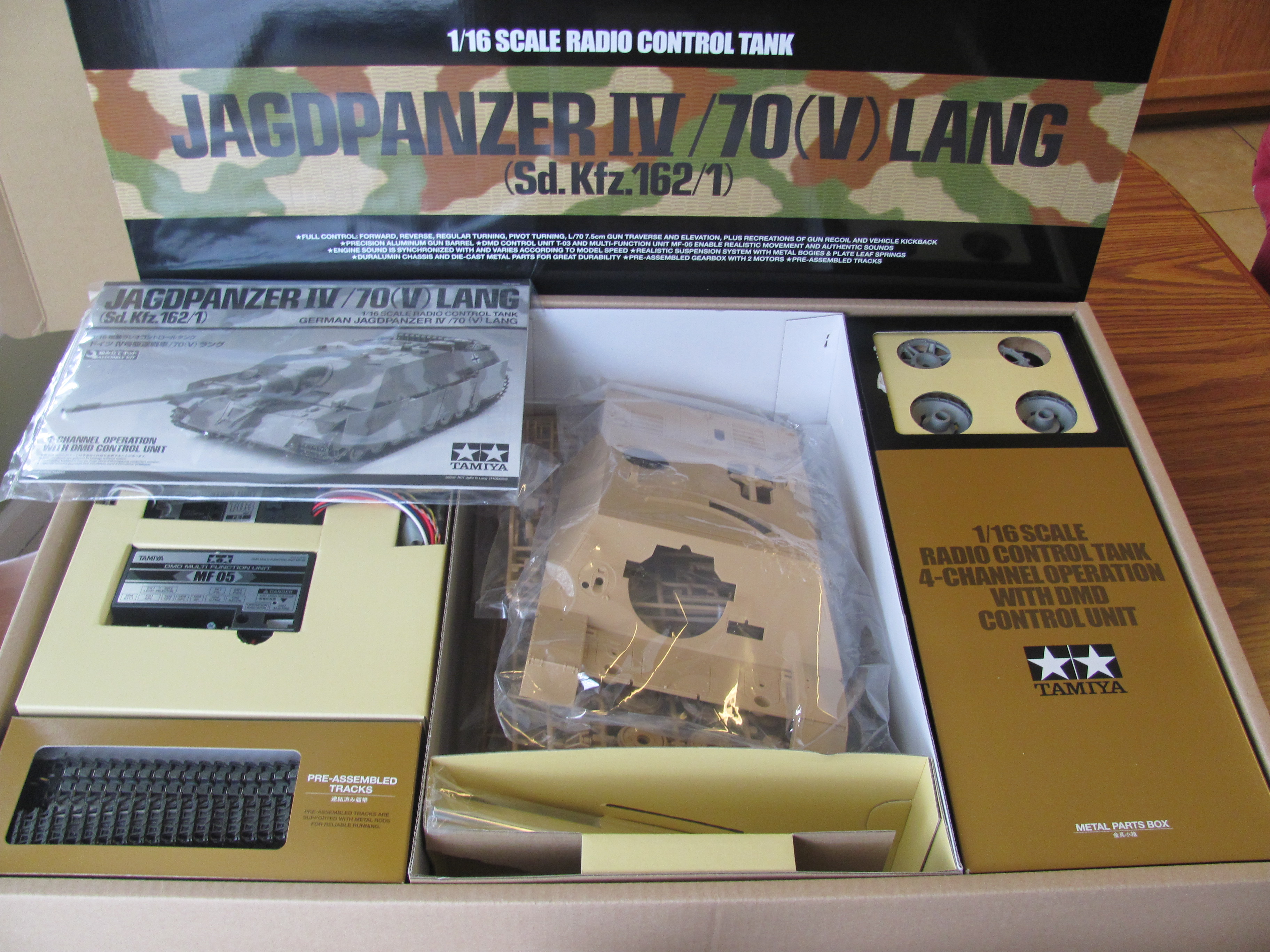

manchu9inf 08-01-2016 01:20 PM
Tamiya JagdPanzer IV
5 Attachment(s)
Was delivered today!!

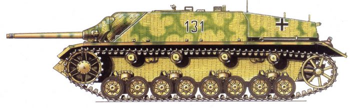

it may be this version with Zimm. Will have to decide!
http://www.rcuniverse.com/forum/atta...mentid=2175433
or maybe something like this with Zimm
http://www.rcuniverse.com/forum/atta...mentid=2175434

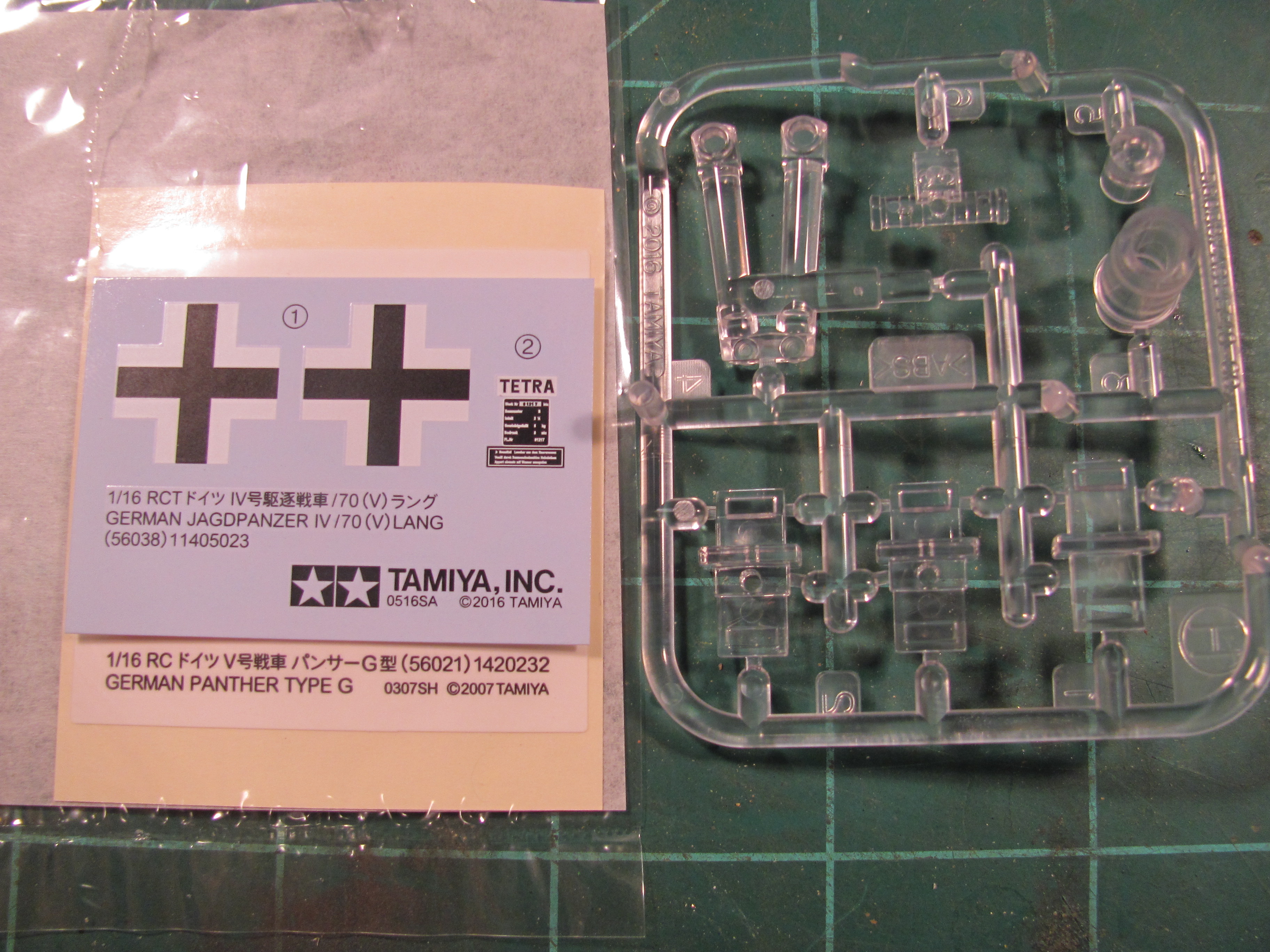

manchu9inf 08-02-2016 07:31 PM
1 Attachment(s)
here is a pic of the decal sheet and the clear parts for the periscopes. pretty cool there is a decal for the fire extinguisher!

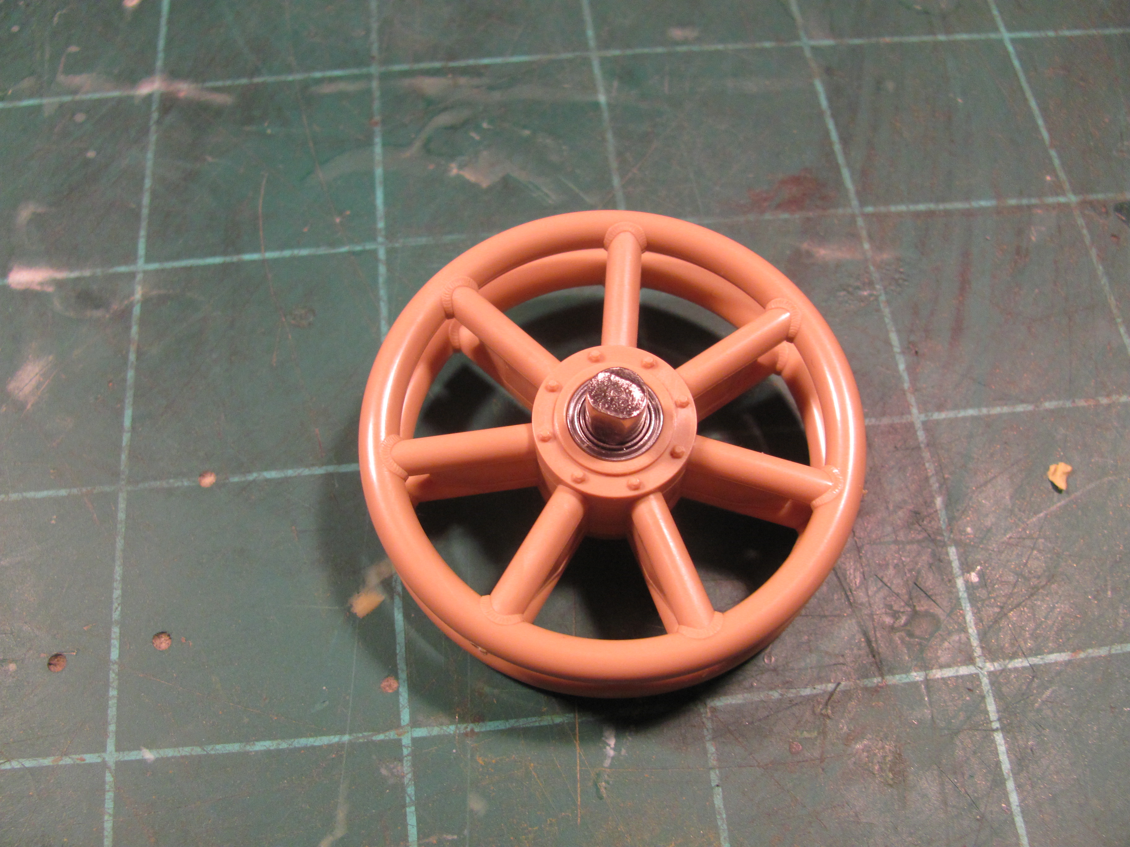

JP4 Idler
3 Attachment(s)
Good news, the rear idler will take bearings. While it is plastic, i think it will work well even with metal tracks.
http://www.rcuniverse.com/forum/atta...mentid=2175672http://www.rcuniverse.com/forum/atta...mentid=2175673http://www.rcuniverse.com/forum/atta...mentid=2175674
philipat 08-04-2016 03:04 PM
Does it come with those bearings or did you have to get them separately?
manchu9inf 08-04-2016 03:07 PM
I had the bearings, the kit comes with bushings. those are the bearings that fit the sherman, i dont have the size off the top of my head.

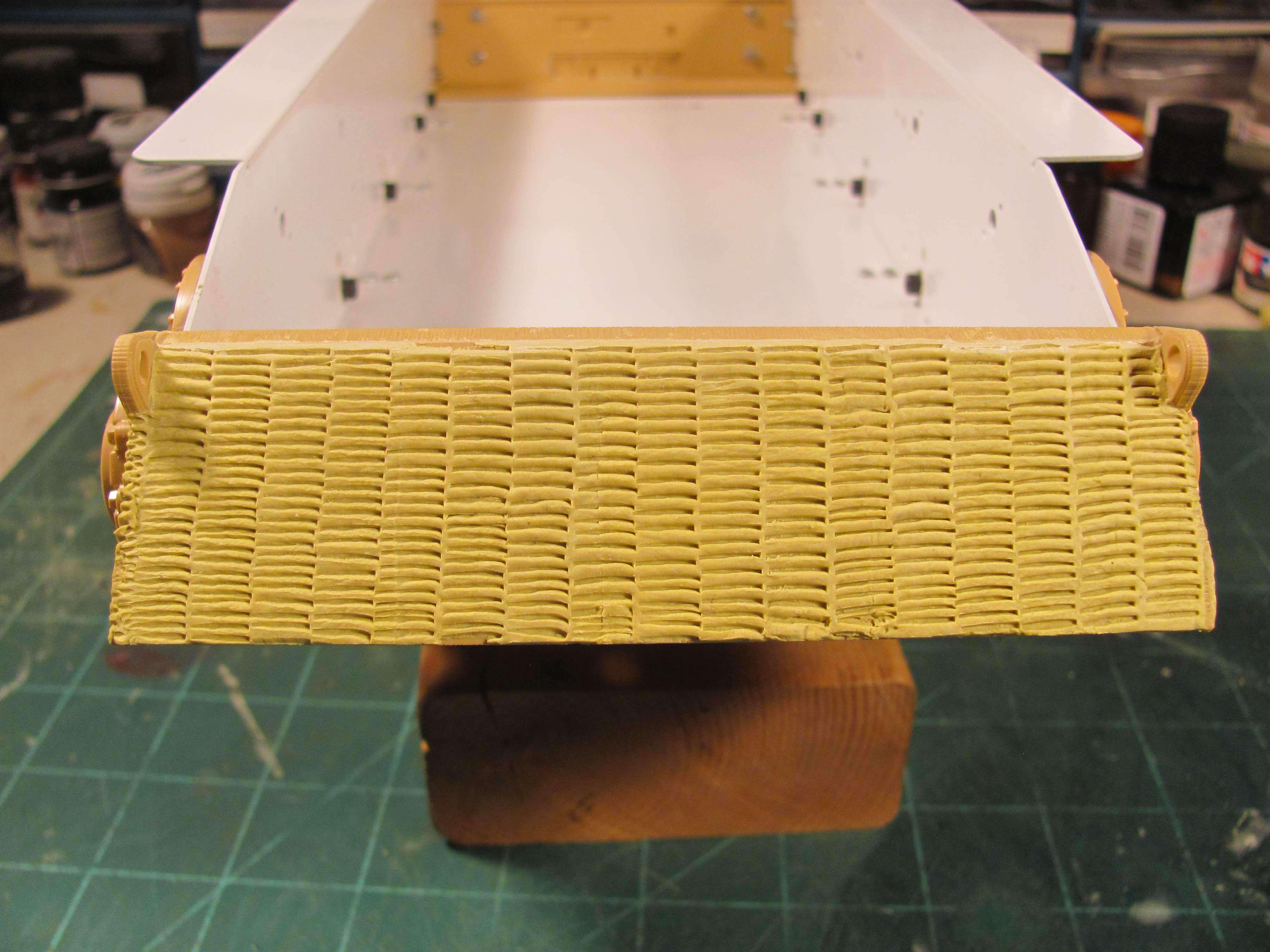

manchu9inf 08-04-2016 07:54 PM
2 Attachment(s)
Well, the rear hull plate is just about done, the zimmerit is on it, stock bolts replaced with hex head bolts, tow hitch drilled out and pin installed. the muffler is not glued in place as it will need to get painted and weathered separately. Currently working on applying zimm to the front glacis plate.
,http://www.rcuniverse.com/forum/atta...mentid=2175833http://www.rcuniverse.com/forum/atta...mentid=2175834

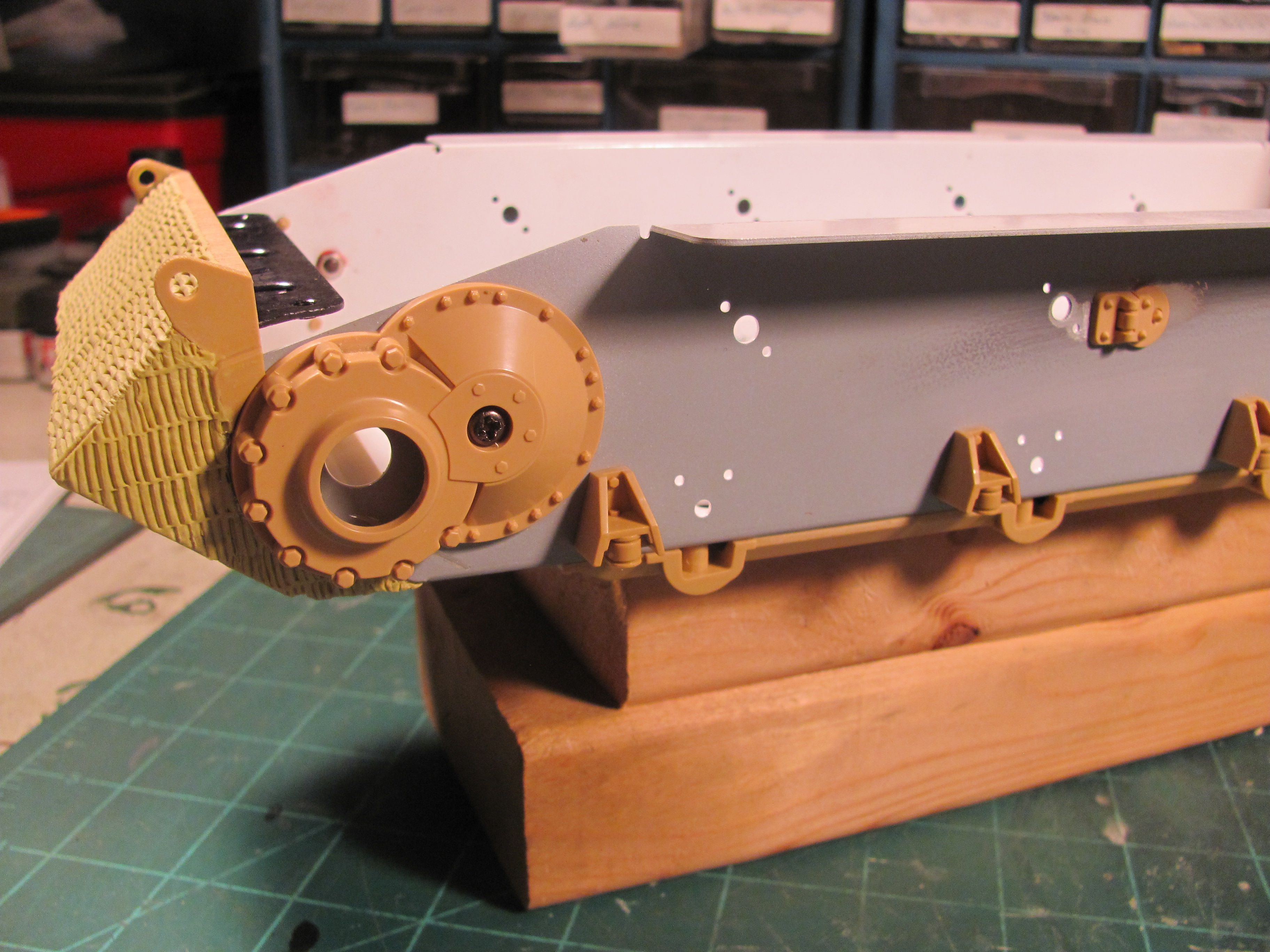

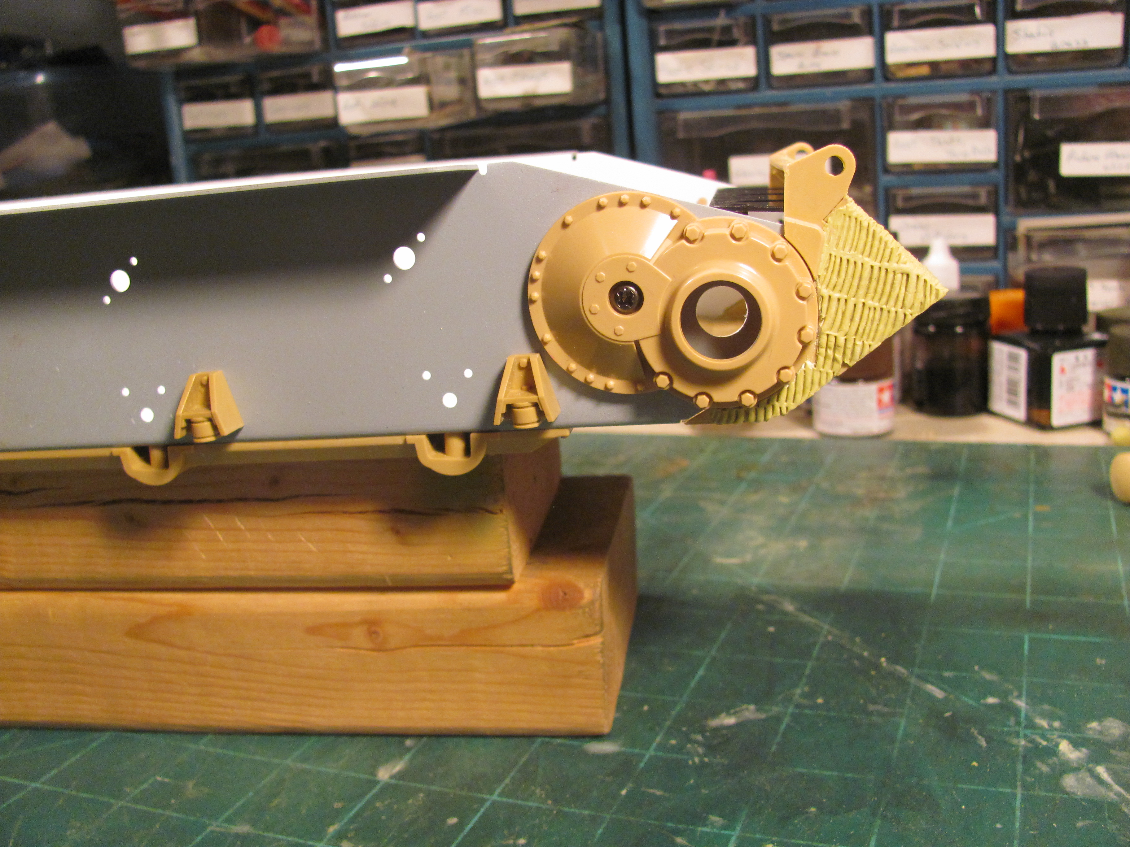

manchu9inf 08-05-2016 09:01 PM
3 Attachment(s)
Some work was done on the lower hull, the zimmerit is looking pretty good,just need to the weather to cooperate and get some more primer on the suspension parts.
Gary, there are other version you can do without the zimmerit, this is going to be an earlier version with the shorter 75mm L48 gun built before AUG 44. if you are wanting to build the version with the long barrel L70 gun you can easily build it without the zimmerit.
http://www.rcuniverse.com/forum/atta...mentid=2175913http://www.rcuniverse.com/forum/atta...mentid=2175914http://www.rcuniverse.com/forum/atta...mentid=2175915
