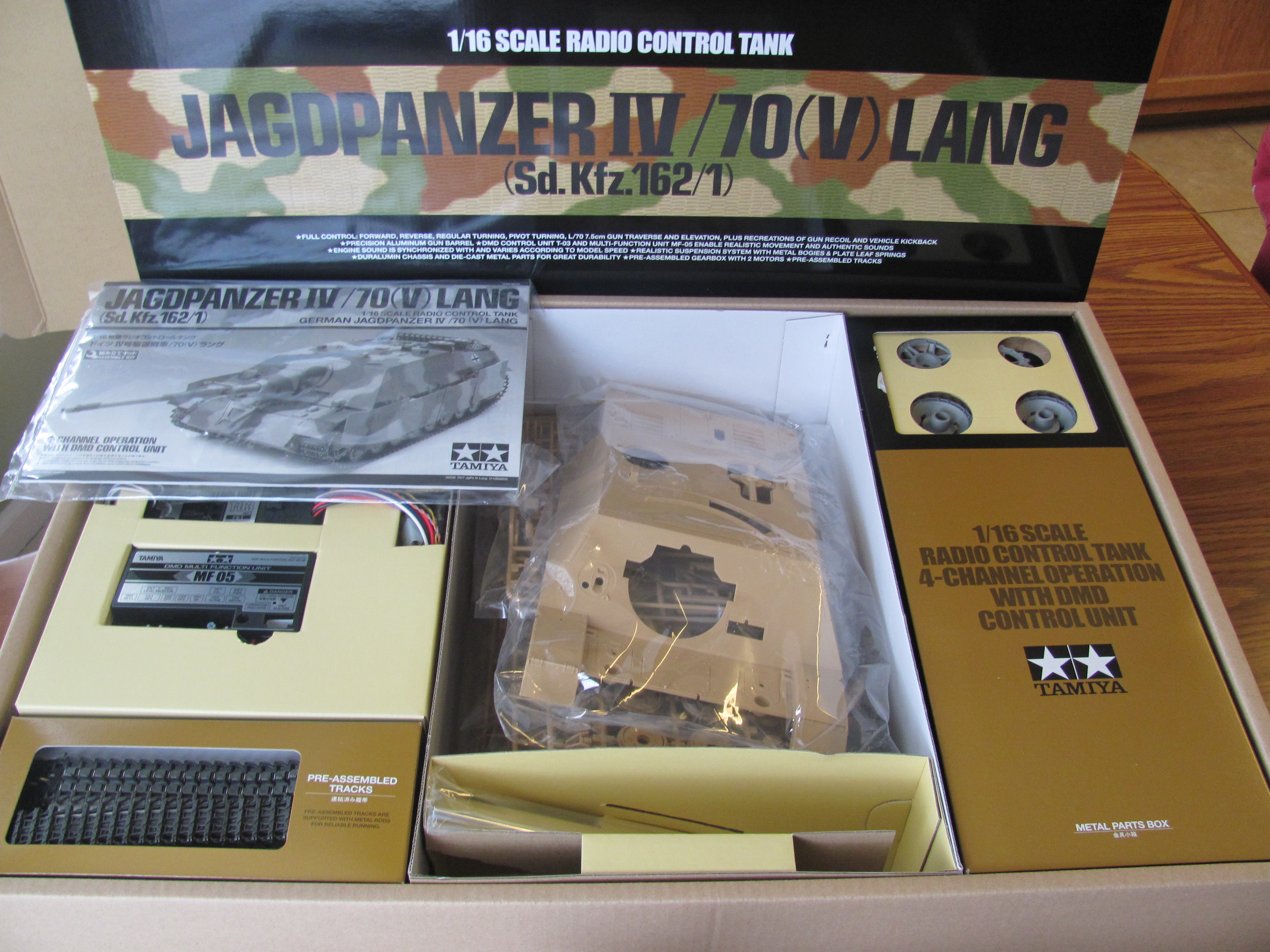

Was delivered today!!
it may be this version with Zimm. Will have to decide!
or maybe something like this with Zimm

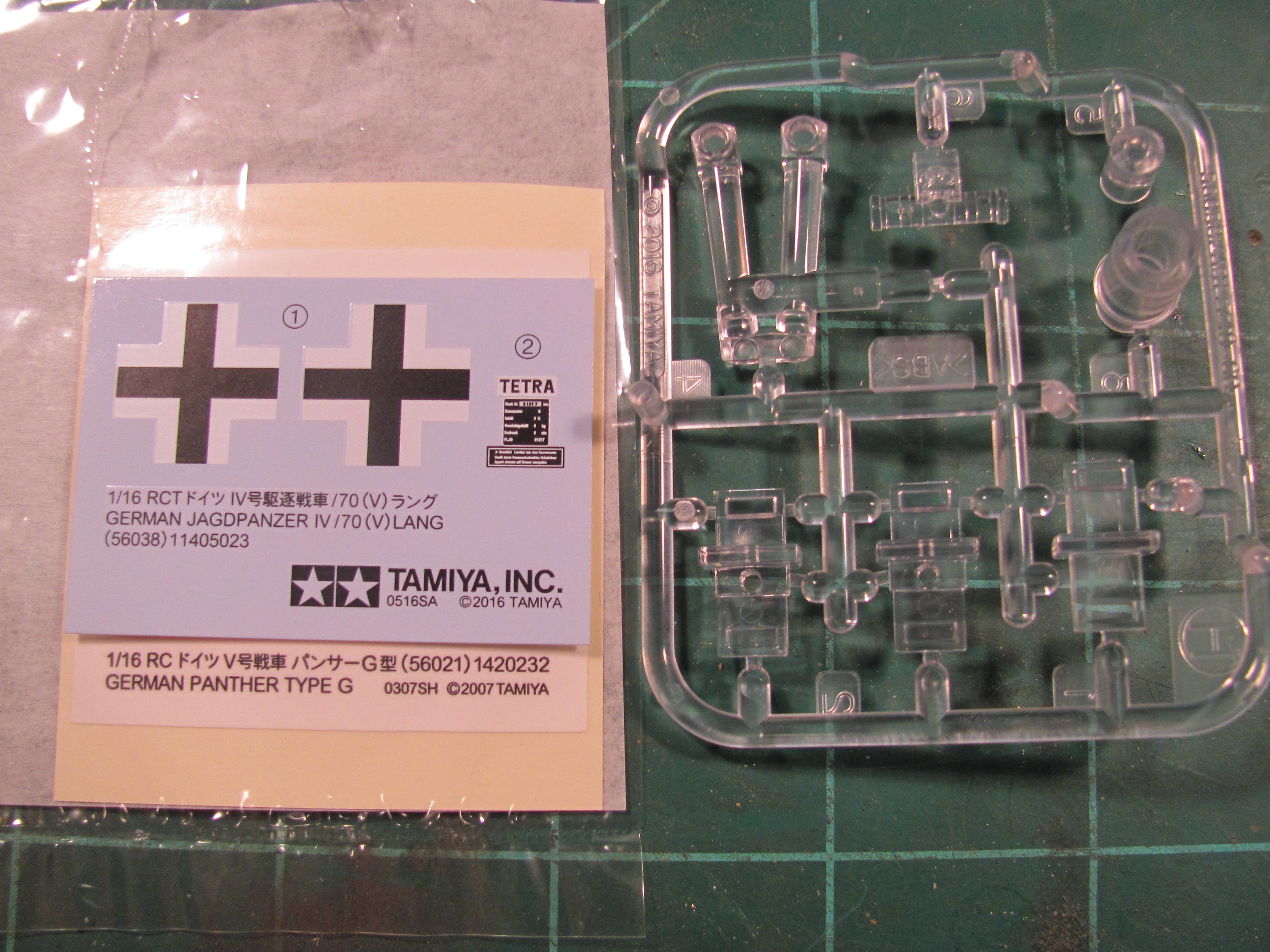

here is a pic of the decal sheet and the clear parts for the periscopes. pretty cool there is a decal for the fire extinguisher!

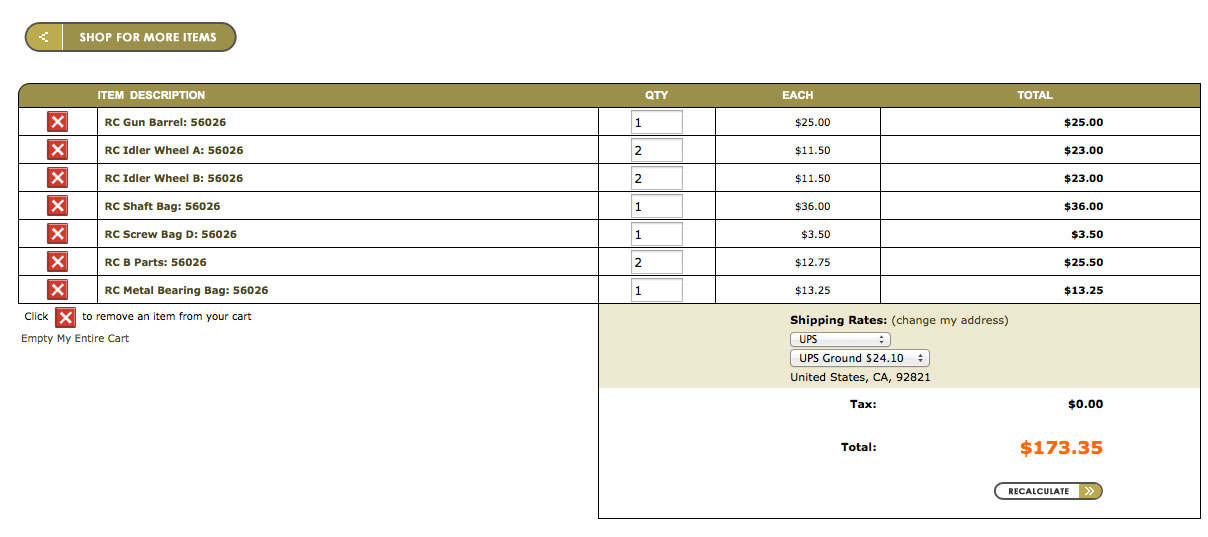

Really nice detail photos! Thank you for the tip for the L48 barrel and muzzle brake (one metal barrel plus the RC B Parts, need
2 B Parts plastic trees to make one muzzle brake).
AAF Museum has the parts, just checked and see the parts list below, for anyone else interested. Think I will keep the L70 gun though and center up two return rollers and delete the 4th rollers, because the late Lang's only had 3 return rollers on each side. Thus, I can then eliminate having to do Zimmerit and have an Ardennes Offensive Lang in ambush camouflage.
Another question, are the Tamiya Pz4J metal idlers similar or look close enough to the Lang's plastic idlers? I included the Tamiya Pz4 idler parts set in the parts list below, A & B wheel set, axle shafts bag, bushing bag and idler assembly screws, in case they might work?
Should have my kit Friday, hoorah!

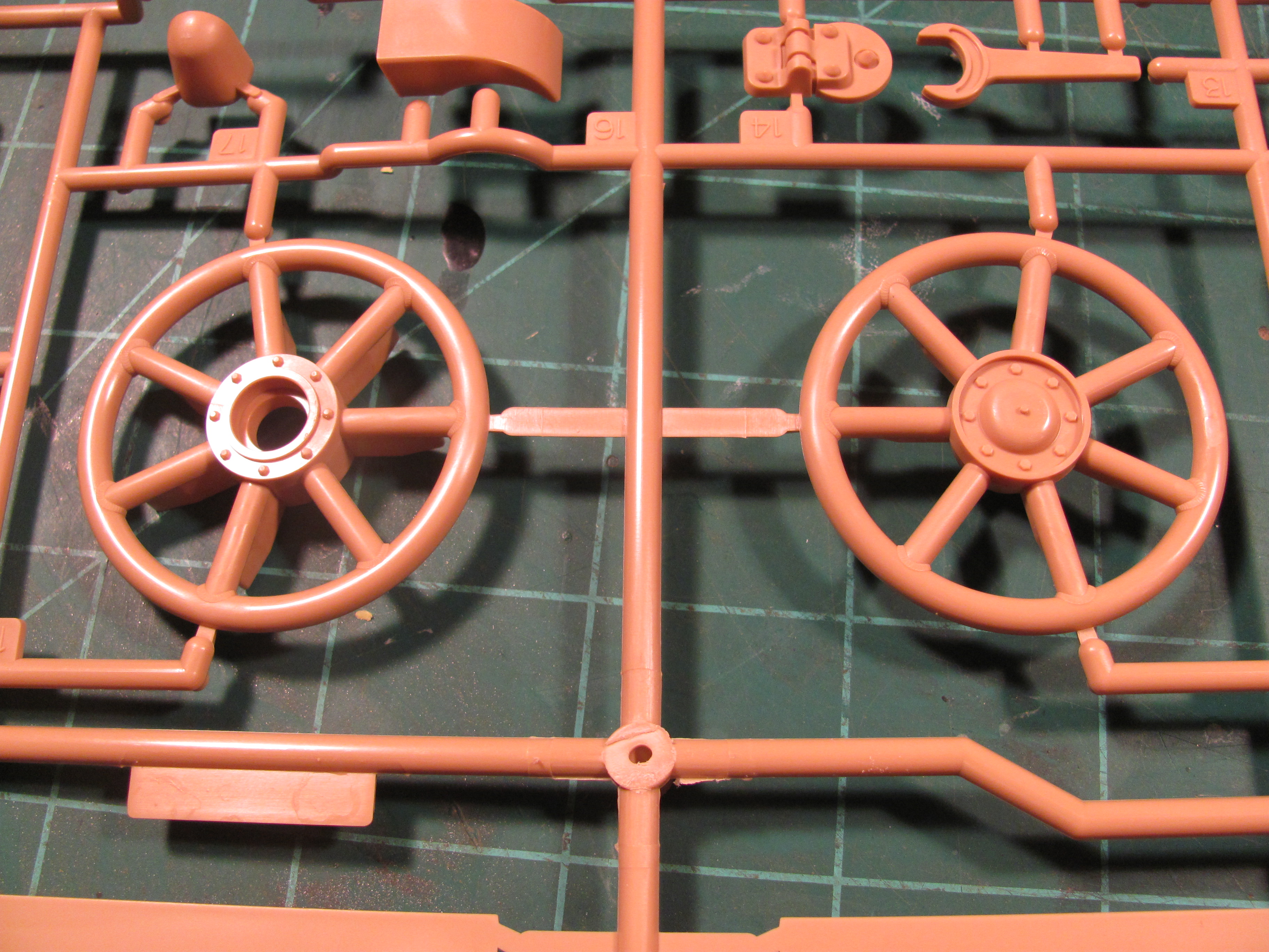

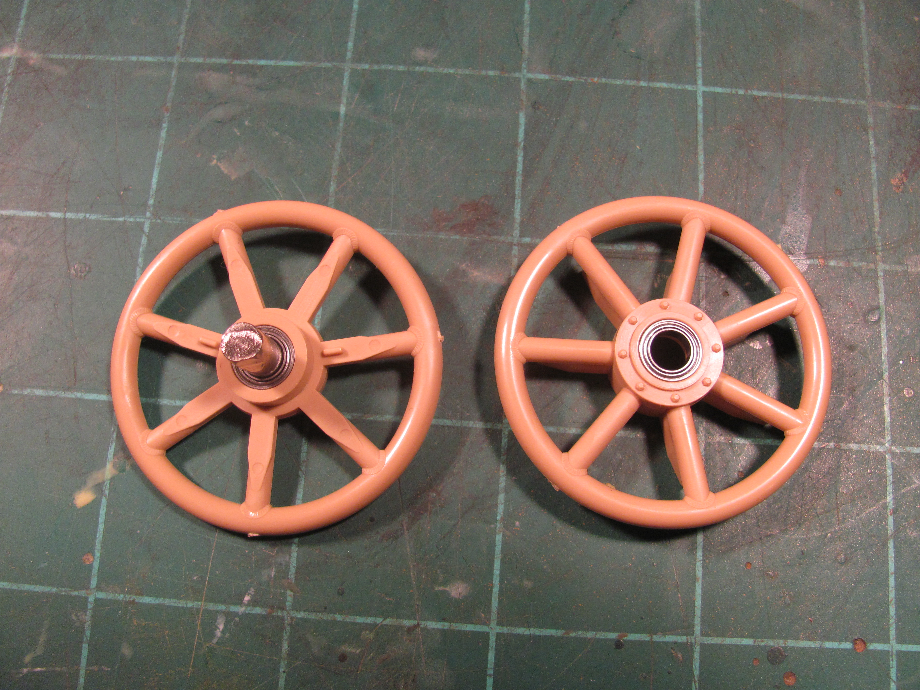

Default JP4 Idler
Good news, the rear idler will take bearings. While it is plastic, i think it will work well even with metal tracks.

Does it come with those bearings or did you have to get them separately?
Old 08-04-2016 | 03:07 PM
Joined: Mar 2009
Posts: 687
Received 13 Likes on 12 Posts
From: Lone Jack, MO
I had the bearings, the kit comes with bushings. those are the bearings that fit the sherman, i dont have the size off the top of my head.

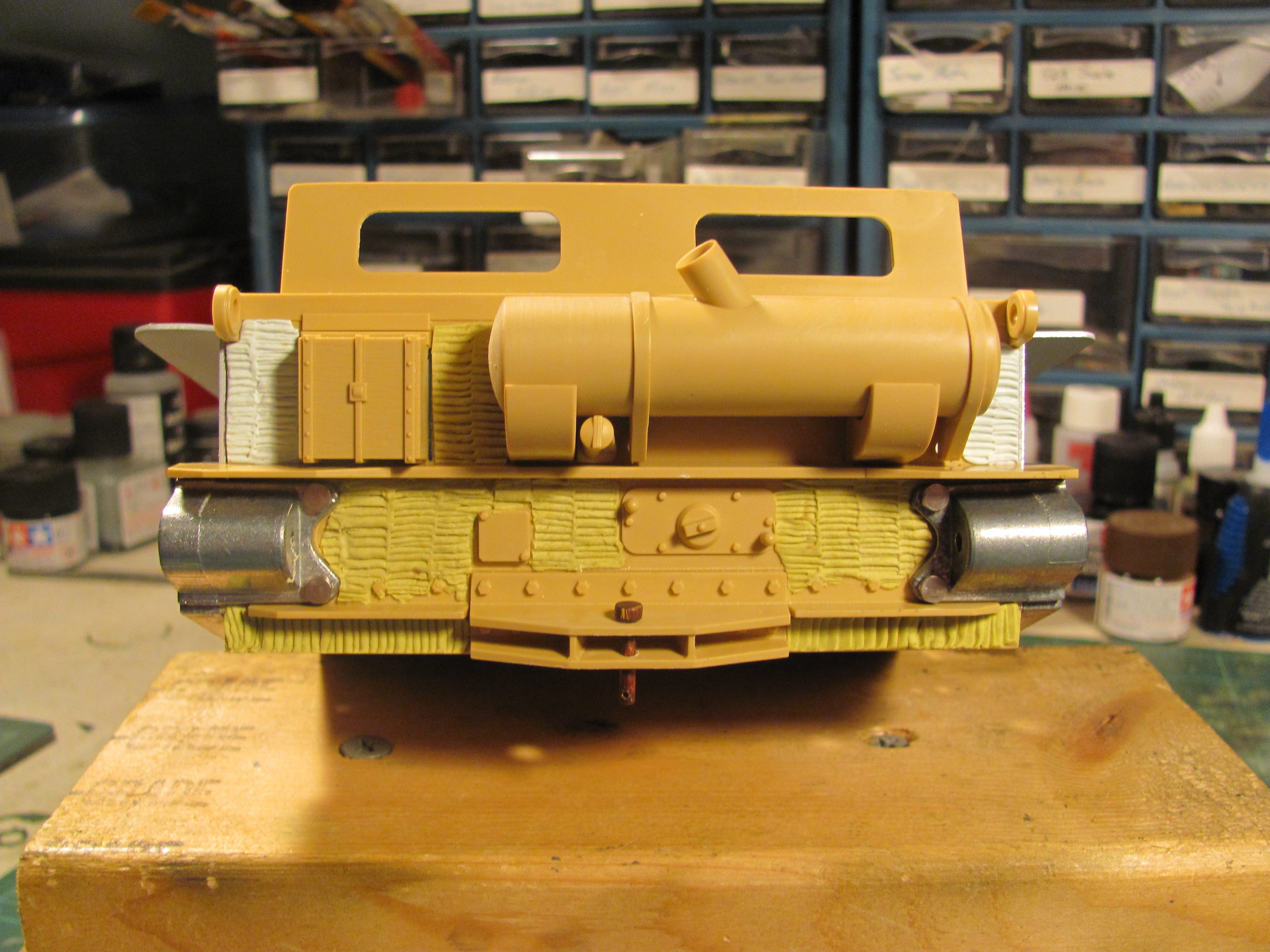

Well, the rear hull plate is just about done, the zimmerit is on it, stock bolts replaced with hex head bolts, tow hitch drilled out and pin installed. the muffler is not glued in place as it will need to get painted and weathered separately. Currently working on applying zimm to the front glacis plate.

Right on, will be interested in seeing how the plastic idlers handle the metal tracks after a few battle weekends.

i think they are going to hold up, you can't get super tight tension on the panzer IV chassis which shouldn't put a lot of strain on them and with bearings mounted they spin very easily, and finally the metal Panzer IV tracks aren't heavy. My bet is they will hold up fine.

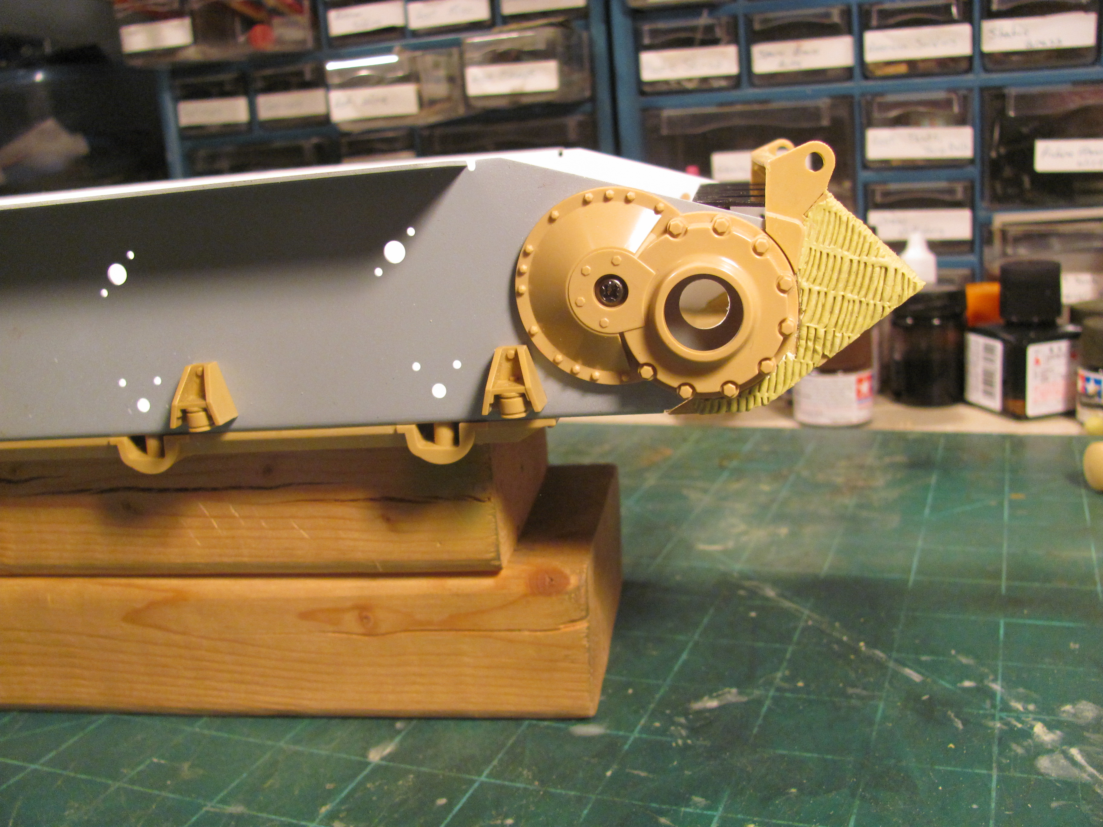

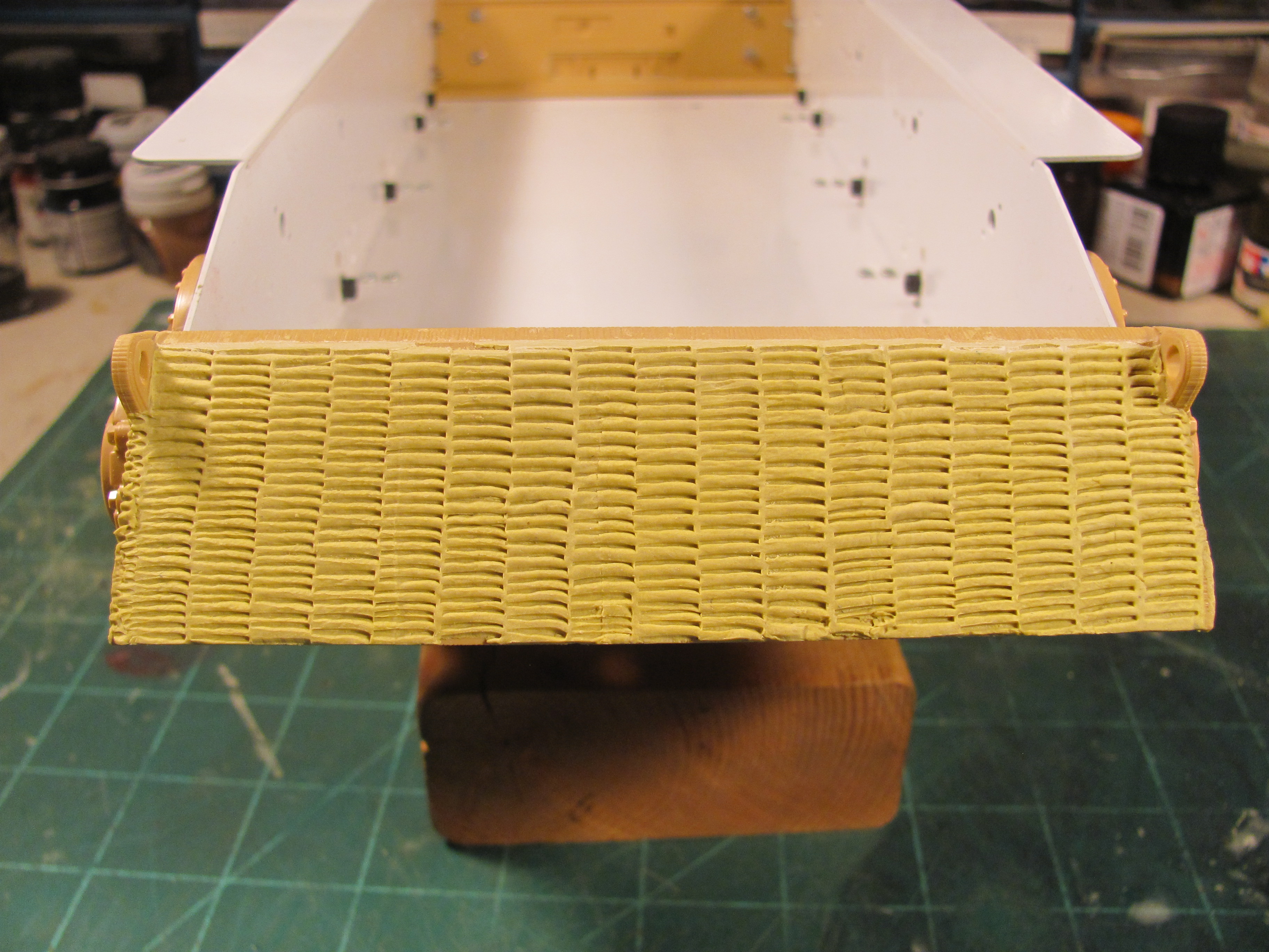

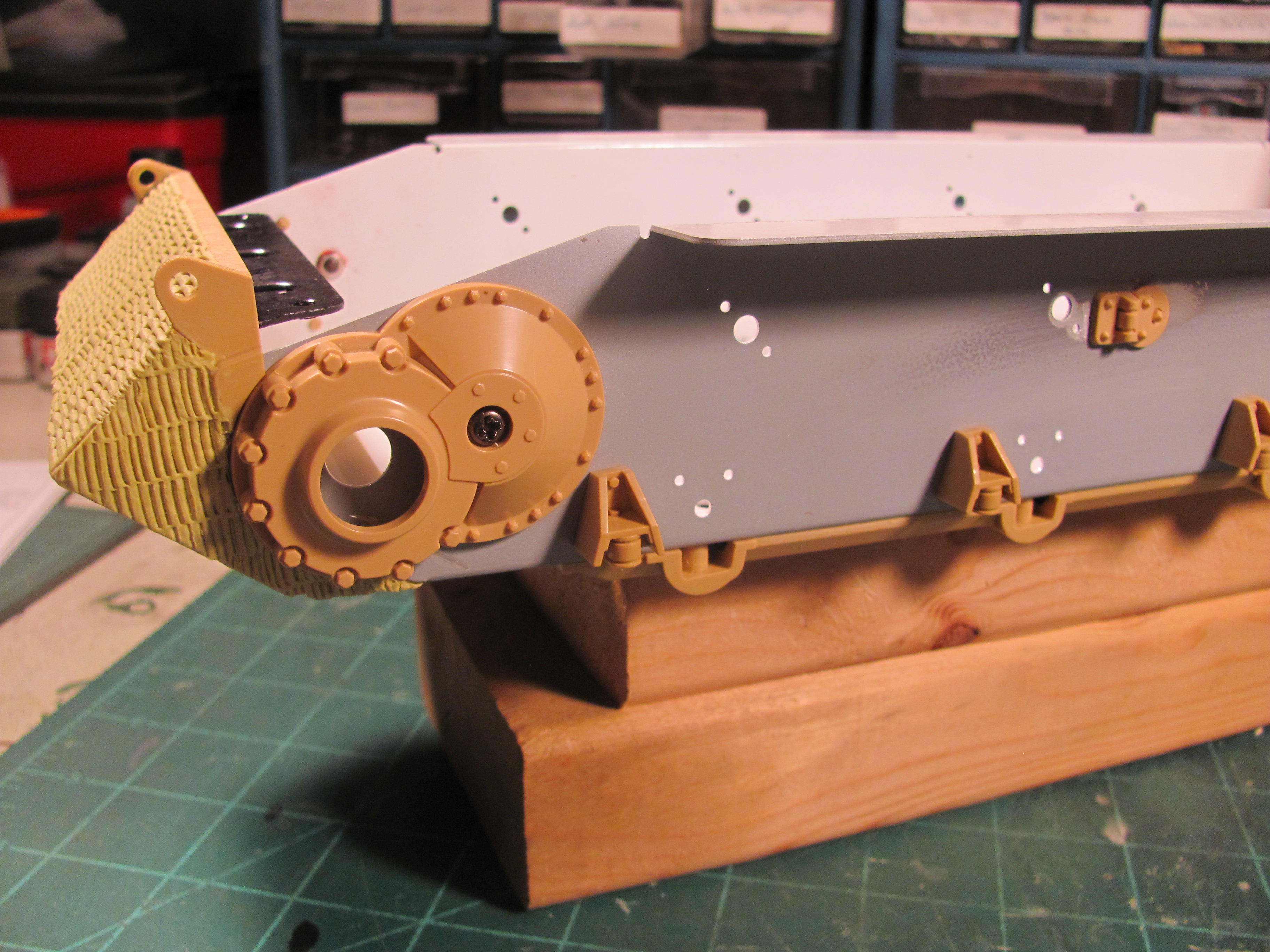

Some work was done on the lower hull, the zimmerit is looking pretty good,just need to the weather to cooperate and get some more primer on the suspension parts.
Gary, there are other version you can do without the zimmerit, this is going to be an earlier version with the shorter 75mm L48 gun built before AUG 44. if you are wanting to build the version with the long barrel L70 gun you can easily build it without the zimmerit.
