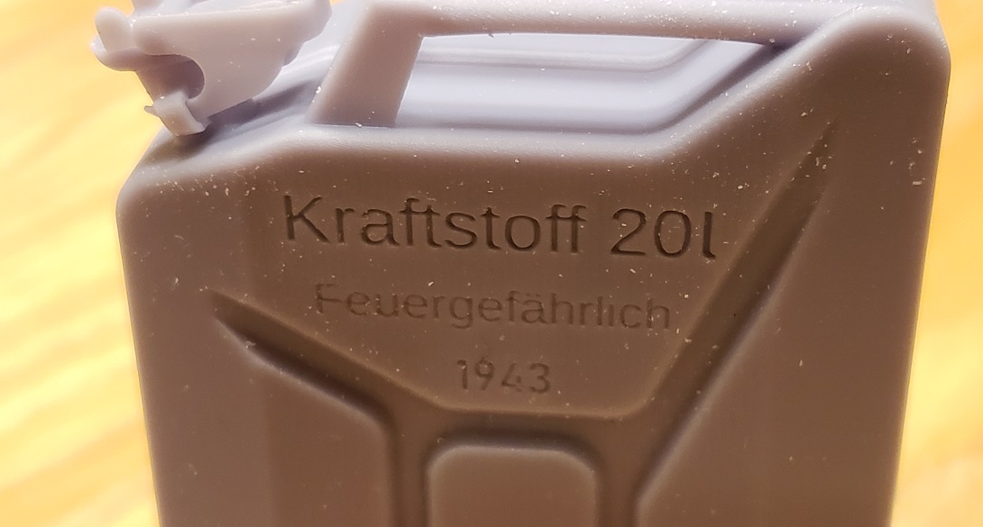

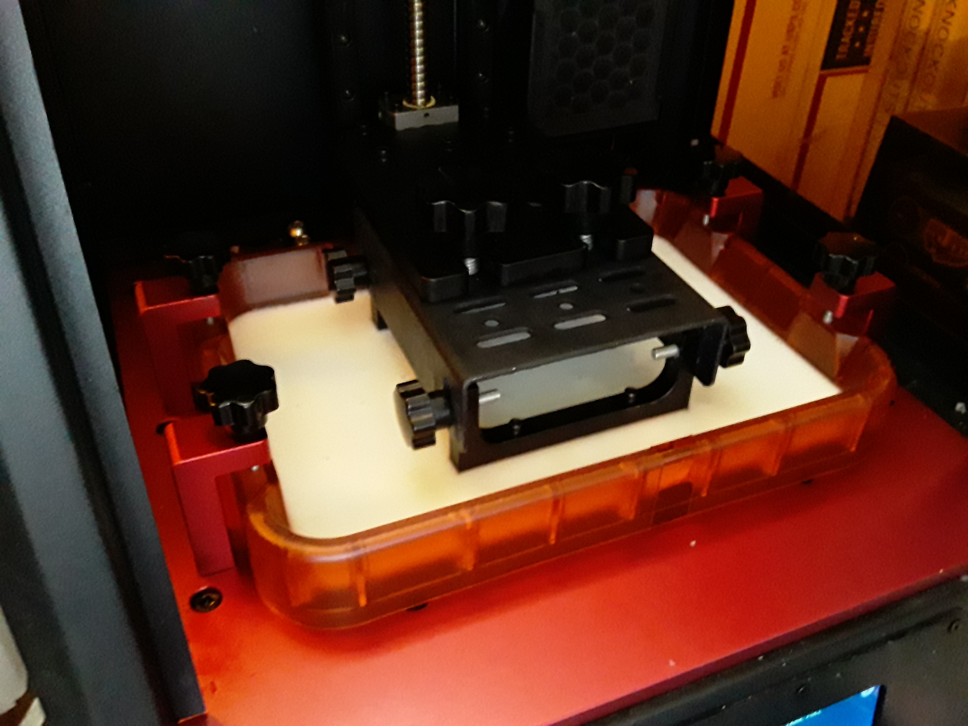

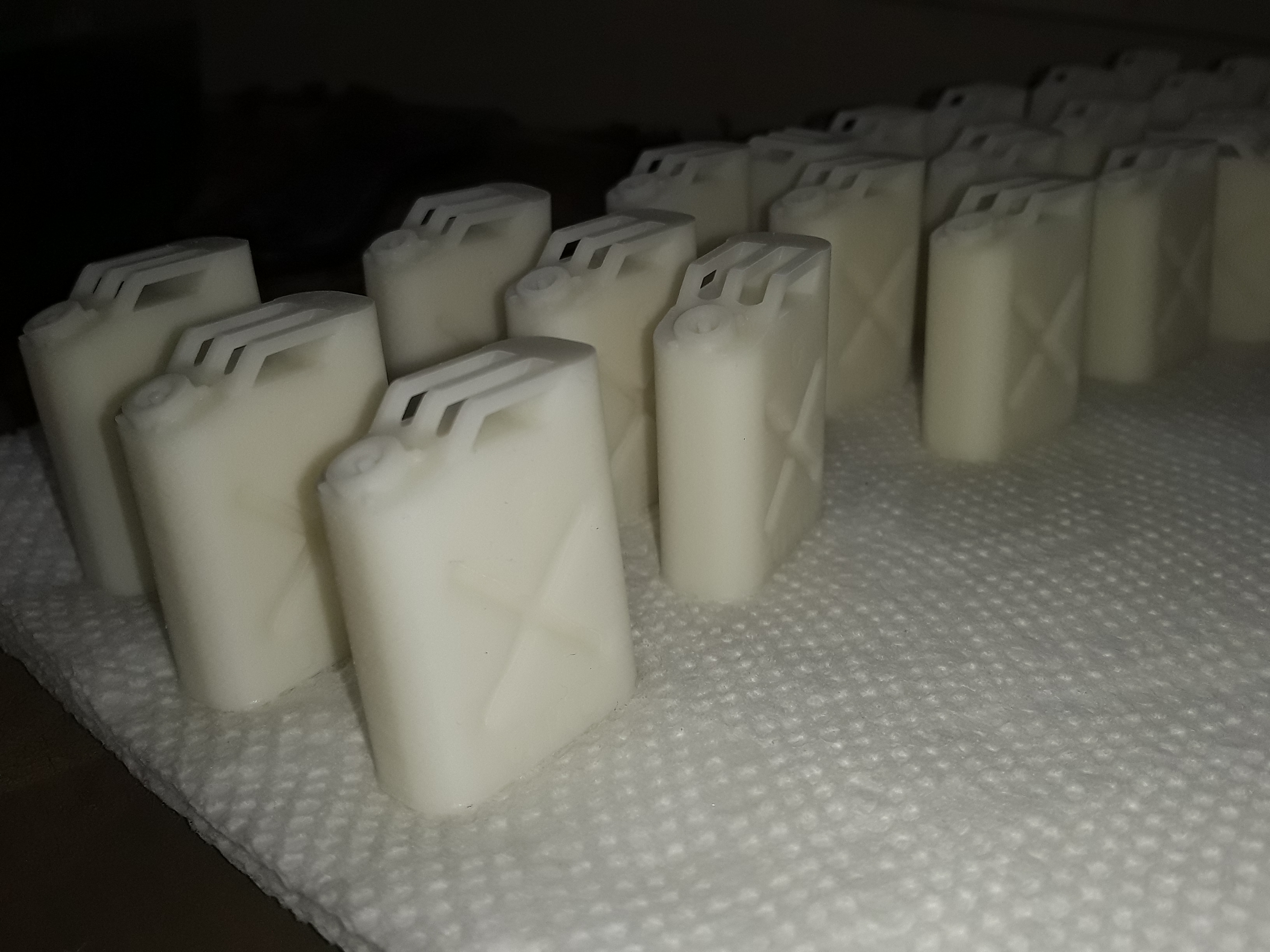

It's been a while since I posted here, but I've recently made some real progress. First, the chitubox software is much, much better now and much easier to use. Also, I learned a few things along the way that helped, like the fact that I had a bad resin tank and it would leak a small amount of resin in between the bottom of the tank and the screen, and that caused all kinds of trouble. That's fixed now so life is easier, and another thing that's made a HUGE difference is water-washable resin. I can't tell you how much this stuff improves the experience for me. Now, instead of using all that simple green and rubbing alcohol I just take the whole print bed to a pan in the kitchen sink and spray it with the sprayer attachment thingie and it's a piece of pie. I use the pan to catch waste water, which I dispose of properly instead of letting it wash down the drain. The print quality is light years ahead of my creality cr10, though that's still a great piece of kit and it's running as I write this. Printing an M3 scout car that should make Rich Johnson drool. :p
It's especially good with small detail stuff like dash panels, windshield wipers and jerry cans.
Attachment 2268241
Attachment 2268242

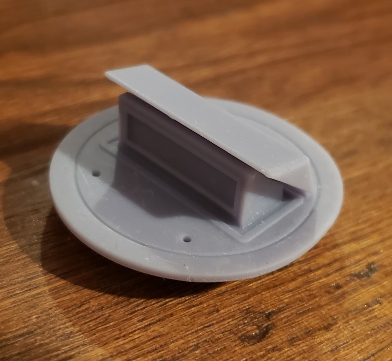

hare's the dash panel (M3 Scout Car), and something else that came out really well, windshield wipers. One of those small details that can really add something to a good truck model. I've sent a pair of sample wipers to Shaun so we'll see how he likes them. And if anyone wants or needs any of the stuff I'm printing you should PM me, as I don't want anyone to think I'm advertising. I'll help my buddies get cool stuff, but I ain't trying to make a fortune or anything.
Attachment 2268243

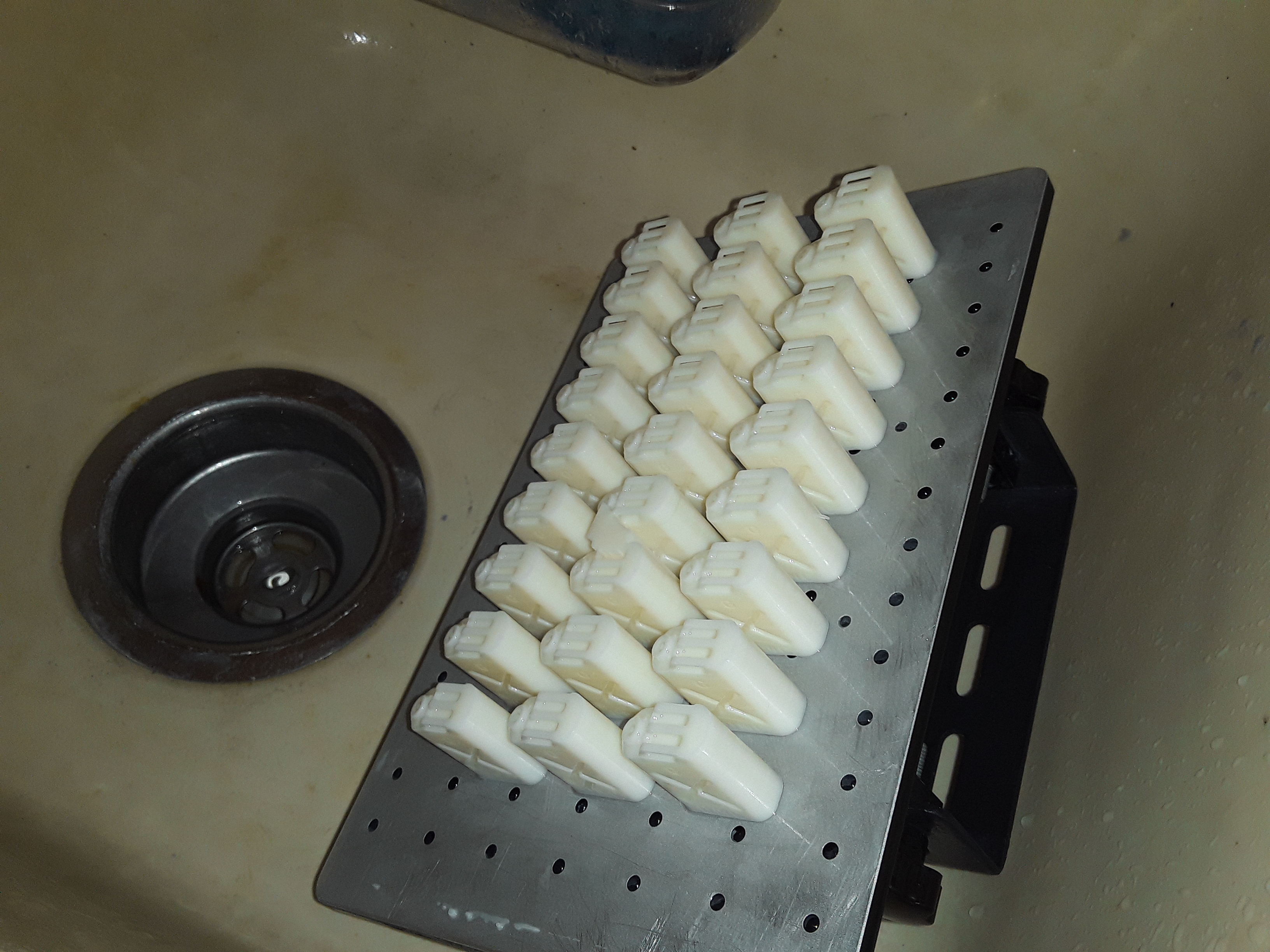

and the printer itself. This is a whole different ball 'o wax, this resin stuff, but with water-washable resin it's so much easier. You still have to wear gloves and it still doesn't smell like roses, but all the hazards of rubbing alcohol have vanished.
Attachment 2268244

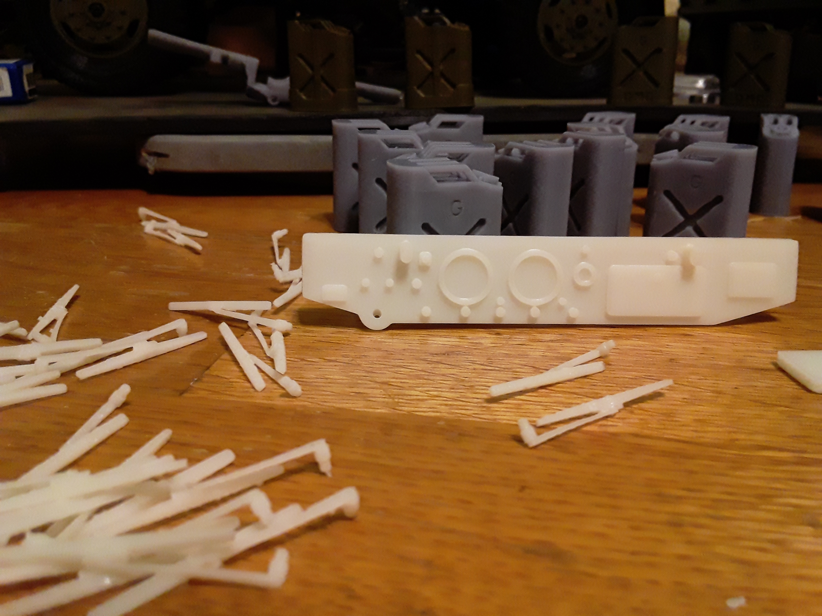

and these are absolutely essential tools for any newbie to sla printing
Attachment 2268245
I'd really like to hear from anyone that's playing around with this stuff, or fdm printing, or thinking about giving it a whirl. I've already made most of the bonehead mistakes so maybe I can help you to avoid some of the pitfalls. :cool:

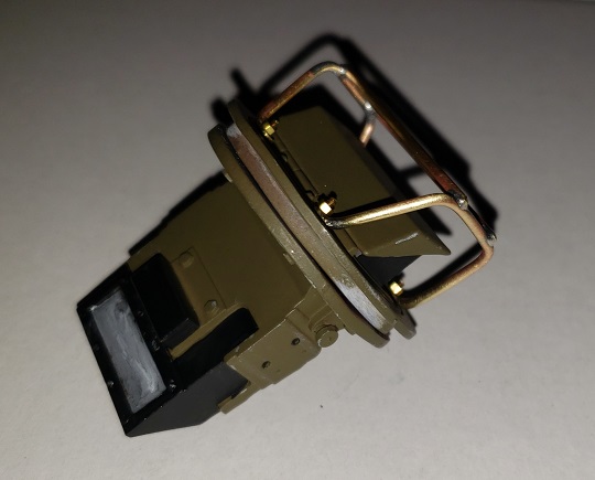

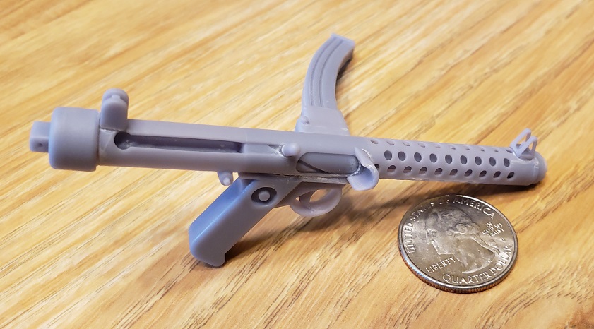

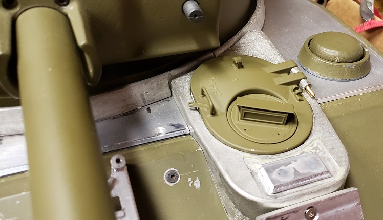

I've recently tried to the Elegoo water washable resin. Overall I really like the cleanup as well. One downside it seems to be much more sensitive to bed adhesion than the "ABS like" resin I was using. It seems to somewhat less strong as well. But detail is crisp and nice just like other resins. For detail parts its hard to beat being able to make your own models and print them yourself. Some images of my recently printed hatches, periscopes, and hitch prototype for my 1/6 Armortek Sherman.
Hitch prototype:
Attachment 2268246
Periscopes:
Attachment 2268247
Attachment 2268248
Attachment 2268249

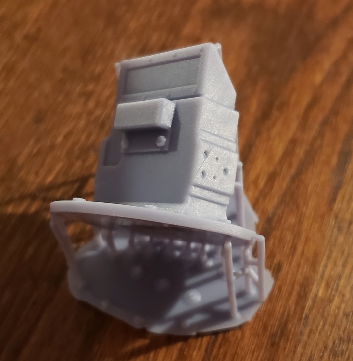

Drivers hatches for Sherman
Attachment 2268250
Attachment 2268251

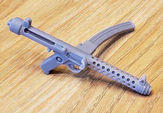

1/6 Sterling SMG for someone else:
Attachment 2268255
Attachment 2268252
US and German gas cans (1/6)
Attachment 2268253
Attachment 2268254
Anyway glad you're getting going with the Resin printer. Its the way to go for detail parts. For 1/16 scale stuff it would be perfect as well.

Made a bit more progress, but still lots to learn. For accessories the sla printer is just great, and the M3 is going to be a kind of multi-media deal, with parts from both printers. Still figuring out which resins are stronger and what not, so far the standard stuff seems kind of brittle. The water washable resin is great, no more gagging on rubbing alcohol, and it seems just as crisp as the regular resin. I just got two more kilos of resin so this weekend I'm going to try some weapons, and also the multi-jerry-can row like in the video.

When I first got the Wanhao D8 I was in touch with a customer service guy and he recommended a couple things that surprised me, like 90 to 100 second first layer time, and 25 seconds exposure per layer. That's contrary to everything I've read on resin bottles (the water washable recommends 60 and 8 second times) but it's worked well and I rarely have adhesion problems. But, I've had enough other problems to make up for it. Right now I'm wondering if the long exposure times are clouding my resin tray or something. This weekend I'm replacing the print screen and rebuilding a resin tank so we'll see how that goes, but the print quality I've been getting still has me hopeful.
RC_BobM 10-17-2020 08:09 AM
Hi Gary, interesting information. But I think longer exposure times may cloud your FEP sheet, and lead to burned out LCD screen much faster. But the water wash resin may require increased exposure times for best results. Probably a balance of increasing the exposure time but not so much we burn out (over tax) the LCD.
Thanks for the information.
B
Crius 10-17-2020 08:22 AM
I was thinking about trying something a lot closer to the manufacturer recommendations on the resin, so I was going to cut down to 80 Seconds for the first four layers and then use 10 seconds per layer after that with the slicing software set for water washable resin. Still higher than what they recommend, but not quite so drastic as what I'm using now. I'll let you know how it comes out.
Crius 10-17-2020 08:24 AM
Oh yeah, do you have any good tips or tricks for re-lining the resin tank? I really don't know what I'm doing, as usual, so for me it's mostly trial and error, so any good in for you can pass along would be much appreciated.
RC_BobM 10-17-2020 12:55 PM
Gary
Not sure about the Wanhao, but changing the FEP on the Elegoo tank is pretty straight forward. Its a nice design on the stock metal resin tank. I got some replacement FEP sheets on Amazon. I got a lot of life out of the first FEP sheet, but it was getting scratched, dinged and cloudy - so I replaced it. I also tried a little trick that helps - put a thin coat of PTFE lube on the resin side of the FEP sheet, or RAINEX. A very small amount spread thin and wipe off excess. It seems to help keep parts from sticking to the FEP.
Need to download that new version of Chitubox!
Keep printing!

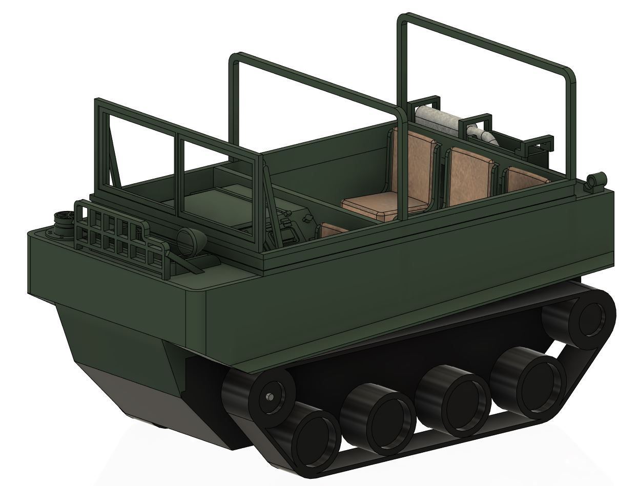

Gary the Wipers that along with the Ammo crate and the Jerry cans you so generously sent me are brilliant, More, Encore, Bravo,
But what caught my eye was your comments on printing an M3 because in common with many others modifying the WSN/Taigen M3 Half Track I found that splitting the Armoured Windshield from its frame was a pain in the a*s and if a hero such as you could print an Armoured Windshield it would make the removal and replacement so much easier.
