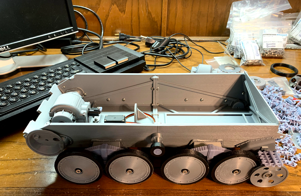

spinnetti 07-13-2021 02:52 PM
'Nuther milestone. Suspension fully installed and working sweet. Still some experimenting with final drive and assembling tracks.

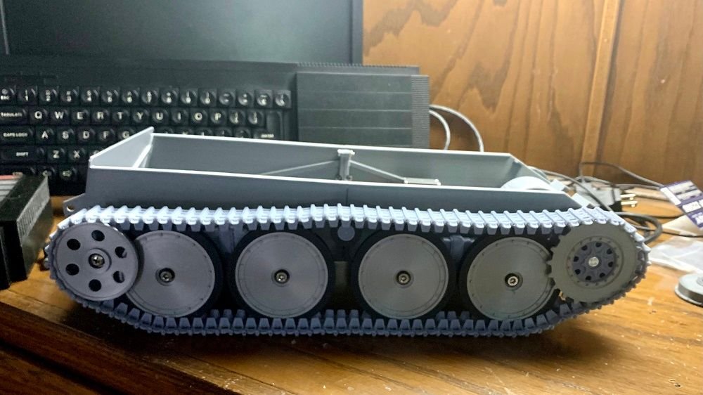

spinnetti 08-16-2021 02:43 PM
Been working on other stuff, but did print the nearly 200 track links and laboriously made them.
https://cimg6.ibsrv.net/gimg/www.rcu...663becb07c.jpg
RC_BobM 08-16-2021 02:45 PM
Sure is looking nice. Your prints are excellent quality. Hope those resin links hold up! They are beautiful.
B
MAUS45 08-16-2021 04:52 PM
That looks fantastic!!!
spinnetti 08-16-2021 05:55 PM
Thanks guys! My hands are killin me - the link pins are tight and take some pushing and twisting to get them in. (just stabbed a pin 1/2 way through my thumb!) The differential works but the breakaway torque is higher than I like. I'll order a different one and see if it "differentials" easier. Need to get off my duff and do the superstructure, but that's the easy part and I like the hard part lol. Given I won't be driving on rough pavement for hundreds of hours, I think it will hold up ok. I test printed the links with the FDM printer, and surprisingly they came out pretty good too, so I can always run FDM links if I need to.
tankme 08-17-2021 12:10 PM
What you need is a small brass hammer to gently tap those pins home.

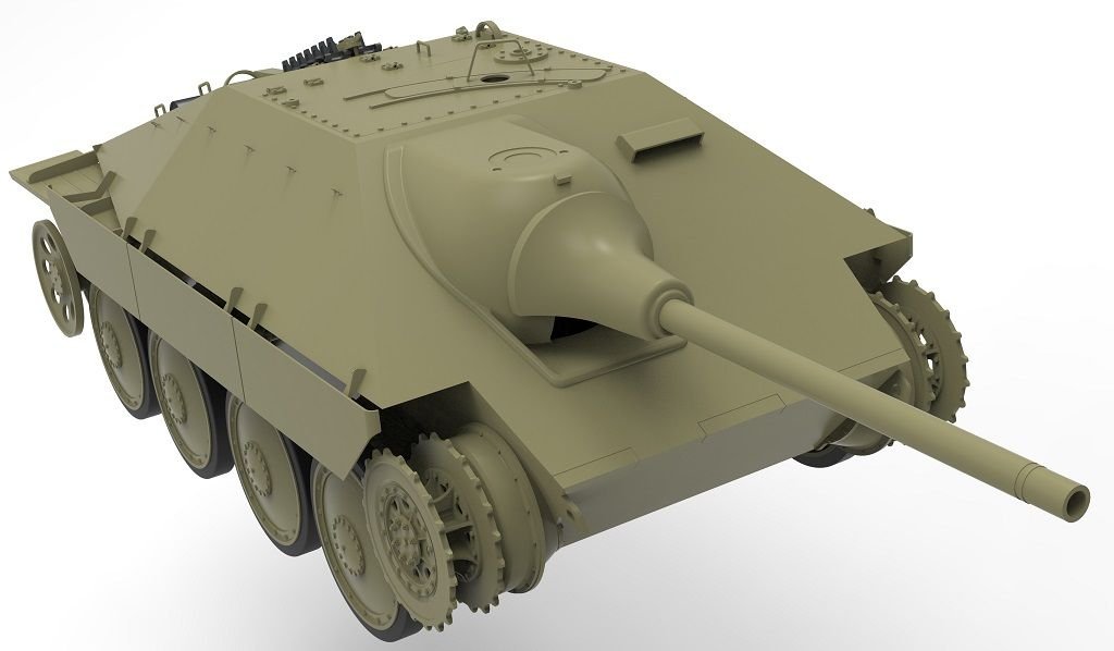

spinnetti 09-19-2021 04:32 PM
Been working on some other stuff, but making progress on design of the superstructure of late.

spinnetti 09-20-2021 04:06 PM
Thanks. I've run the track around the house, and I think the SLA track will be fine- the suspension and tracks work better than I expected; quite smooth. I also got a different differential with much lower break-away torque which should make my scale steering work properly. Onward and upward!

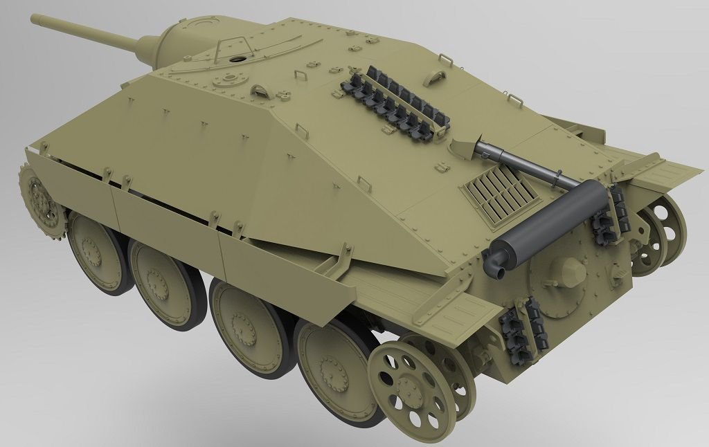

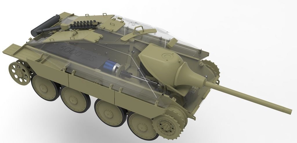

spinnetti 11-01-2021 05:50 PM
Hertzer - chipping away at the details
Lots of little stuff to tune, but getting closer. Still stalling on the gun emplacement, but almost ready to tackle that.
https://cimg4.ibsrv.net/gimg/www.rcu...8e8ea3418e.jpg
Crius 11-02-2021 01:50 AM
When I did the main gun on my hetzer I built a frame to give me Traverse and a trunnion that locked over the barrel of the 50 caliber paintball gun, but something tells me that in that scale you're not going to have quite enough space for that. Bwahaha
Seriously, though, it's looking really, really good. Are you going to do the sliding cover that goes on that vent directly in front of the muffler? They made quite a few changes in that area over the few years that the tank was in production, and I know of at least three different exhaust systems that were installed on those. Mine is very similar to yours, but it has the protective screen that goes over it. I like the way yours looks, it's very smooth and looks like it just came out of the factory. Great job.

spinnetti 11-02-2021 01:41 PM
Thanks for the feedback! As I look at all the data and photos, there are so many small changes its hard to settle on just one config. I do like this earlier muffler better that the later (few months later!) fat can one. I will do the sliding cover, just one more of the many little things to tidy up on the superstructure. There's a dozen other little additions and corrections to go too. I tend to get basics in place, then do waves of updates and revisions - as more parts get in place, it's easier to see the inaccuracies in the overall configuration. For the gun, I'm not very good at organic shapes like the manlet, so I do the easier stuff first lol. I want to be as scale as possible, but don't have enough views of the gun mount internals to really get it right yet. I do plan on scale traverse and elevation though. I'm thinking paint ball or at least airsoft. Its funny how in my model airplanes there are others willing to dogfight and even air-to-air paintball combat, but everybody is all wishy-washy about tanks lol. I'd love to do tank combat like they do 144th scale model warship combat - thin balsa skin so you can see the hits, and CO2 BB guns for the guns (shoot up, score, patch, fight again)
spinnetti 11-02-2021 02:03 PM
Originally Posted by tankme (Post 12701013)
I'm going to build an outer square frame for the my SU-100 with bearings on the top and bottom for traverse. A smaller square frame inside that frame with bearings on the left/right will take care of elevation. Saw a person do it that way and it was very effective on their Ferdi.
like this:
https://cimg7.ibsrv.net/gimg/www.rcu...833e2dc69c.jpg
just square aluminum extrusions, slice off a bit and attached pivots and bearings.
Crius 11-03-2021 08:17 AM
That's pretty much the exact same setup I have in my 1/6 hetzer, just a little smaller. I found that it works very well, and I haven't had any trouble with it even though it's holding a .50 caliber paintball gun that must weigh at least a pound and a half.
