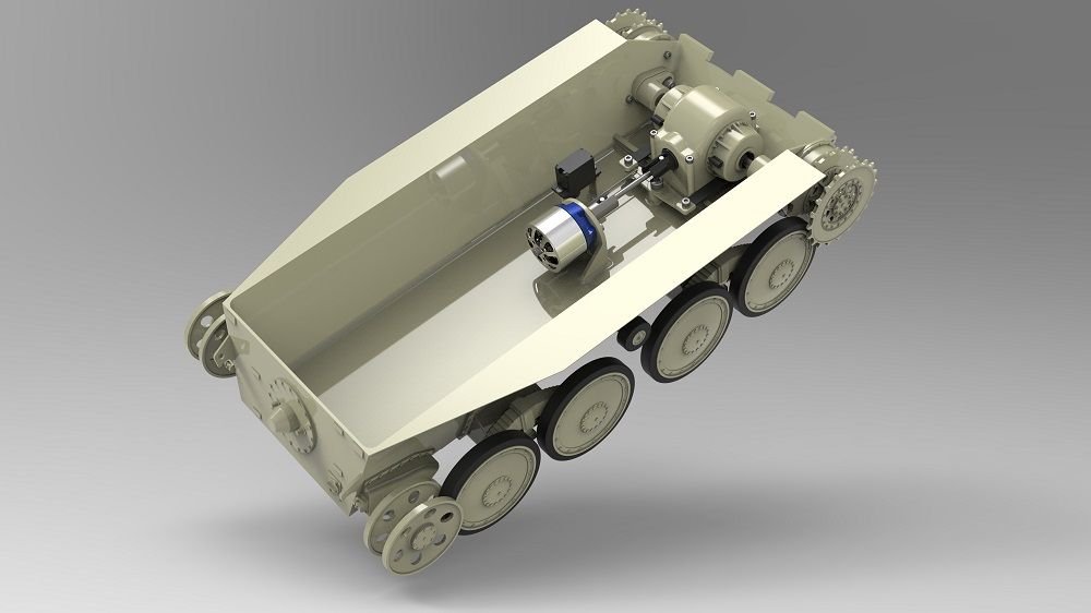

spinnetti 06-20-2021 07:29 PM
Got the Differential install figured out and fully mounted properly, driveshafts sorted as well as the brake drums. Still need to finalize how I want to do the brake bands. First Diff I bought had a bad ring gear, but the replacement is good. The diff barely fit and I had to clearance the front hull plate to get it in there. Total gear reduction is about 1:32 (1:4 in the diff, and 1:8 in the final drive) so it will have monster power, but a low top speed with a brushless outrunner. I haven't done all the math to figure out the motor KV, but pretty soon. I'm printing the diff cover as I type this, and will section the hull soon and trial print that - it will print in 2 parts.

Crius 06-21-2021 07:29 AM
It says above that you'll print the lower Hull in fdm, but from that fantastic print quality in the photo I'm guessing that you printed the prototype in resin? It looks really great, you're getting a most excellent print quality.
spinnetti 06-21-2021 10:36 AM
Sorry to mislead - that's the CAD model post processed in imagining software, not the actual print. Prints look like Prints look unfortunately! I've printed some of the bits here and there, but getting close to printing the lower front hull section to test the drivetrain fit. Just calculating gear ratios now - I might need to redo the final drive ratio.

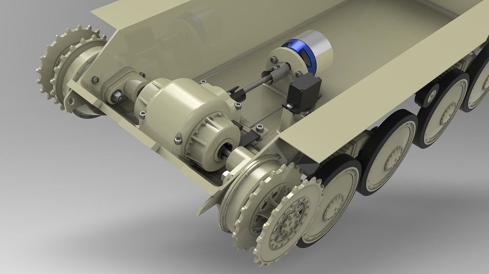

spinnetti 06-23-2021 06:44 PM
Making steady progress... Happy to figure out the driveline brakes finally.. will be fun to see how they work.

herrmill 06-24-2021 02:14 AM
My jaw hit the floor with that last photo before I read the follow up post. Some very nice work, there!
