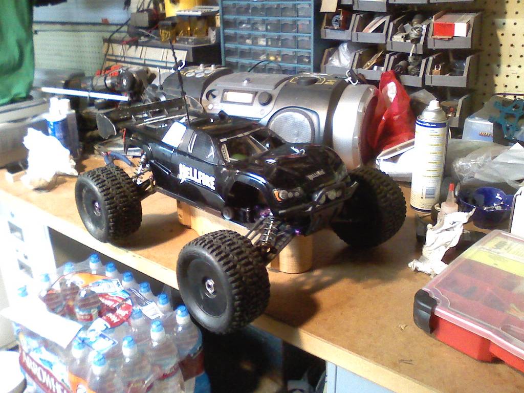

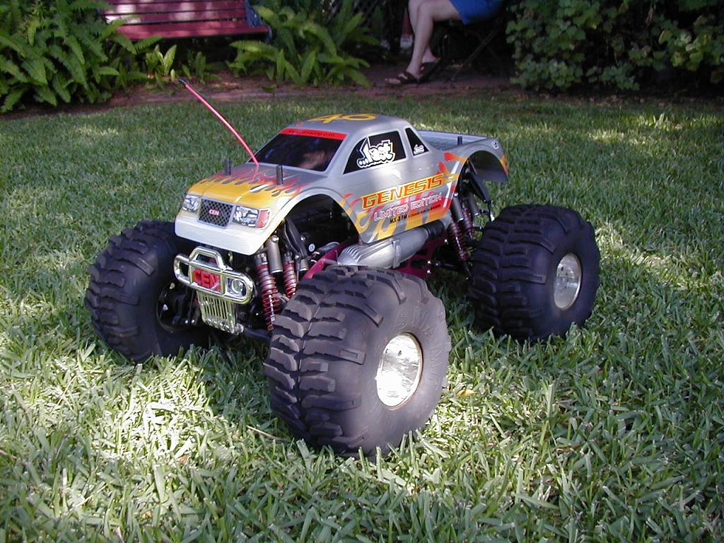

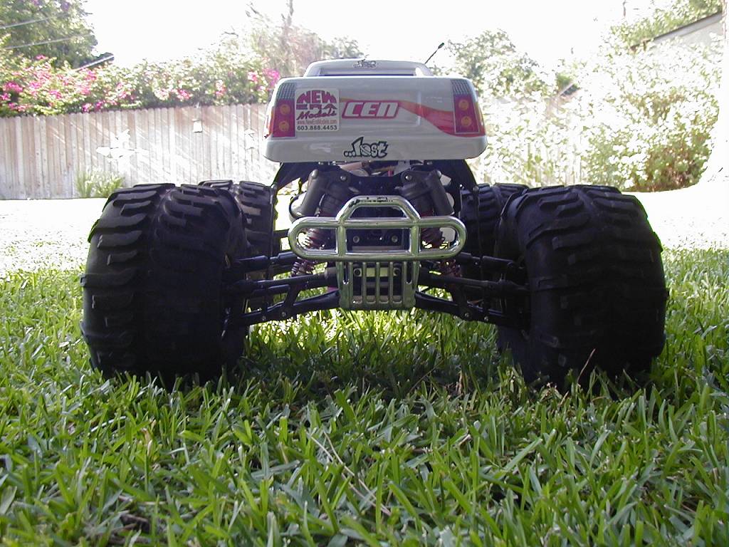

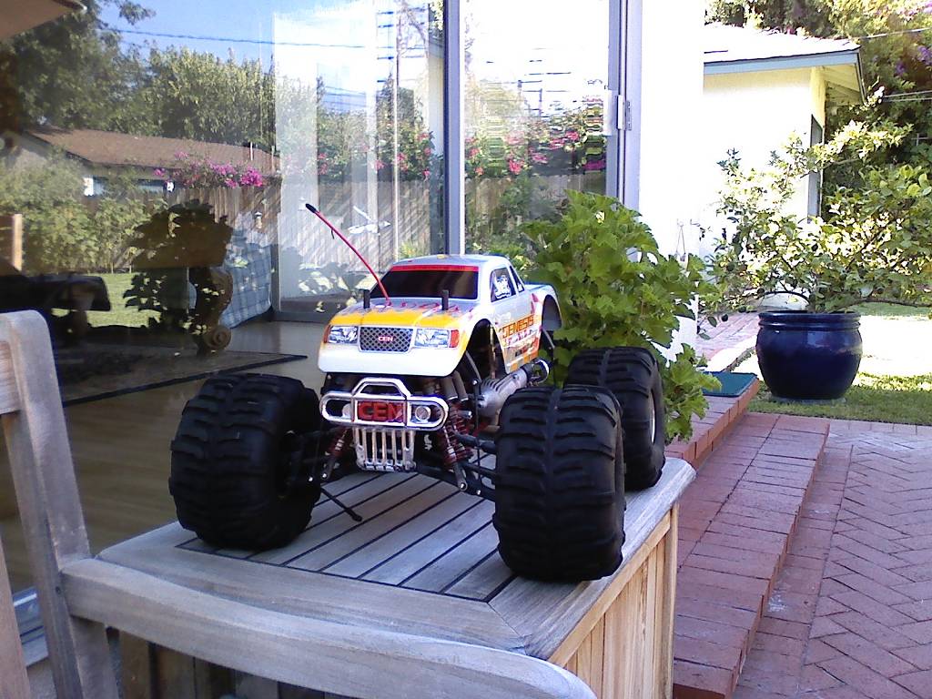

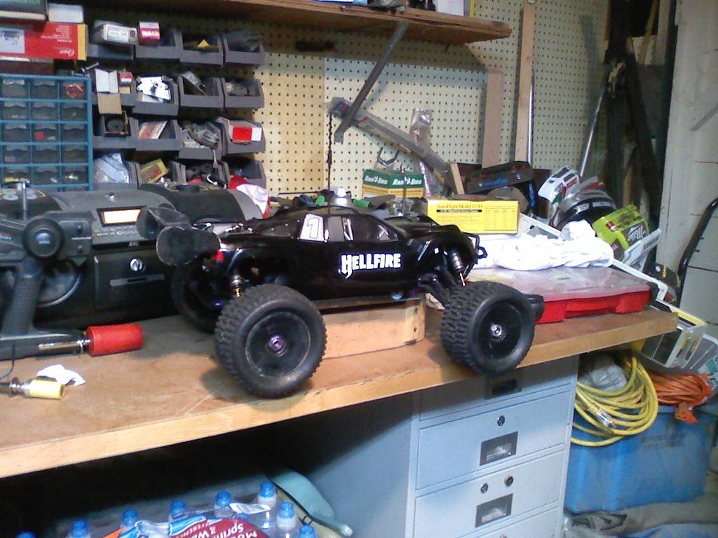

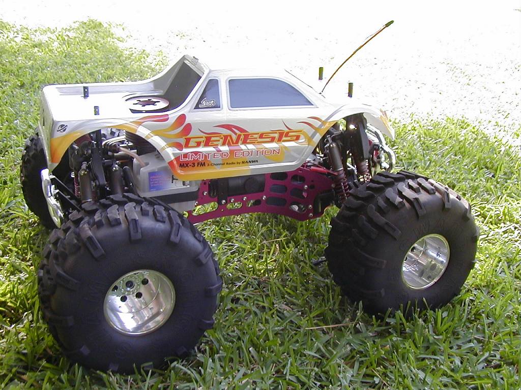

Here is some pics of the Cen Gen &amp; The HF
