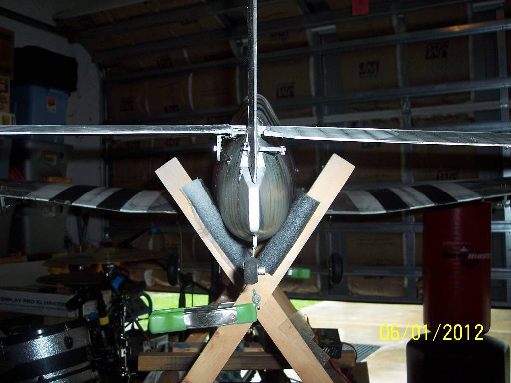

VG you are correct. I just re checked and with my wing at 0 my stab is at -1. I checked the wing again to make sure it was still at 0. I would rather not rip the stab out ,so what do I do to the wing to correct this? Or is it not possible?
I also see the slot on the meter thanks.

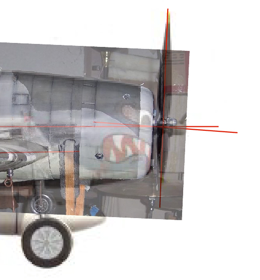

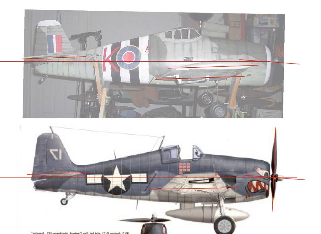

Before you start chopping the wing or stab, just remember the incidences you measured (0 wing -1 stab) are in real life saying that the stab is set at 1 deg less possitive incidence than the wing. For example, lets say in real life you wing is set at 3 deg poss, and the stab 2 deg poss.
I put your side pic against the profile (hardy rocket science but it gives a quick impression)... and they're quite similar.
Whats obvious is the engine thrust angle as mentioned earlier. I'd start there... it's the simplest.
How do you measure it? Best to fly it in. Meaning add some, add some more untill you find the best place.
You'll have to built a spacer to move the engine out some, then add a spacer at the top of the mount to angle the engine down.
Start with 5mm and add/adjust as necessary.
Be informed that you'll very likely need to add some elevator mix to high throttle as the design was never ment to fly at the speeds we fly are models.
Good luck.... and remember, what ever you do, have fun.

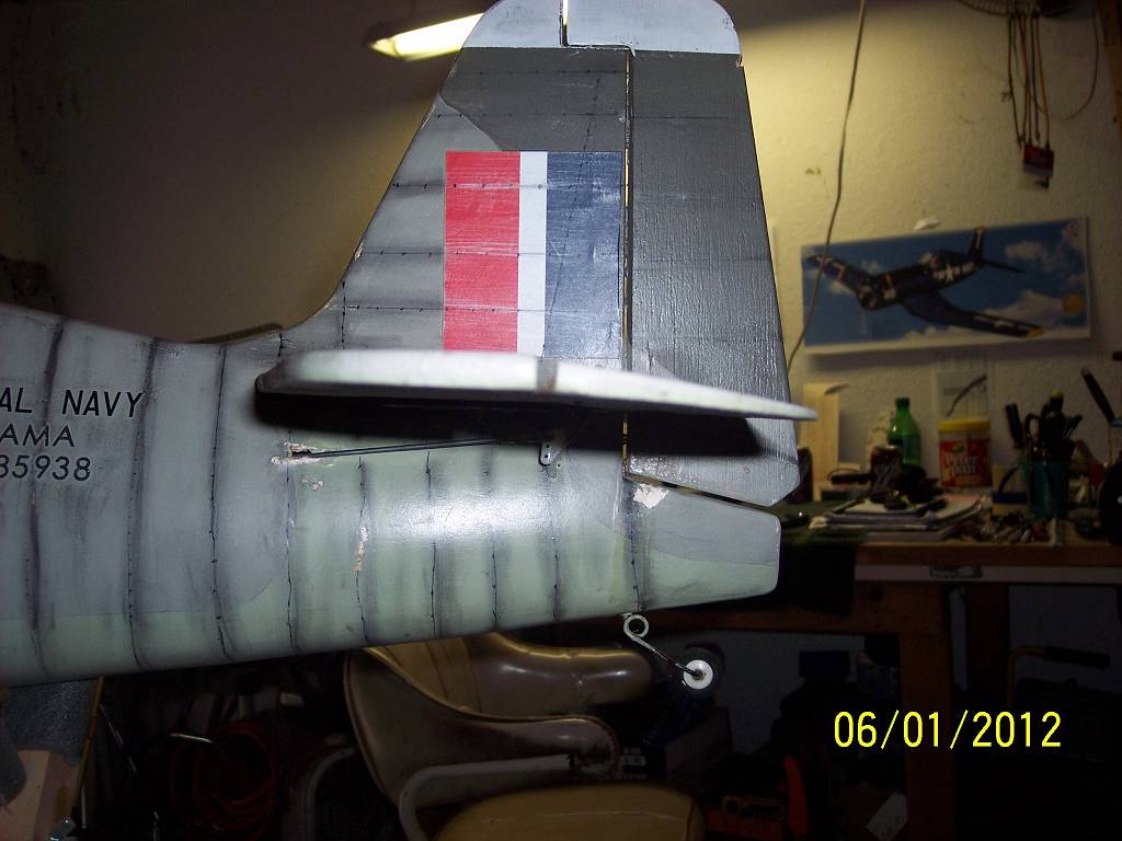

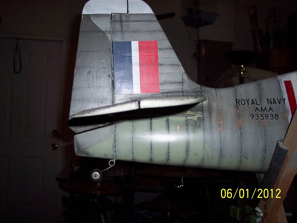

Ok guys, I think I found the problem. I guess when that tree reached out and grabbed me it did more damage than I realized.
Just before I was getting ready to check the CG I noticed while looking at the left side of the plane, the stab looked like it had very little down elevator. I then looked at the elevators from the rear and there it was... The right side was down a lot lower than the left. I know it wasn't like that before the tree and I didn't feel any play and both felt tight. So is it possible that the elavator joiner bar got bent without causing any damage to the elevators?
Now, How do I fix this problem?

Your incidence angles sound right on. But when measuring you should “0” out the tail first, this is how your plane will set in the air at its intended cursing speed. Two degrees of angle of attack on the main wing is “right on” for a nice relaxed cursing speed. It sounds to me you just like to fly faster. Aerobatic aircraft are usually set to 0-0-0, one reason for this is so they can fly upside down with no change in the trim and aerobatic planes more then likely have a more symmetrical airfoils.
Before changing the incidence of the main wing you should really check your balance first and maybe change it to see what happens, it maybe a little tail heavy. If it balances out ok then you can adjust the main wing incidence angle to soot your preferred speed range.
Remember that you control the plane’s altitude with the throttle “not the elevator”.

I do like how the plane fly's. I'll recheck the CG then shim down the engine a bit. I'll also fix the difference in elevator halves.
