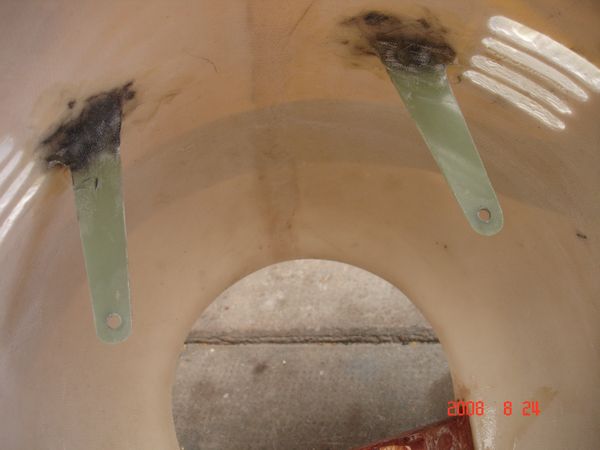

Those would not hold it long! Problem is vibrations.
A much better way of holding a cowl is doing it like this.
3mm epoxy plates glued (24 hour epoxy finnishing resin and cut glass/carbonfiber ) inside the cowl using four metal screws screwed into the firewall. The cowl is secured through the front using a long screw driver.

Let me see if I got this right...........................
1 Make 4 fiberglass supports
2 Epoxy them or glass them to the INSIDE of the cowling
3 then, screw those supports to the firewall of the fuselage??
Is that right??? If I am right, th eobvious weak points would be where the supports are glassed onto the COWLING, yea???

Yes, the weak point or shear point would be at ther attachment to the cowl...but, if properly attached and glassed to the cowl with proper preparation this is a viable, time tested method of mounting. Since there should be no flexing of the arms when they are secured down flat on the firewall and there is no appreciable force acting on the cowl they are not likely to break off.
