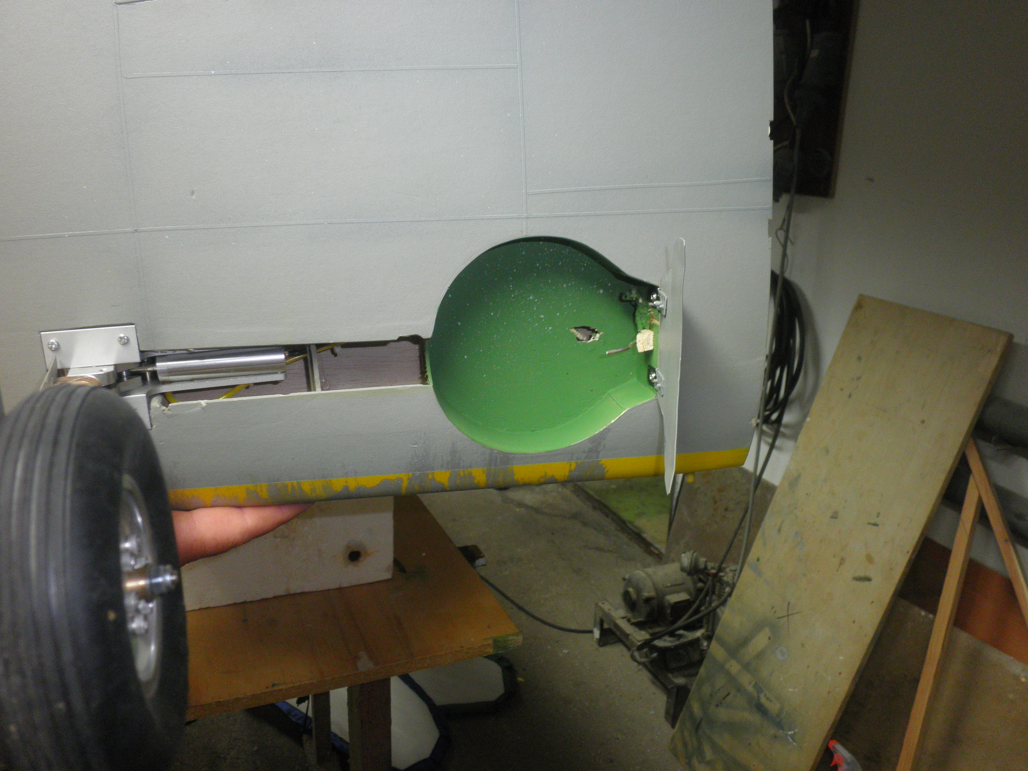

Does anyone the distance from the firewall to the prop drive washer on a CMP 50cc Zero?
Also need the CG point.
Thanks!!!
Old 02-23-2014 | 04:55 AM
Prekin's Avatar
My Feedback: (19)
Joined: Jan 2008
Posts: 2,137
Received 83 Likes on 75 Posts
The distance from the firewall to the prop drive washer is 210 mm, and the CG on my Zero is 135 mm from the leading edge.

Thanks Prekin.
What engine is that and what about that fancy exhaust system you have?
Looks like you're not using a cowl ring either.?
Old 02-23-2014 | 10:48 AM
Prekin's Avatar
My Feedback: (19)
Joined: Jan 2008
Posts: 2,137
The engine is DLE 55. I made a scale exhaust system, because this Zero needs much weight in the nose. I use cowl, but I had to take it down for the measuring and this pictures.

I meant that it looks like you're mounting your cowl without using the inner ring.
It looks like you used the motor box and stand-offs. Did you cut the motor box down?
Old 02-23-2014 | 12:18 PM
Prekin's Avatar
My Feedback: (19)
Joined: Jan 2008
Posts: 2,137
Sorry, I had a problem with the language. Now I understand, the inner ring is "a part" of fuselage. A do it on every airplane, it easier for me. The cowl hangs on the six screws. At the first picture you can see my Dauntless. I made a new motor box, you can see it in the picture.

Yes!!! I see what you're doing with the cowl. That's a great idea. So it looks like you used the provided motor box but cut it down to get the correct stand-off.
I'm building this with no instructions so your pictures and info is a great help to me. Don't worry about the language thing either. Your English is way better than my Czech.
Any chance of you taking a picture with the cowl on? I'm a little confused because it looks like there will be open vents between the fuse and cowl. I'm guessing that's where those goofy exhaust stacks they give you go.

One more question - Did you offset the motor box to add any right thrust. If so, how much?
PS-love that scale exhaust you built.
Old 02-24-2014 | 08:13 AM
Prekin's Avatar
My Feedback: (19)
Joined: Jan 2008
Posts: 2,137
I offset the thrust 1,5° down and 2° to the right. The vents in the cowl I made opened, because this is the way how to make more space for the air flow. I can send you more pictures, but I´ll be at home on the Friday.

I've got the fuse all done and most of the wings. Today's question is how did you attach the wing? I know I'll be drilling two holes through the trailing edge into the fuse but I'm not quite sure how to do the leading edge.
Did you make a one piece wing?
Pictures of wing mounting and retract install would be great.
Old 03-20-2014 | 01:04 PM
Prekin's Avatar
My Feedback: (19)
Joined: Jan 2008
Posts: 2,137
I have two pieces wing.I attach it by two srews and two bolt in the leading edge.

How about a close up of the leading edge?
Did you use the supplied wheel well liners for the gear or make your own? Did you use the gear doors? the way they come cut they will never lay flush with the wing.

I use ESM pneumatic retract which is given to ESM La-7. The wheels are bigger so I made new gear doors.
Can you explain this question please? : How about a close up of the leading edge? ( I have language problem, sorry)

I´m not sure, but maybe this picture could help you with the question:How about a close up of the leading edge?

Yes, those pictures were exactly what I was looking for. I'm thinking about making my wing one piece for simplicity's sake. All of my other warbirds are one piece already.
