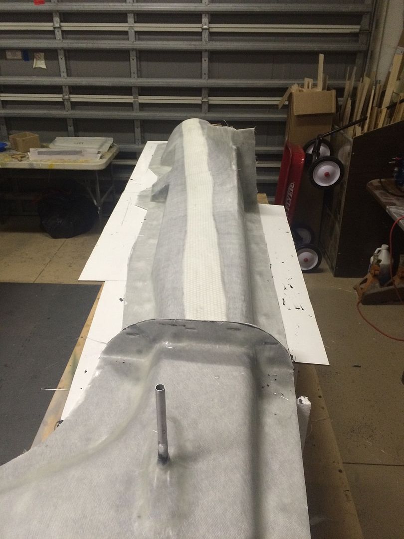

I cleaned up the perimeter of the stab molds then popped the plugs out and gave them a good wash in the sink.
And a closeup of the details:
I also popped the vertical stab molds free as well and also cleaned those up.
Here is a shot looking in from the front with the stab tube inserted through the locator holes i molded in:
Then once all that was done, i put the vert stab molds back on the plug and then drilled all the holes for clamping the molds together. I need to order around 150 clinch nuts now.

Fuselage mold has been removed, cleaned and currently in the process of being prepped for frekote mold release. Here are a few photo's pre cleaning.
Closeup of the button head slotted screws in the mold:
Closeup of more of the details:
Here is the mold minus the tail section standing up beside my trailer after have the wax and Pva washed off:
Since I now have the small parts molded, I can see how well everything fit (i don't think I checked before molding the fuse).You can also see that I attached the windscreen plug to the fuse plug in prep for detailing and molding:

Stabs are now out of the molds. I am very pleased with what came out of the molds and am glad i took the time. Finished weight is a few ounces lighter than what the plugs were Before glassing, so i bet there is a good 4-6 ounce weight savings in the tail with the composite stabs. All that will be required to have these ready for paint is to dress up the seam lines and install the elevator hinges and these are paint ready!
Enough of the babbling, enjoy the pics.
Right side stab molding on the fuse plug. The fit will be perfect once the remainder of the seam flashing is removed.

A few hours have passed, so it was time to pull the vacuum bag off and trim everything. To trim i use a Very sharp wood workers file and slowly worky way around. The only real difficult areas are where there is carbon, otherwise if you catch it at just the right time, its all pretty easy to trim.
I then bolted on the lower wing fairing piece. Tomorrow when i do the other fuse side, ill attach this with some cloth and carbon tow.

The second half is in the vacuum bag.
