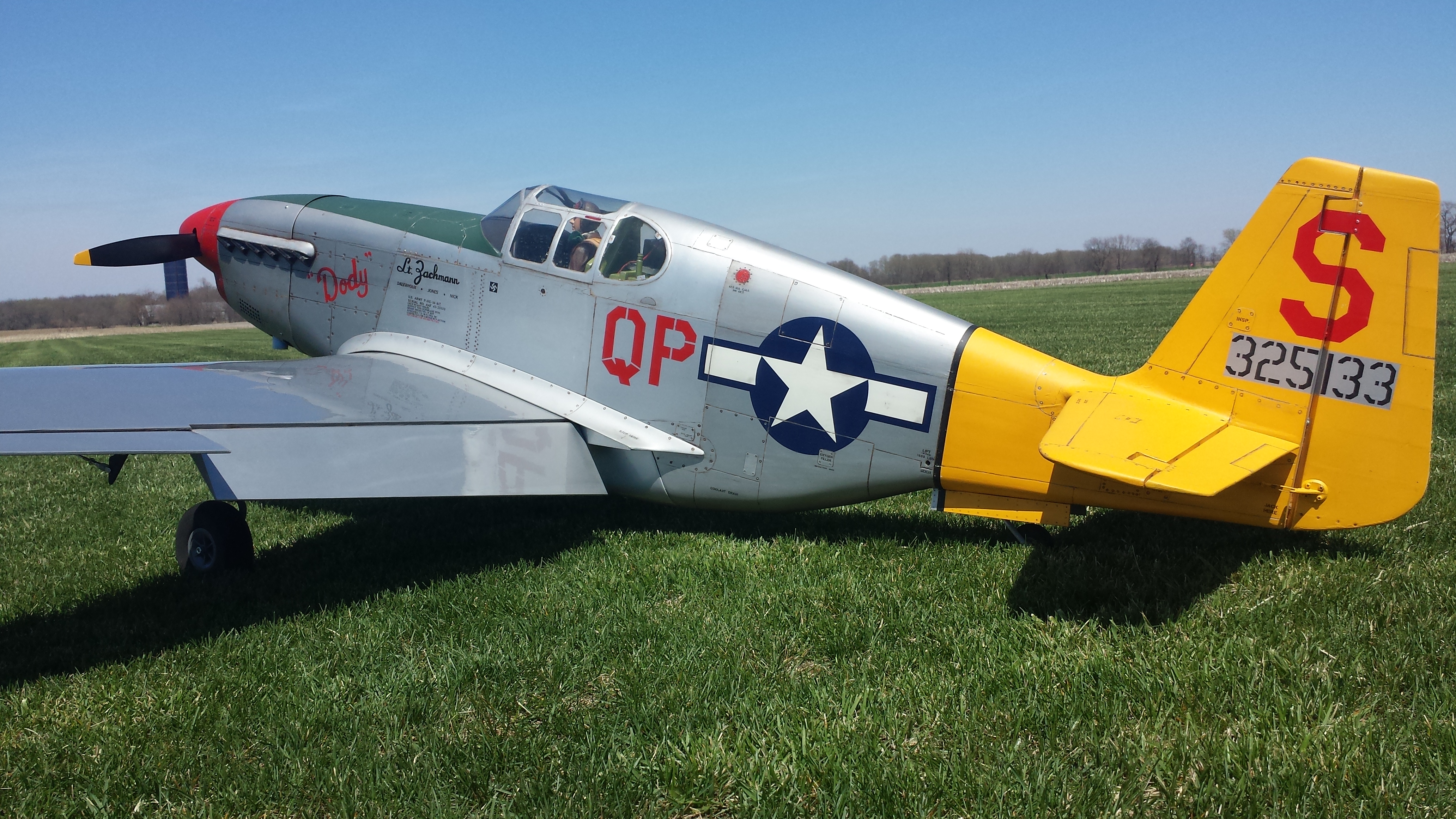

I am getting ready to maiden my top flite giant scale P51 racer.
I began the build in 2013, and 7 years later, she is almost ready.
I did do the CG test, and my CG is 5 mm forward of the recommended CG point.
I do have one major problem.
ANd I believe it to be a real big problem
My wing loading is at 60 ounces per square foot.
I have put a DA 100 inline twin on the nose, and I installed the rudder and elevator servos in the tail, and by doing this, it balances as I have mentioned, with no added weight. The two batteries are located in the rear aspect of the wing cradle area.
