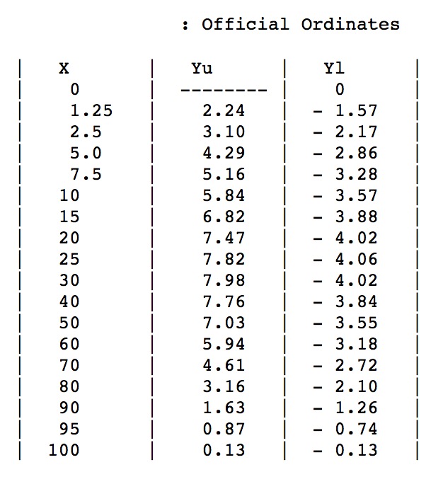

Hi guys,
I'm pretty new to plotting airfoil coordinates actually this is my first try. I want to get accurate airfoils for the Bf109B-E (NACA 2R1 14.2 [wing root] - NACA 2R1 11 [wing tip]) and the later Bf109F-K (NACA 2R1 14.2 [wing root] - NACA 2R1 11.35 [wing tip]).
The root airfoil stayed the same throughout the aircraft versions, but from the F-K version the wing tip airfoil changed slightly. I have got some coordinates for the NACA 2R1 airfoil from varying sources on the net and have input them onto the online plotter here: http://www.windandwet.com/windturbin...tter/index.php
The two sets that I have for this airfoil differ slightly for some reason. The first set is the NACA 2R1 12 and seems to work fine in the plotter giving me an airfoil shape:

The second set is as follows, however it gives an error: error on line 22 at column 41: Entity 'nbsp' not defined

I am pasting both sets of coordinates into the plotter as they appear above. Can anyone spot which part is in error on the second set?
Does anyone have the confirmed airfoil coordinates for NACA 2R1 14.2 [wing root] - NACA 2R1 11 [wing tip] and (NACA 2R1 14.2 [wing root] - NACA 2R1 11.35 [wing tip]?
My aim is to export a .svg version of the airfoils for use in some drawings.
Any help would be really appreciated. Thank you.

The first set of Coordinates that I posted above are for the NACA 2R(1)12. I have read that the 12 denotes a maximum thickness of 12%. The maximum thickness of the early Bf109 airfoil shape was 14.2% [wing root] and 11% [wing tip] with the later versions being 14.2% [wing root] 11.35% [wing tip]. Is that correct?
The first set of coordinates were a set with better resolution and sourced from a Japanese website which also also has the following official coordinates for the 2R(1)12:
There is also some coordinates for the 2R(1)15 airfoil on page 514 of Report 572 National Advisory Committee for Aeronautics (figure 17). Could someone explain the formula for getting the correct coordinates for:
NACA 2R1 14.2
NACA 2R1 11
NACA 2R1 11.35
Any help is appreciated.

Hi , I made this for my models , I use the original airfoil for my F-G -K modifications of fokkerc models
Yes it is correct - with the later versions being 14.2% [wing root] 11.35% [wing tip] !

Hi Fokke, thanks. Some nice looking models you have there!
So I have the higher resolution coordinates for NACA 2R1 12. So presumably these are the original NACA 2R1 coordinates at 12%? So I need to calculate the original coordinates from the 12% coordinates (reverse percentage) so I can then multiply those original 2R1 coordinates by 14.2%, 11% and then 11.35% which will give me the early and late Bf109 airfoil coordinates? Is that correct?
