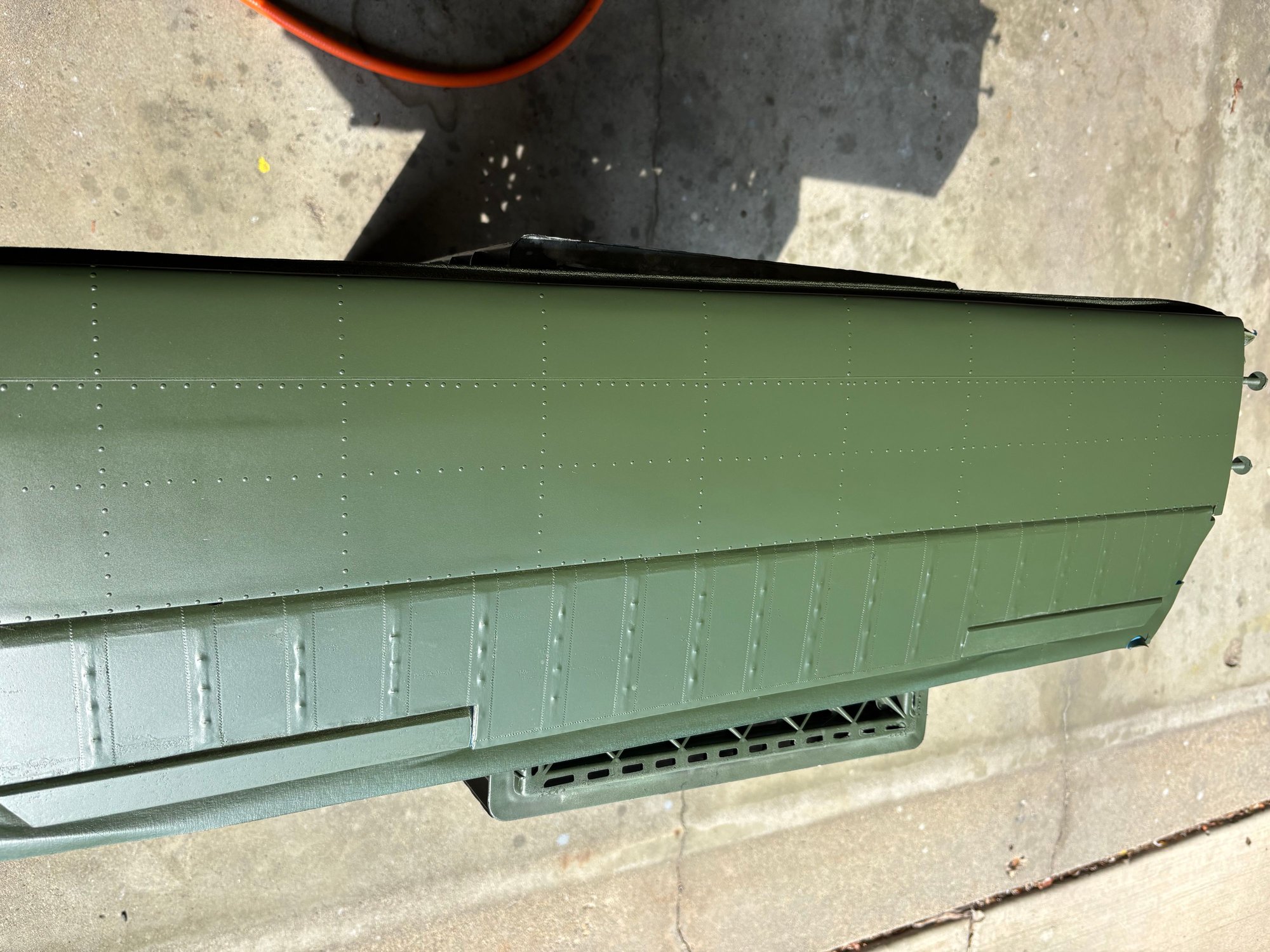

horizontal stab and elevator
[img alt="tail boom
all painted klasskote matched to Swedish colors "]https://cimg9.ibsrv.net/gimg/www.rcuniverse.com-vbulletin/2000x1504/img_6339_fa7c9de033c7441dbf58d3c9d5030df22b9e3f86. jpeg[/img]
tail boom all painted klasskote matched to Swedish colors

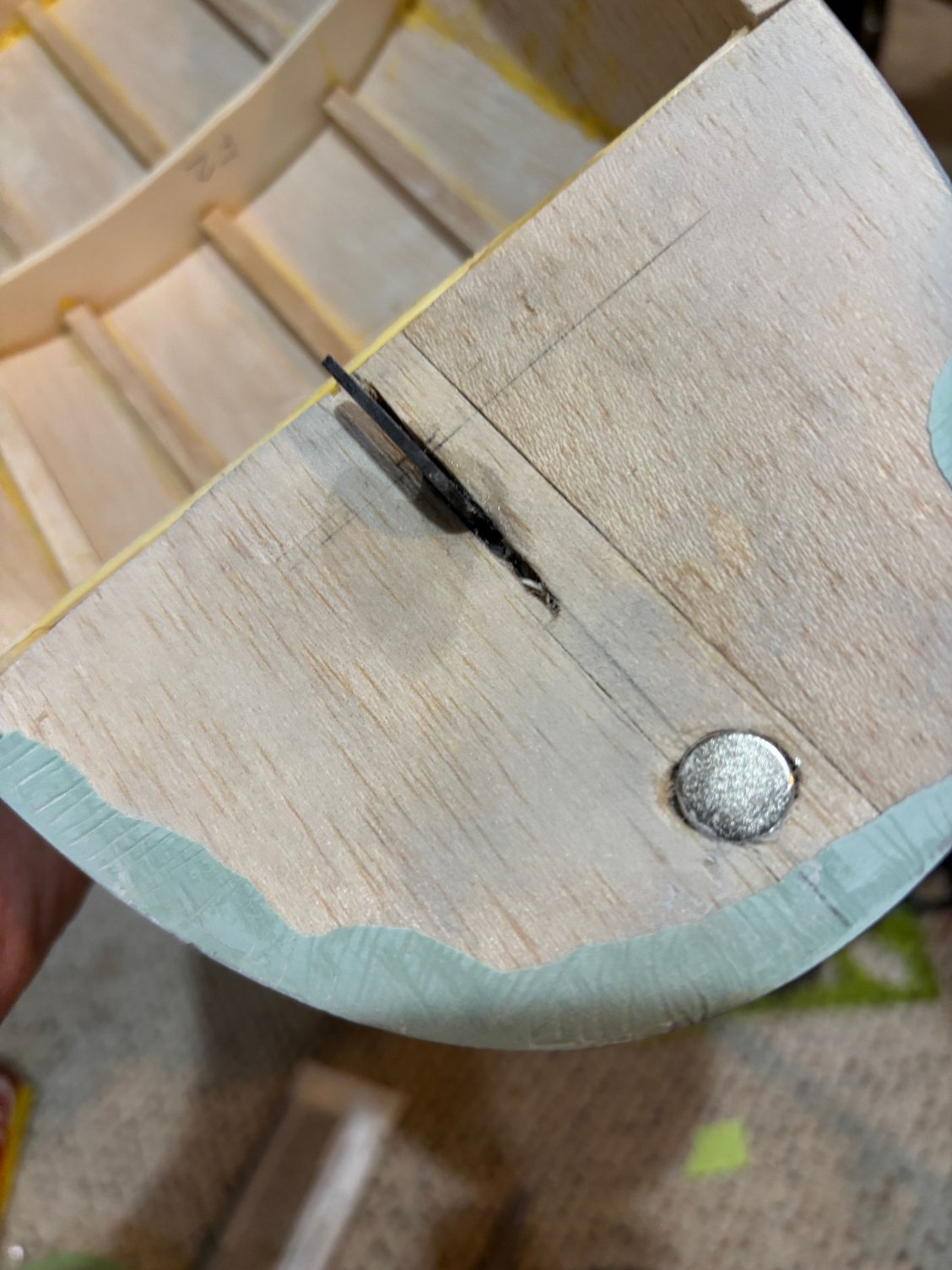

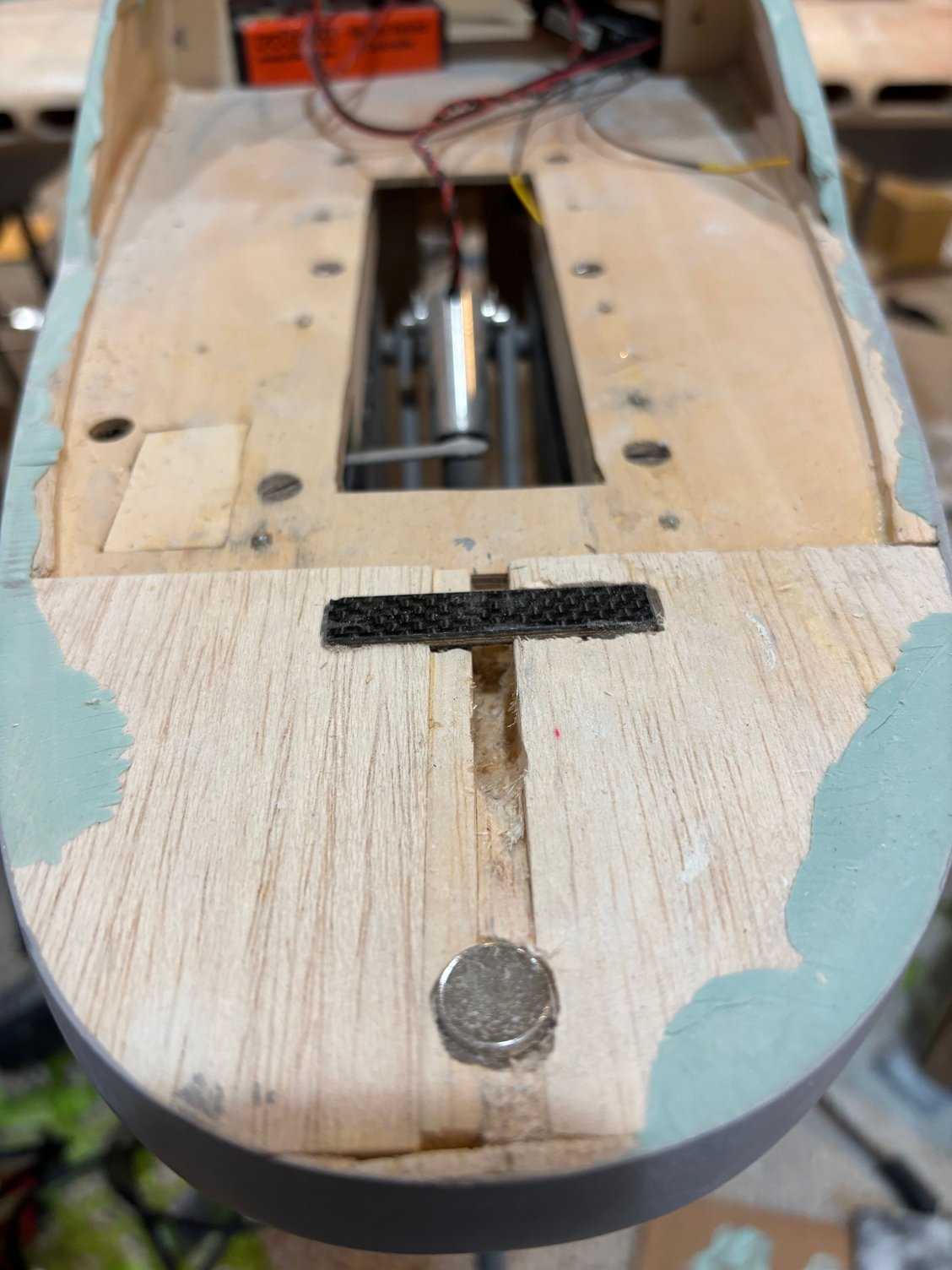

front hatch in place
slides in
slides in
magnet and hook to secure so cannot come off in flight

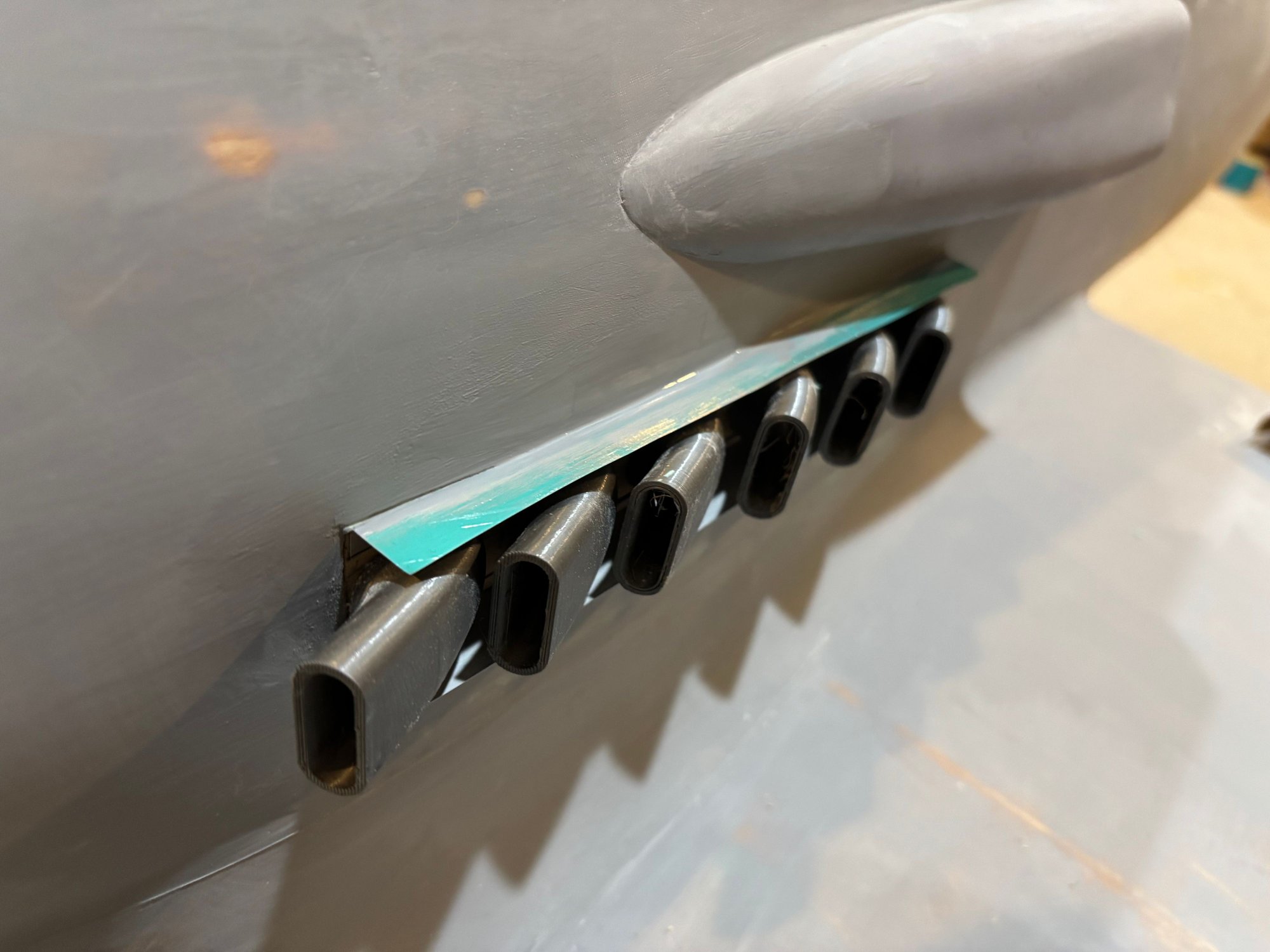

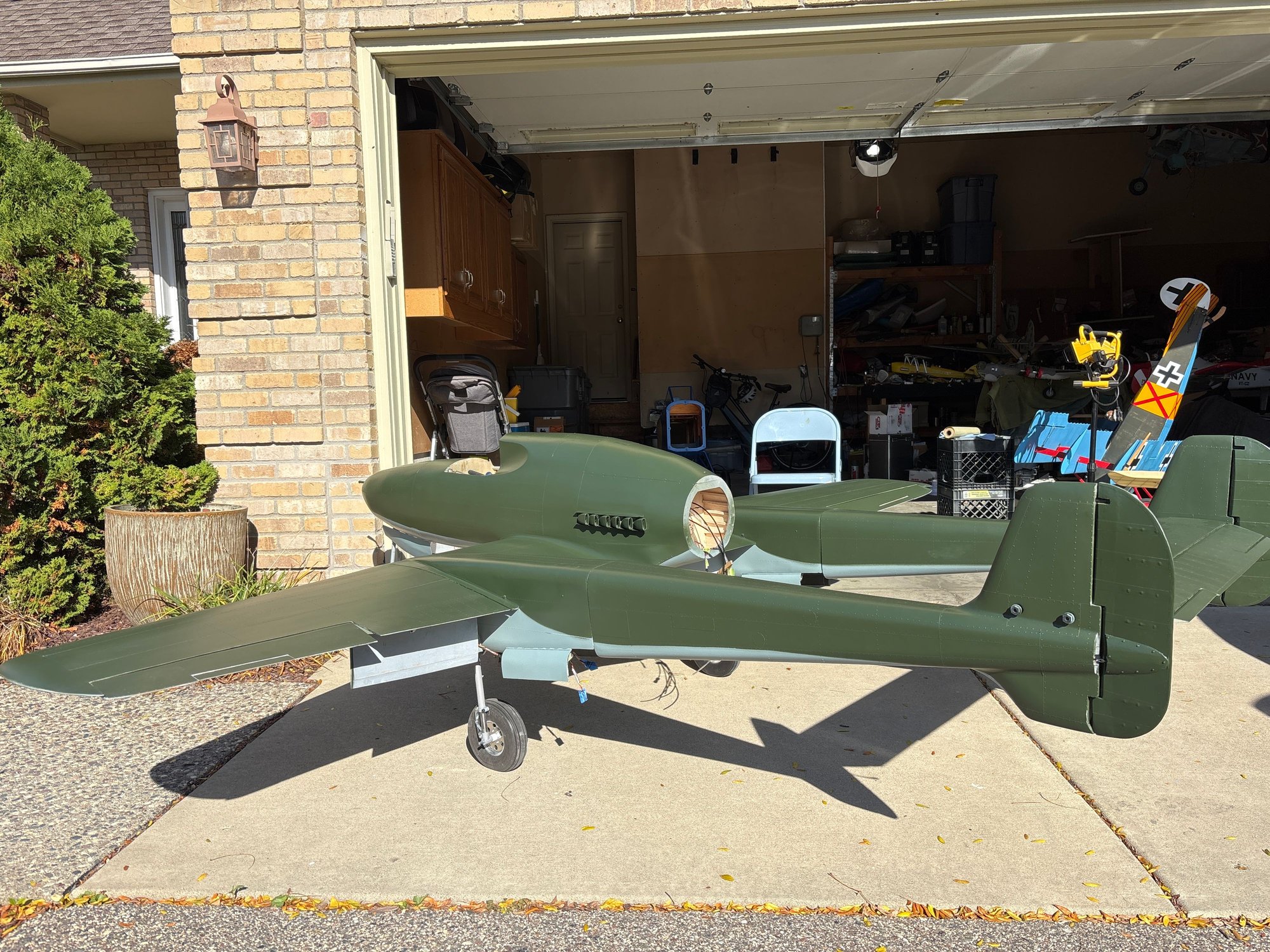

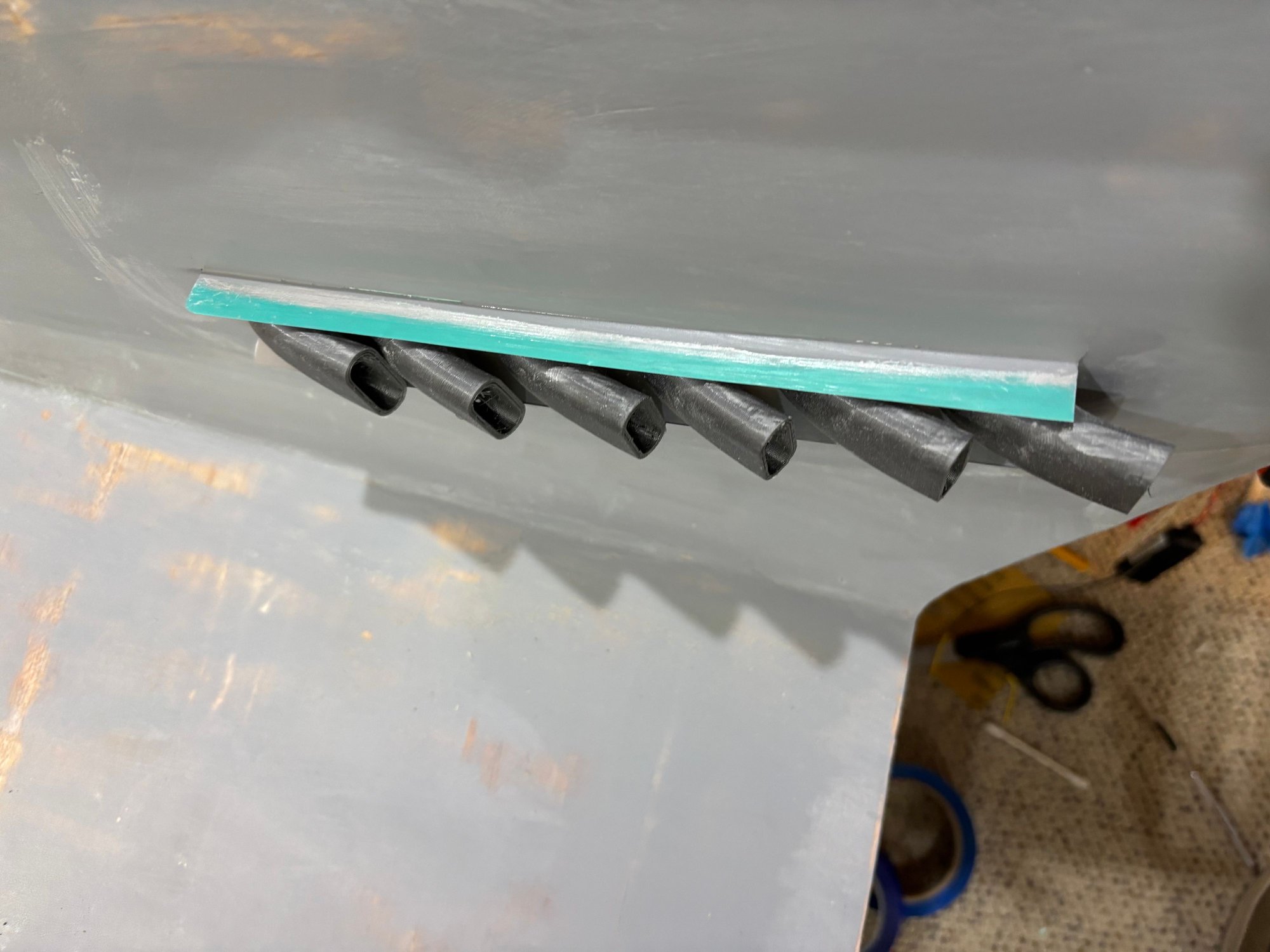

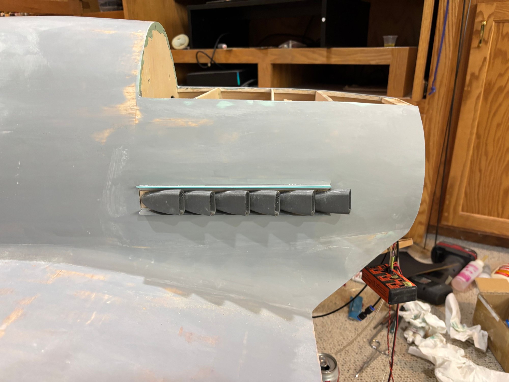

exhaust stacks mounted. These are functional, they are patent so cool air coming thru right air scoop  can flow over speed controller and exit thru exhaust

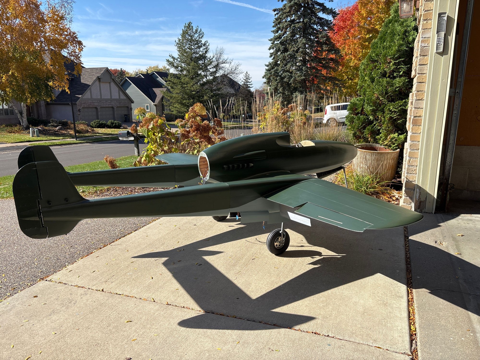

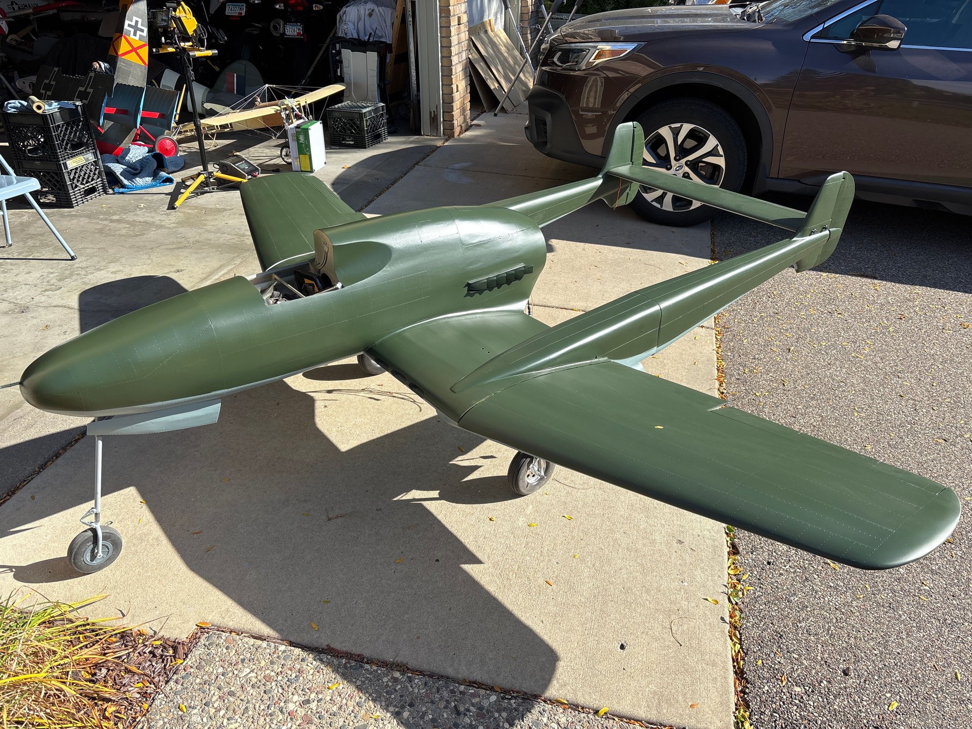

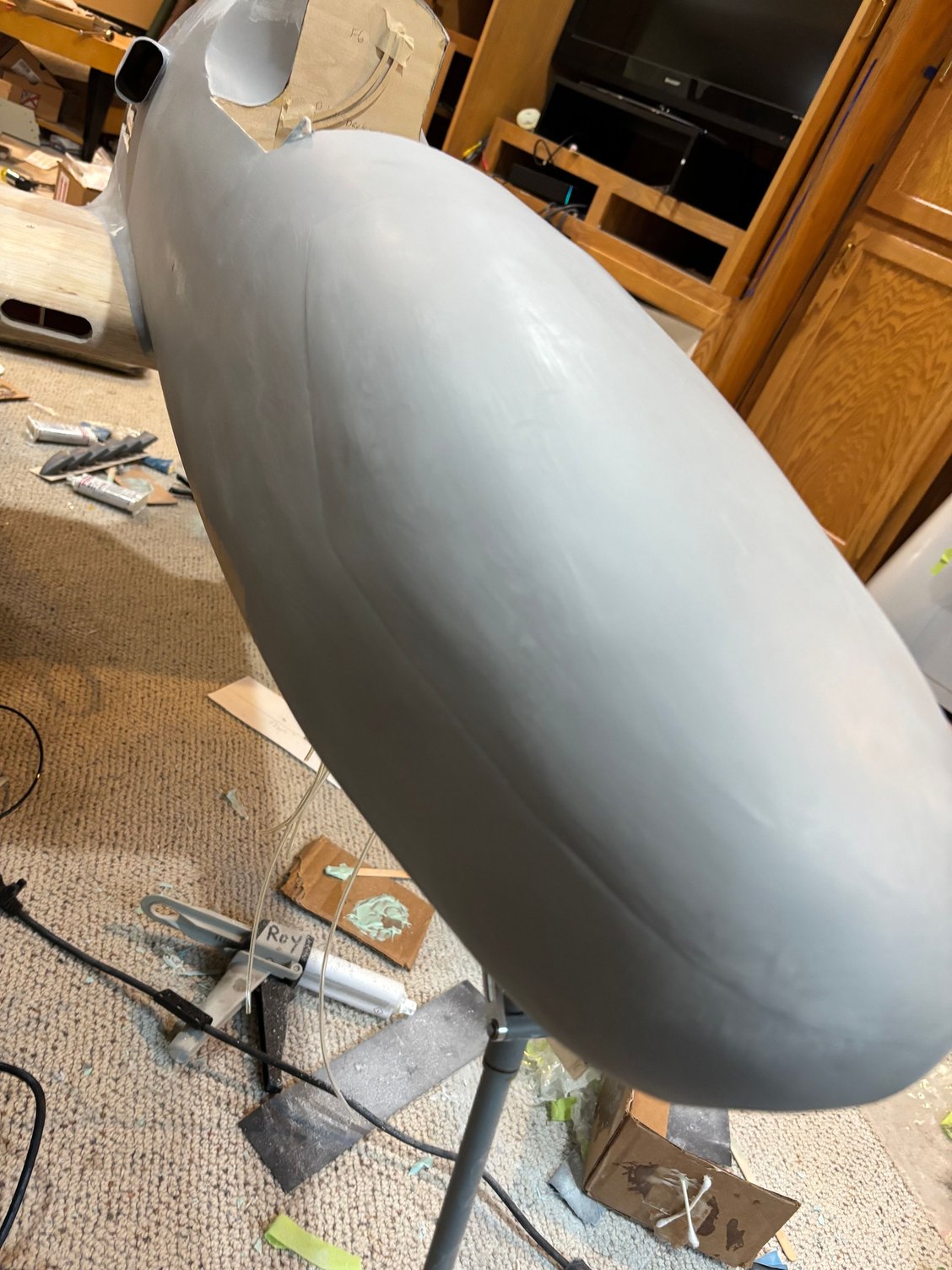

up on her legs, green down. need to do install, paint mask for markings, weathering, then flat clear coat

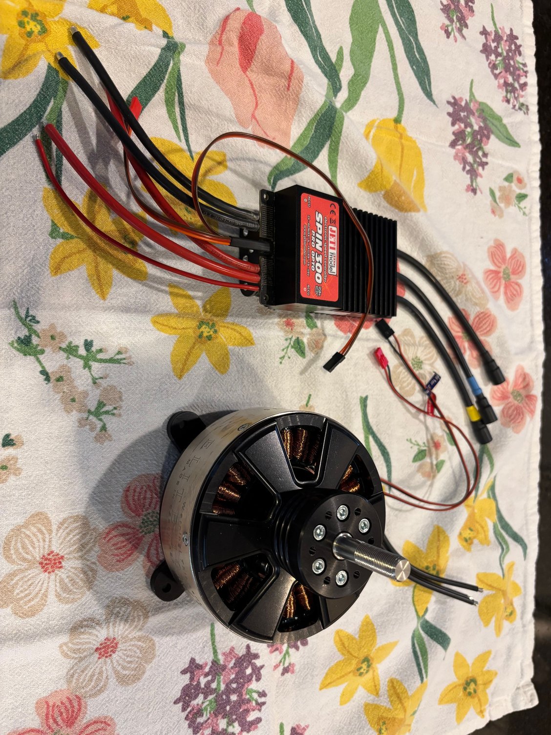

JR Smith, feel free to post in this thread.
I’m ready to install motor and speed controller

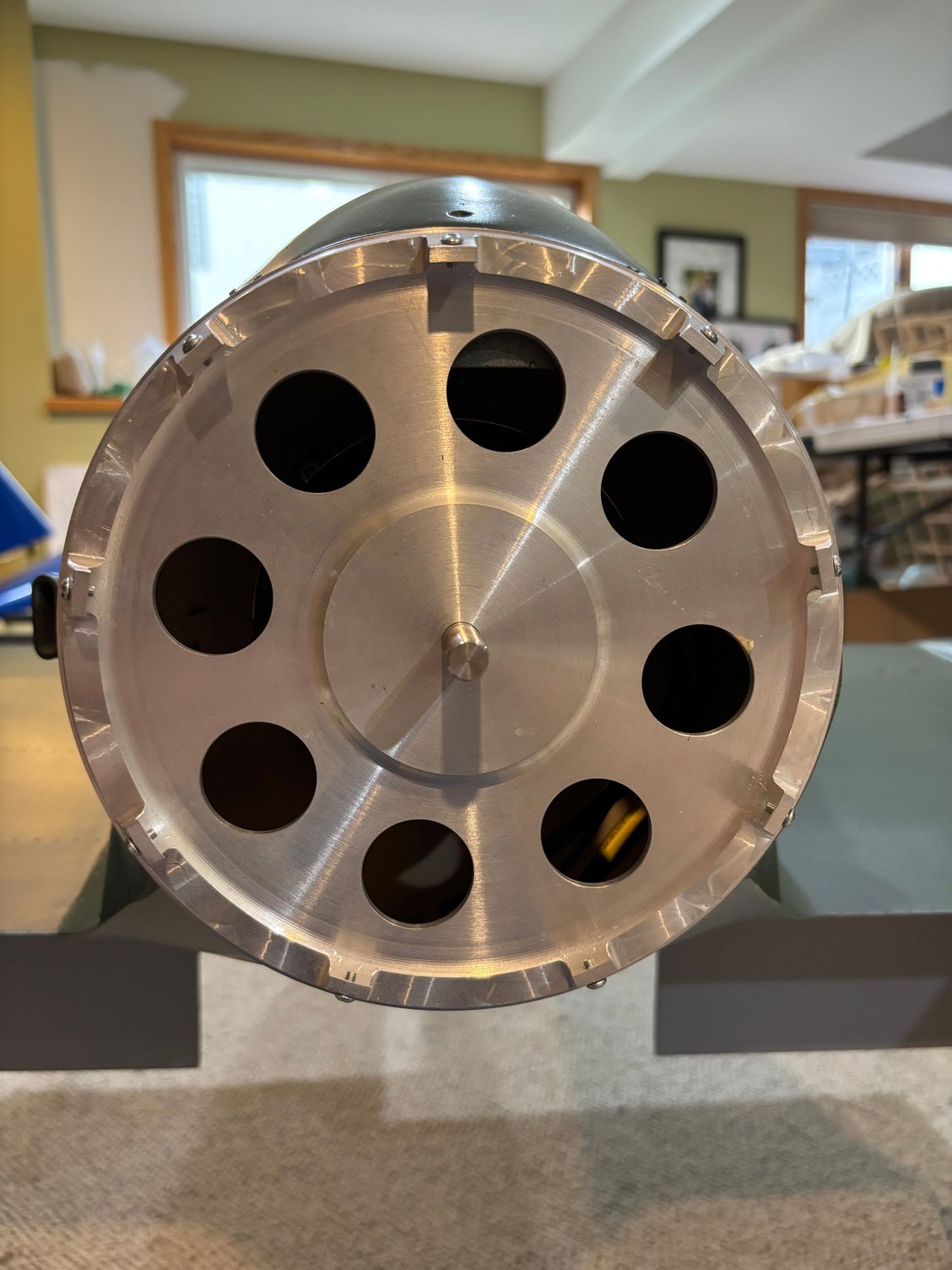

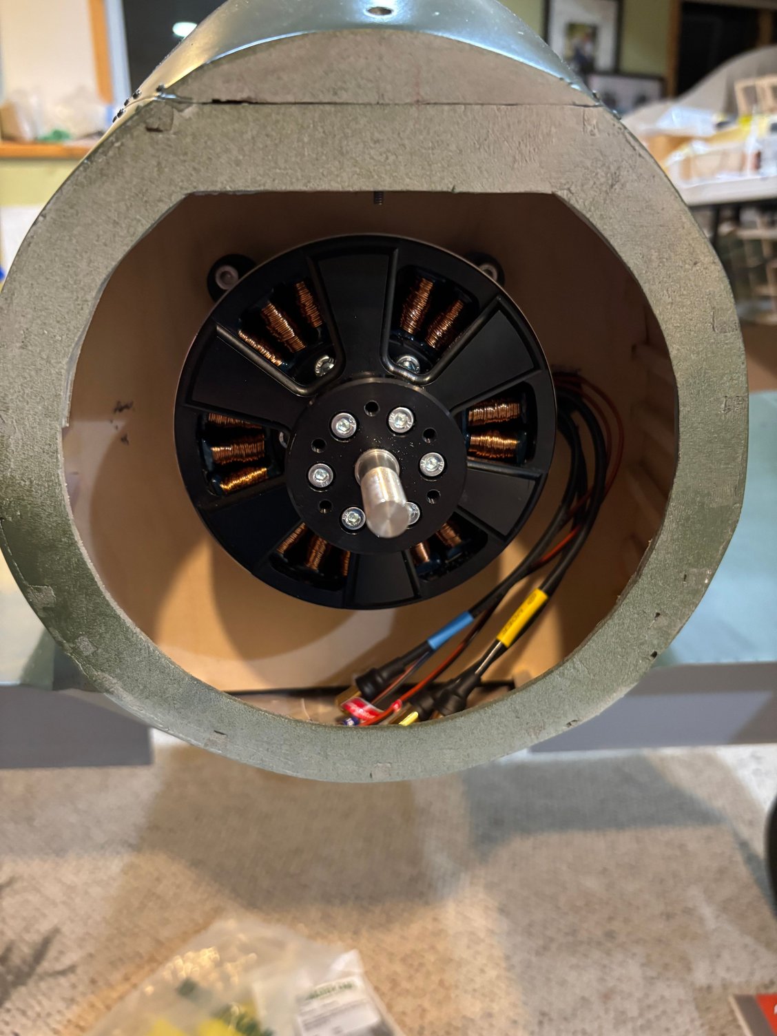

motor mounted, need to drill out prop and spinner backplate

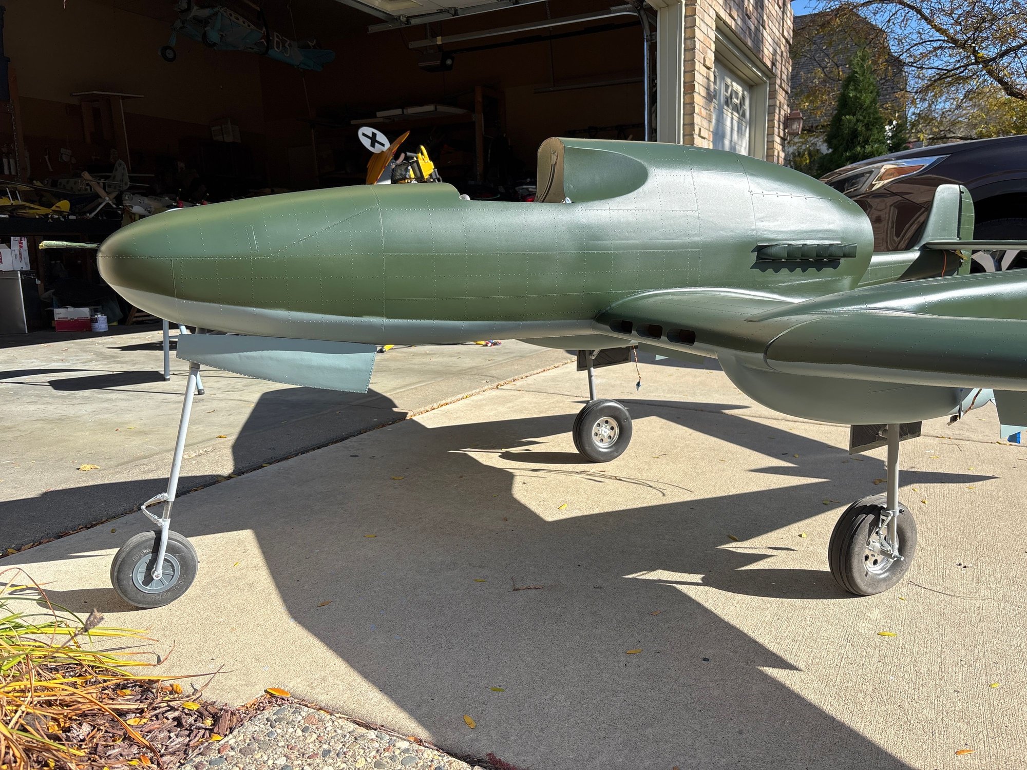

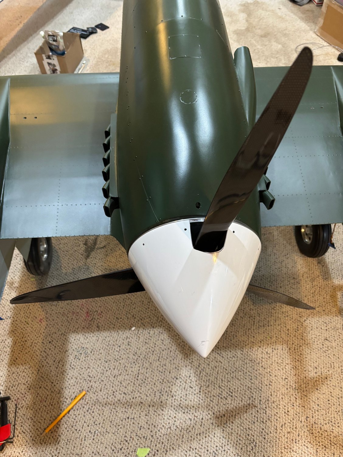

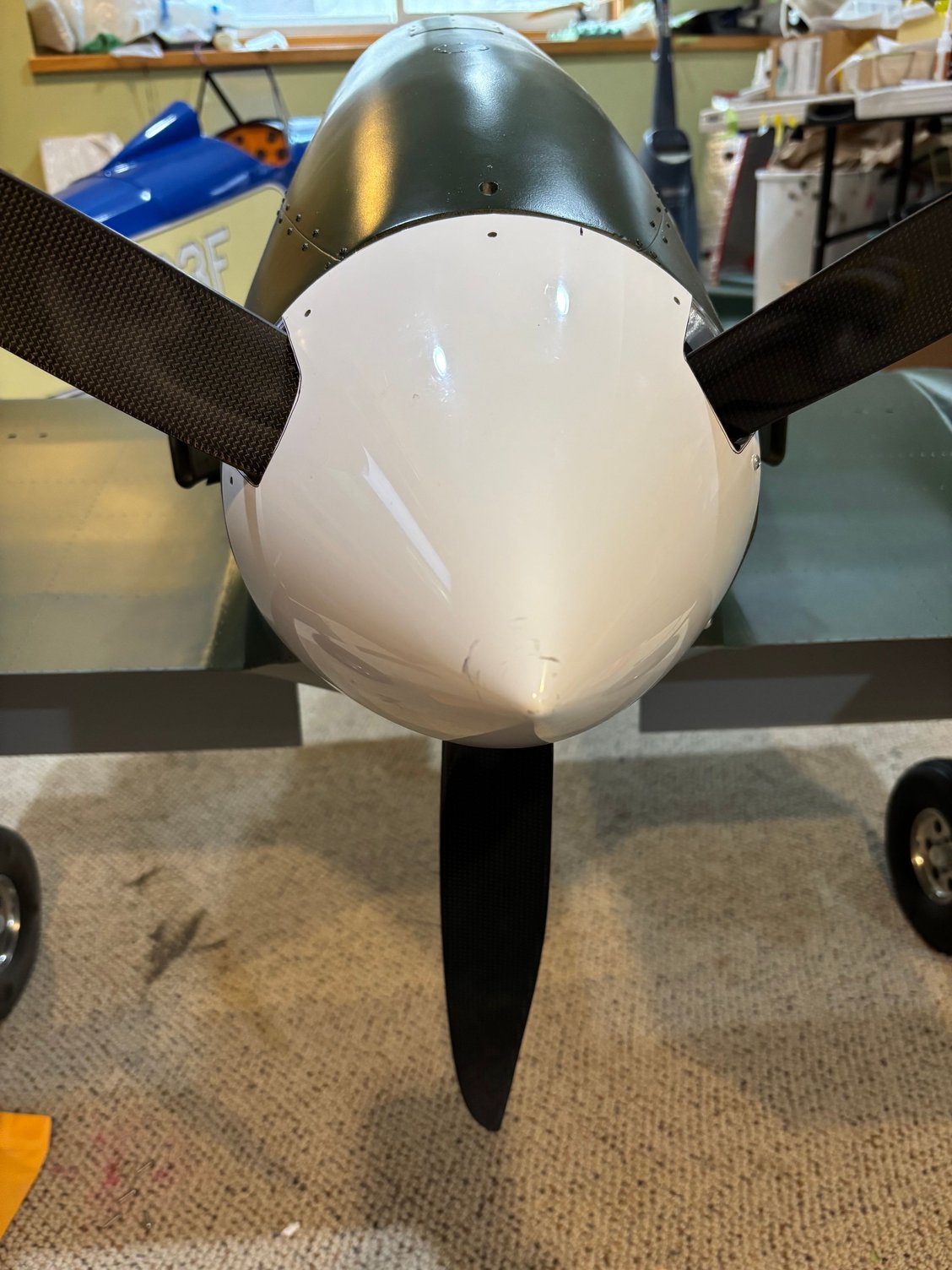

spinner and prop mounted

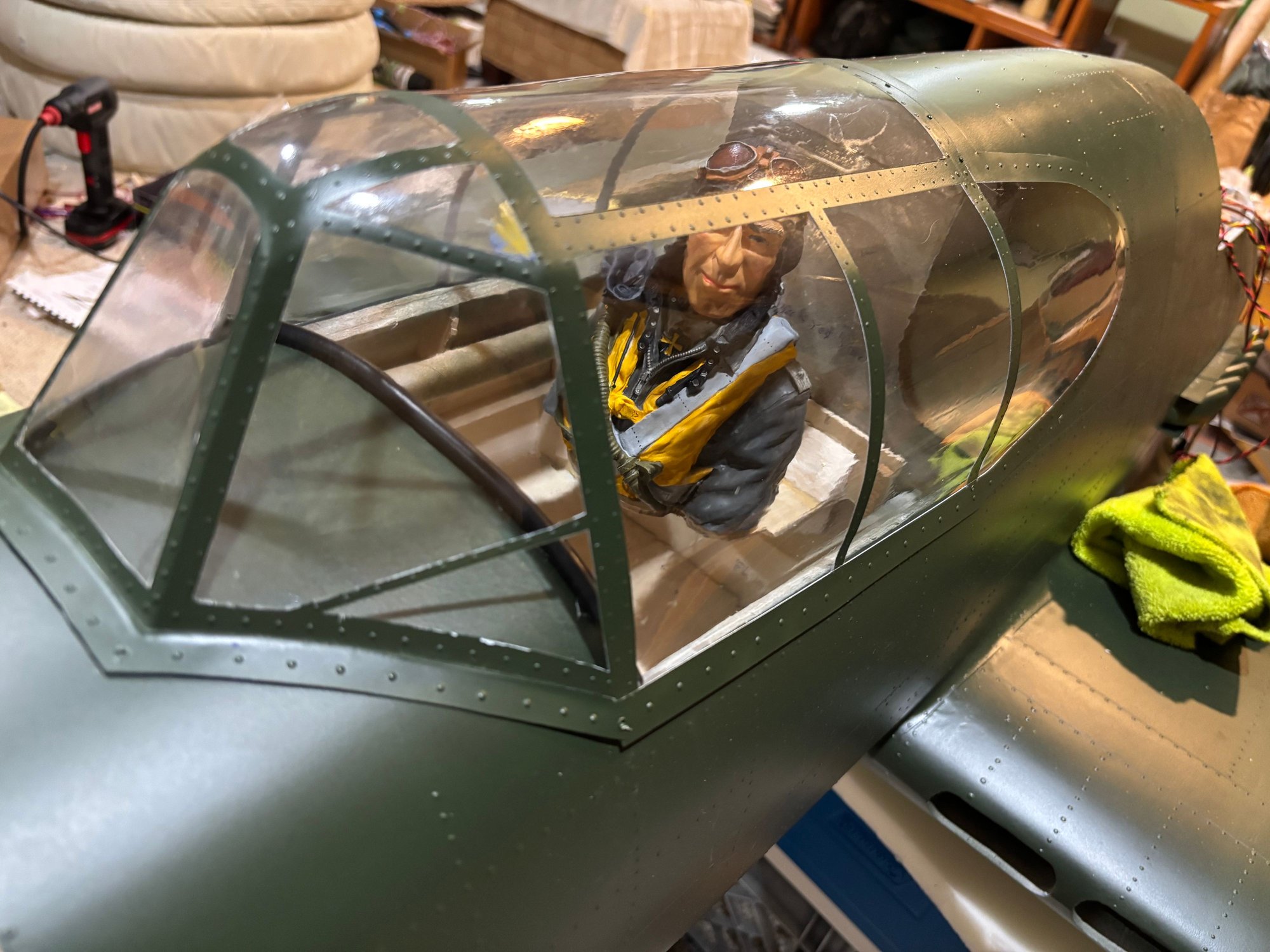

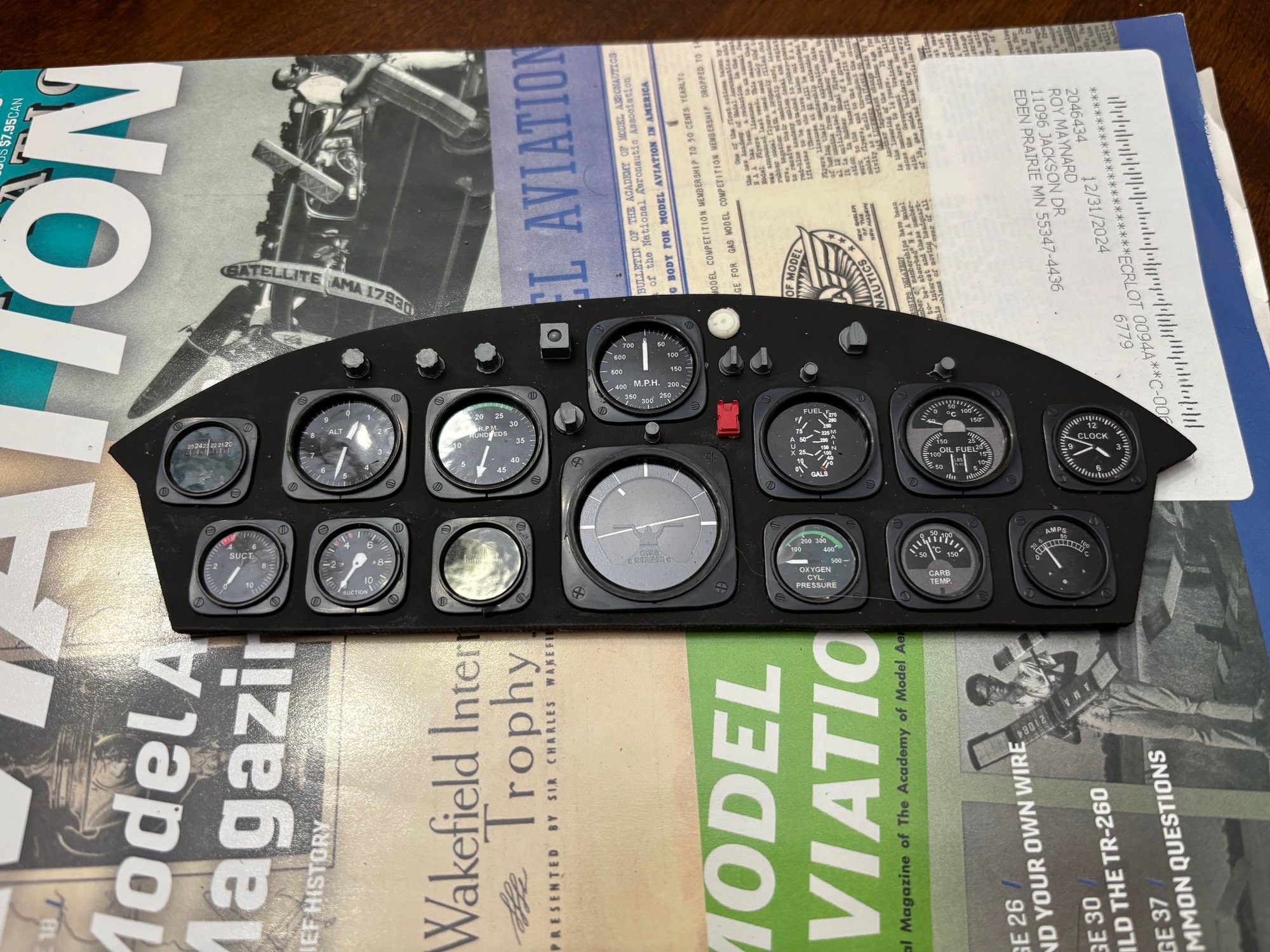

[img alt="instrument panel (non-scale)
No room for scale cockpit due to flight batteries but the instrument panel will liven things up a little "]https://cimg8.ibsrv.net/gimg/www.rcuniverse.com-vbulletin/2000x1504/img_6608_4e6c323c9c345b64af0447b9fccfc46107b73a93. jpeg[/img]
instrument panel (non-scale) No room for scale cockpit due to flight batteries but the instrument panel will liven things up a little

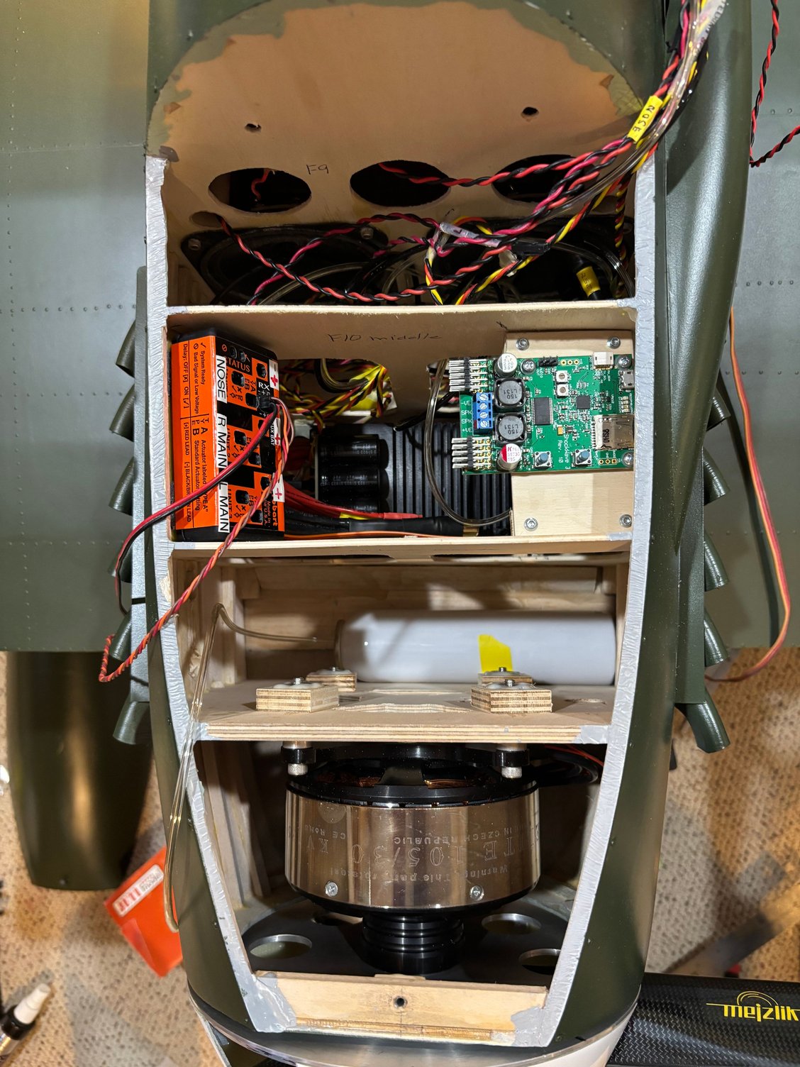

air tank in bay in front of motor. next bay has speed controller in the bottom, robart retract controller on left, sound module on right. The last item to go under rear hatch will be gear door air valve

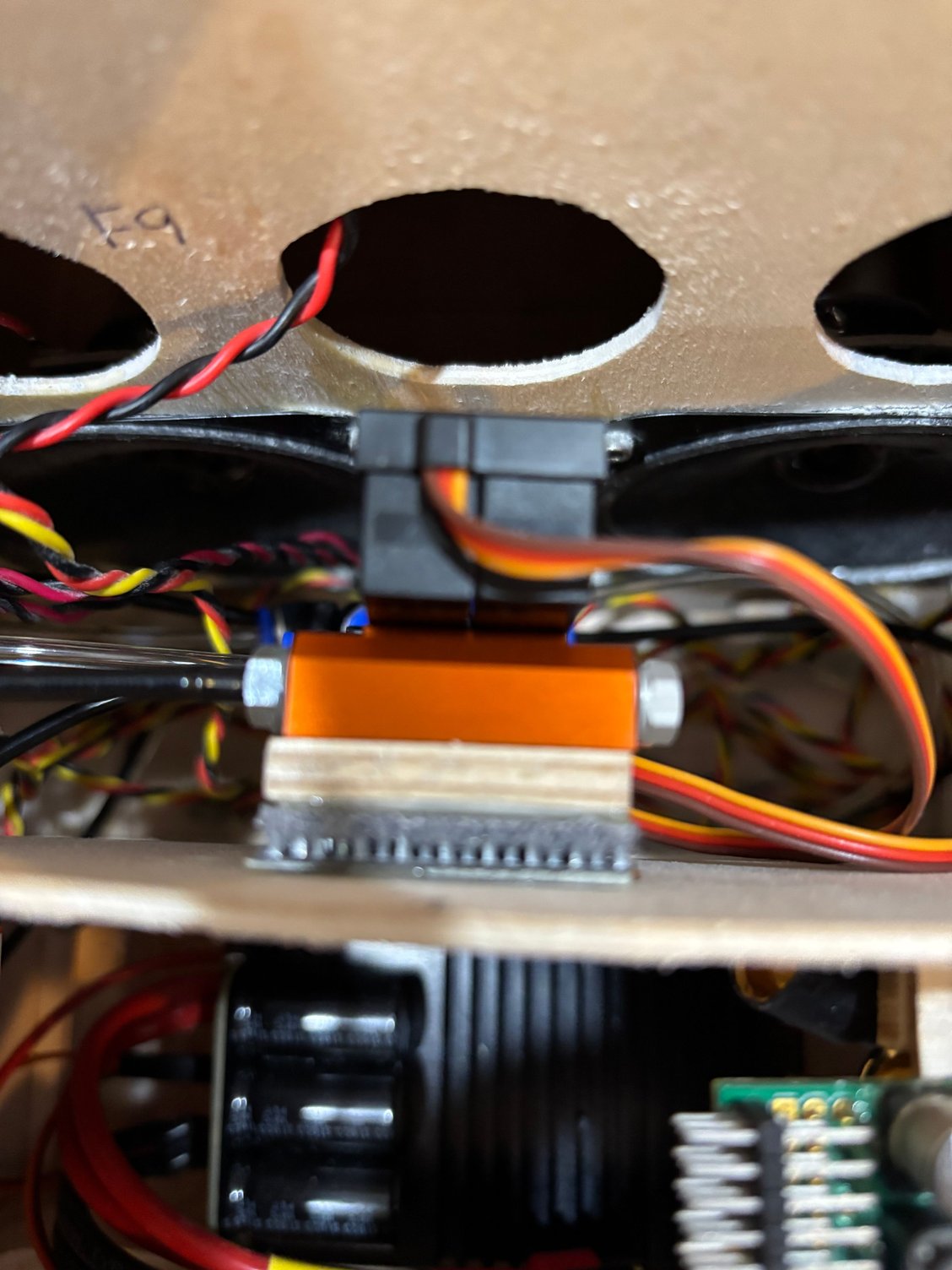

electronic air valve for gear doors mounted with velcro. the air fill valve and air pressure guage will go under nose hatch

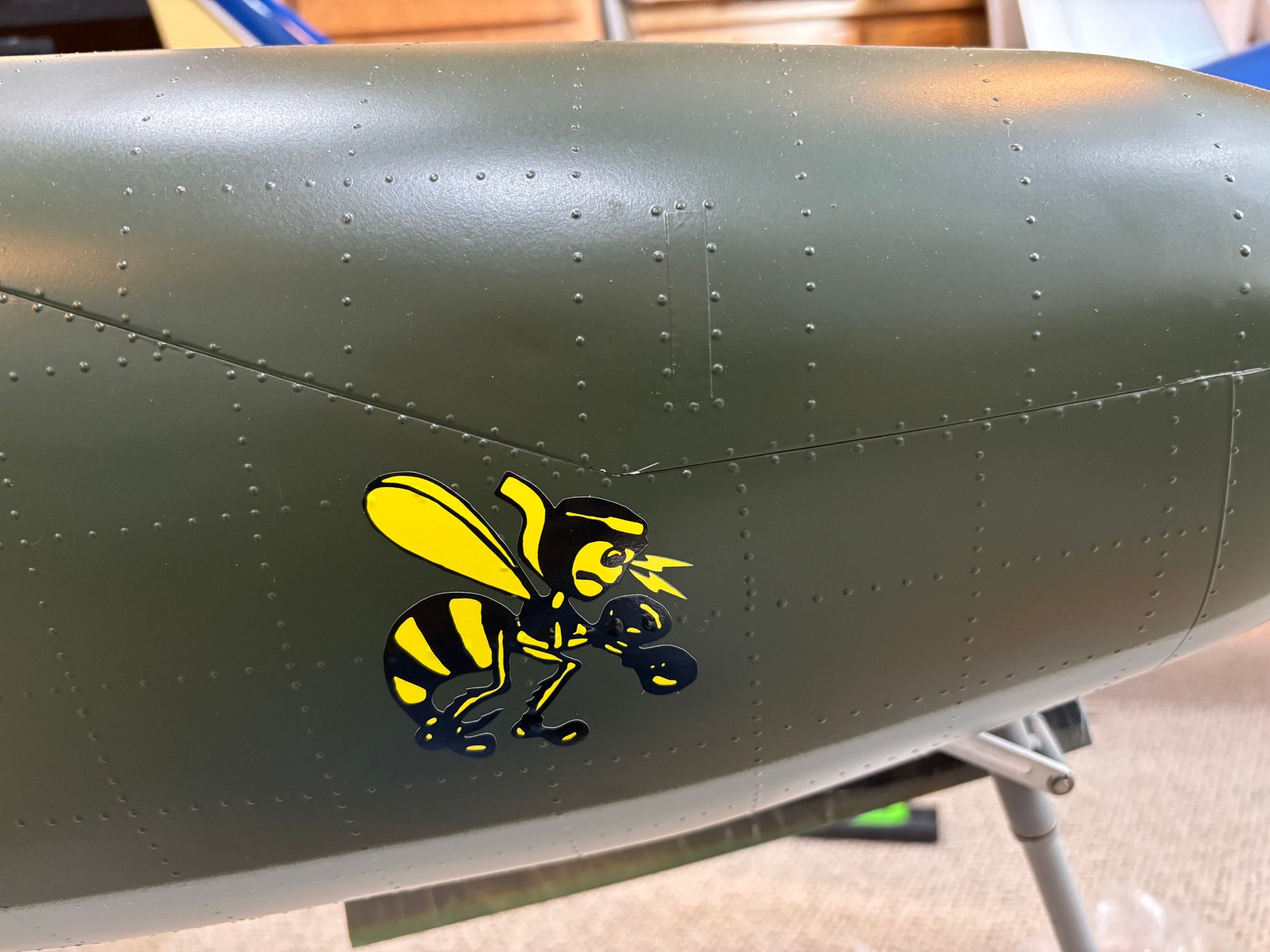

nose art
nose art

Thanks Chad, has been a fun project. Winter here in Minnesota, will have to wait for Spring to paint the Swedish roundels. Will start programming the Jeti radio gear soon to cycle gear and gear doors and program all 4 flaps
