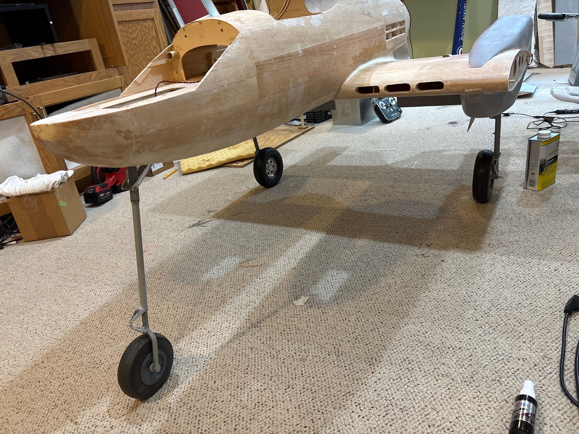

Designed and framed up by Dave Andersen. 1/4 scale and fully electric
Designer Dave
Old 02-19-2024 | 05:59 PM
Posts: 1,145
Received 70 Likes on 64 Posts
From: Eden Prairie, MN,
Electric powered motor = 200cc. Custom electric retracts by Robart. 7 and 5 inch wheels respectively on mains and nose. Sound system from Model Sound Inc with 4 inch speakers generating DB605 engine noise

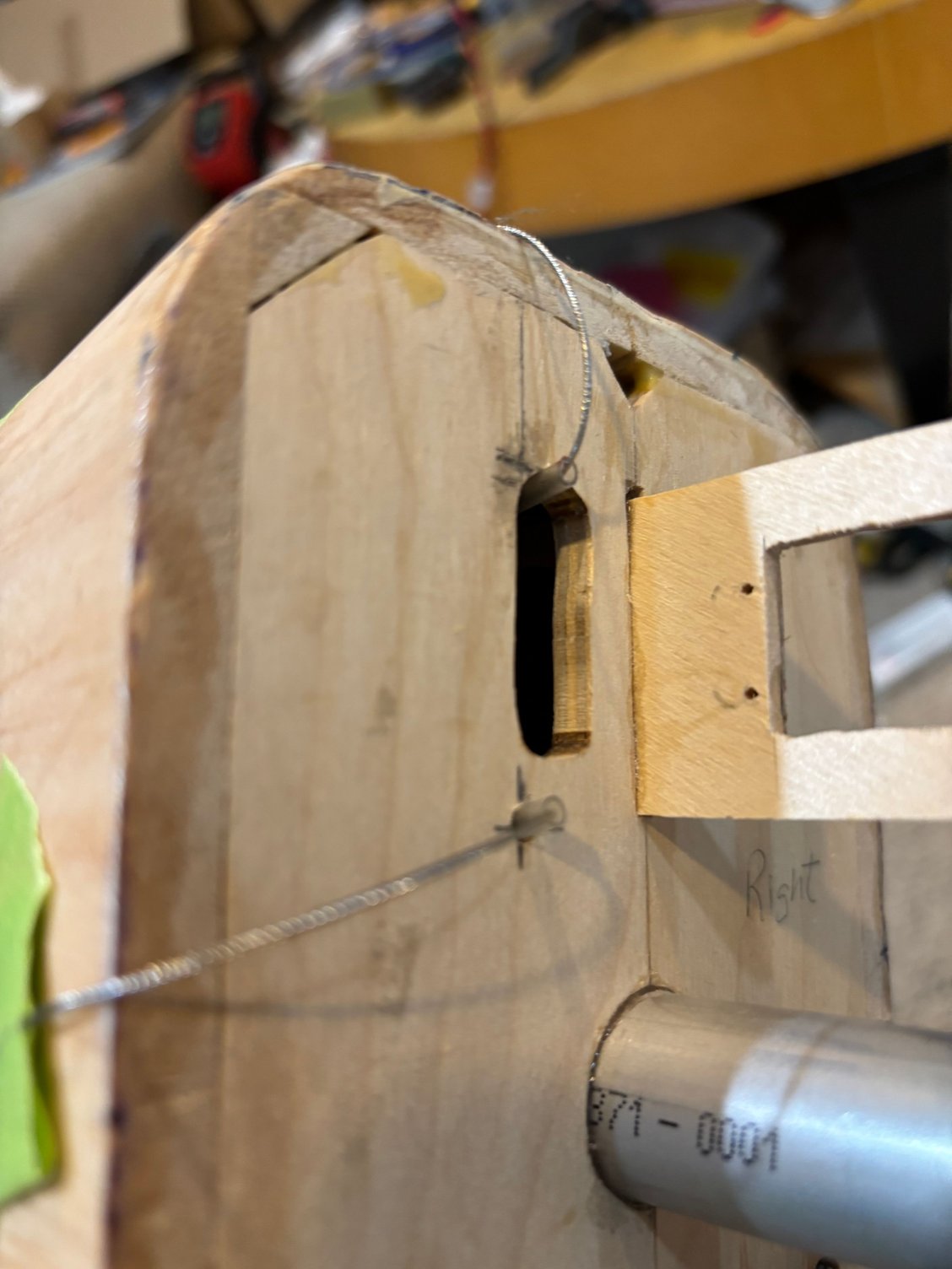

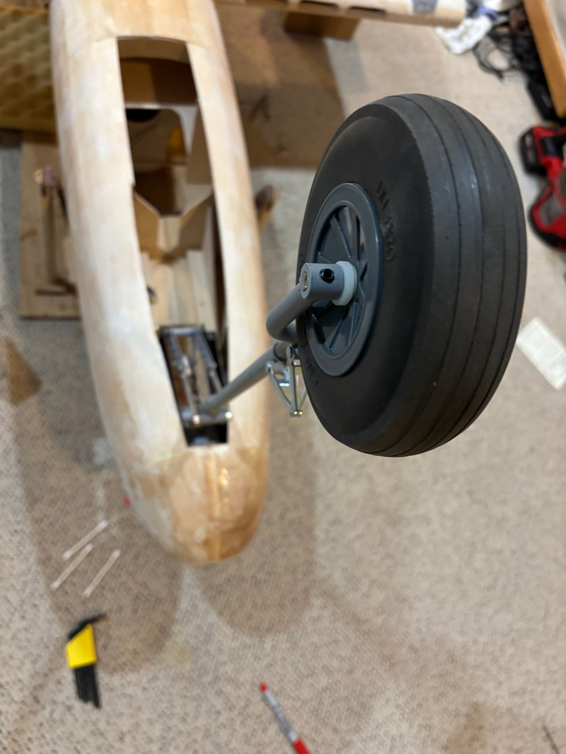

Nose strut

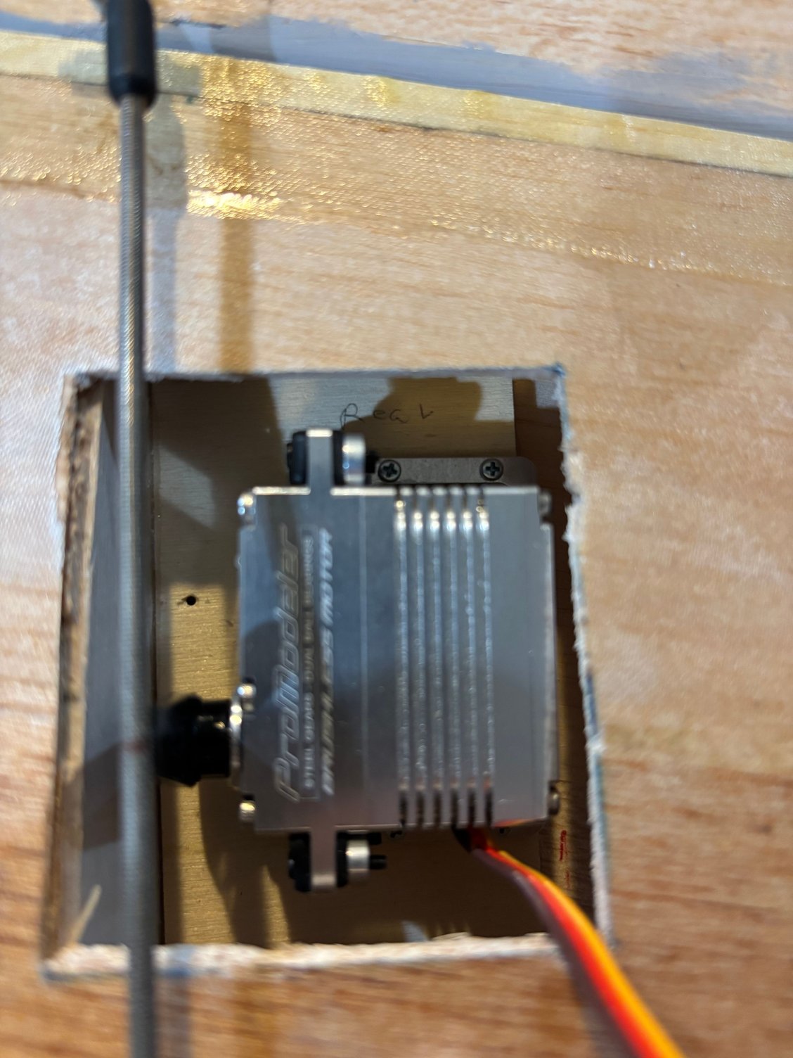

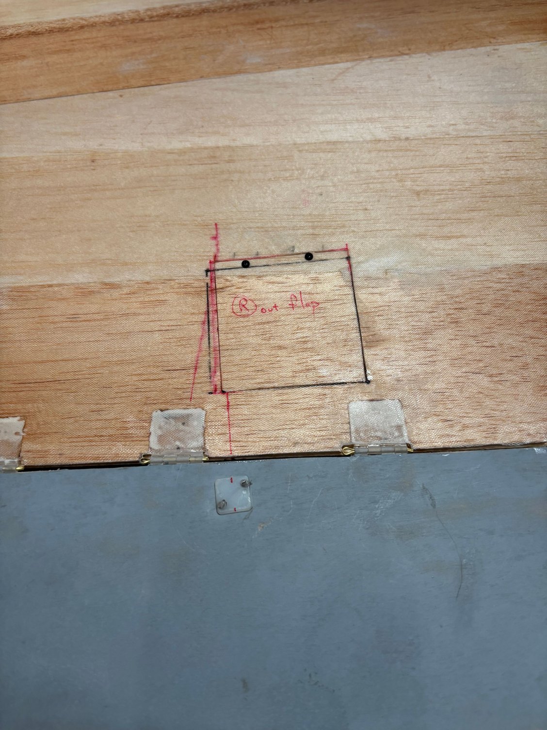

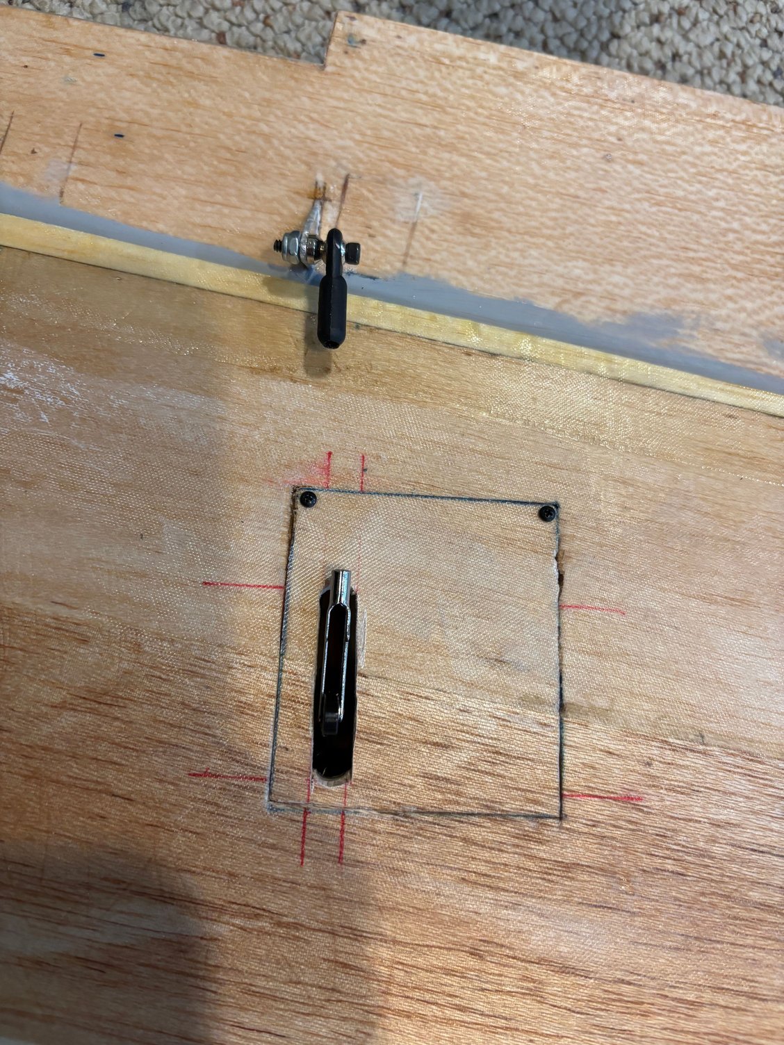

First flap servo installed. All 4 flaps have hidden internal pushrods

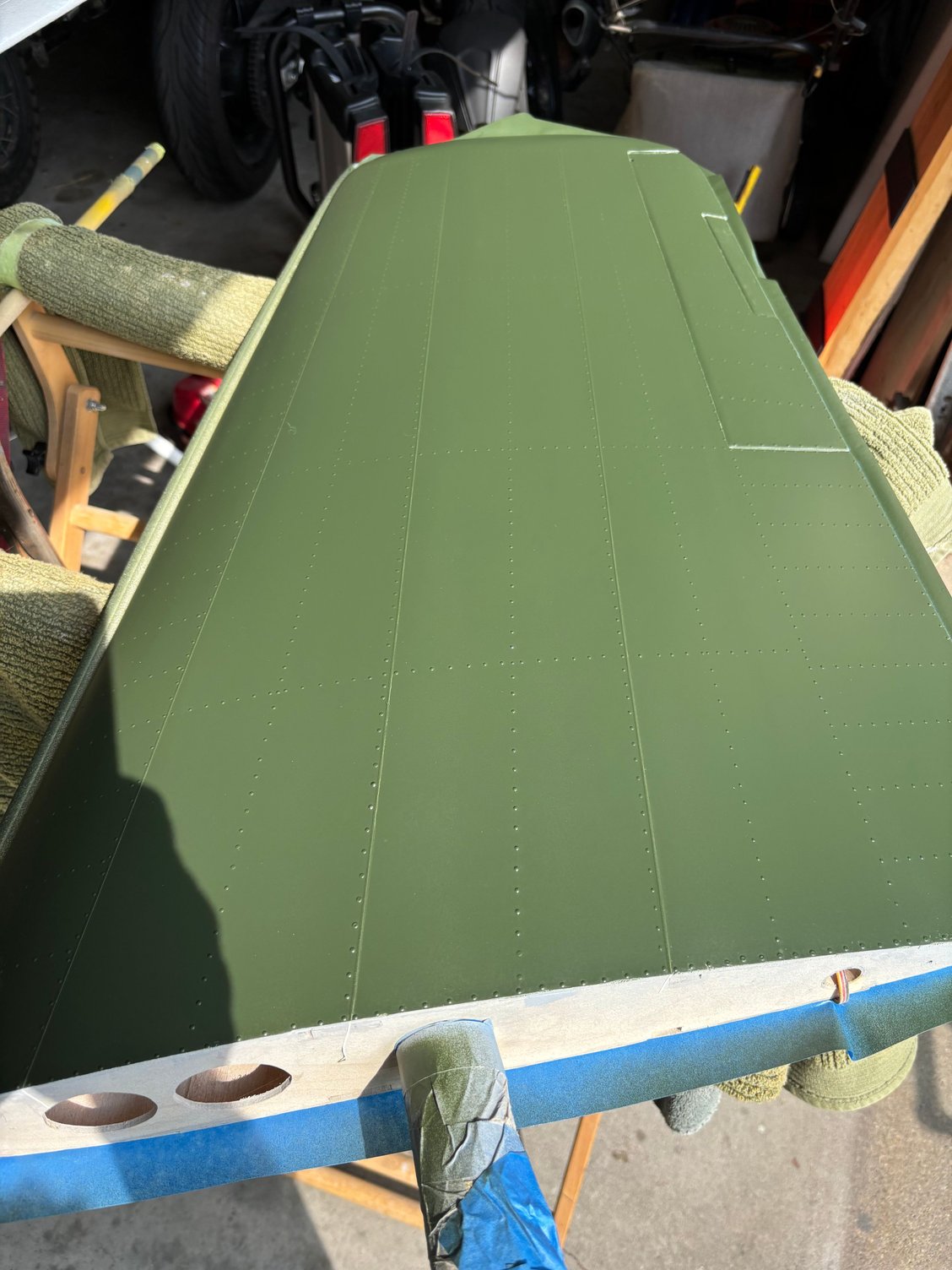

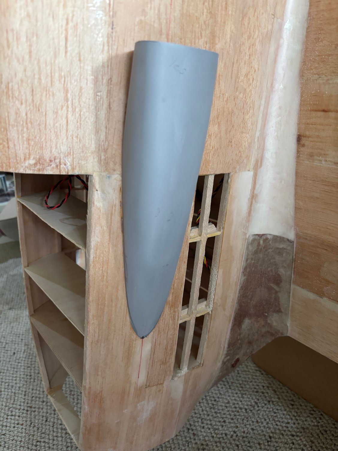

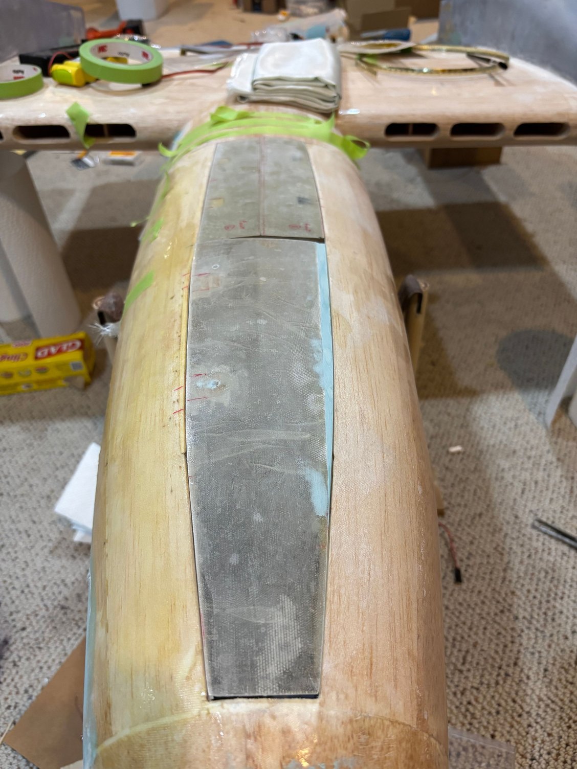

Air scoop mounted. Starting to put primer on wings

5 inch nose wheel mounted

Inboard flap servos mounted

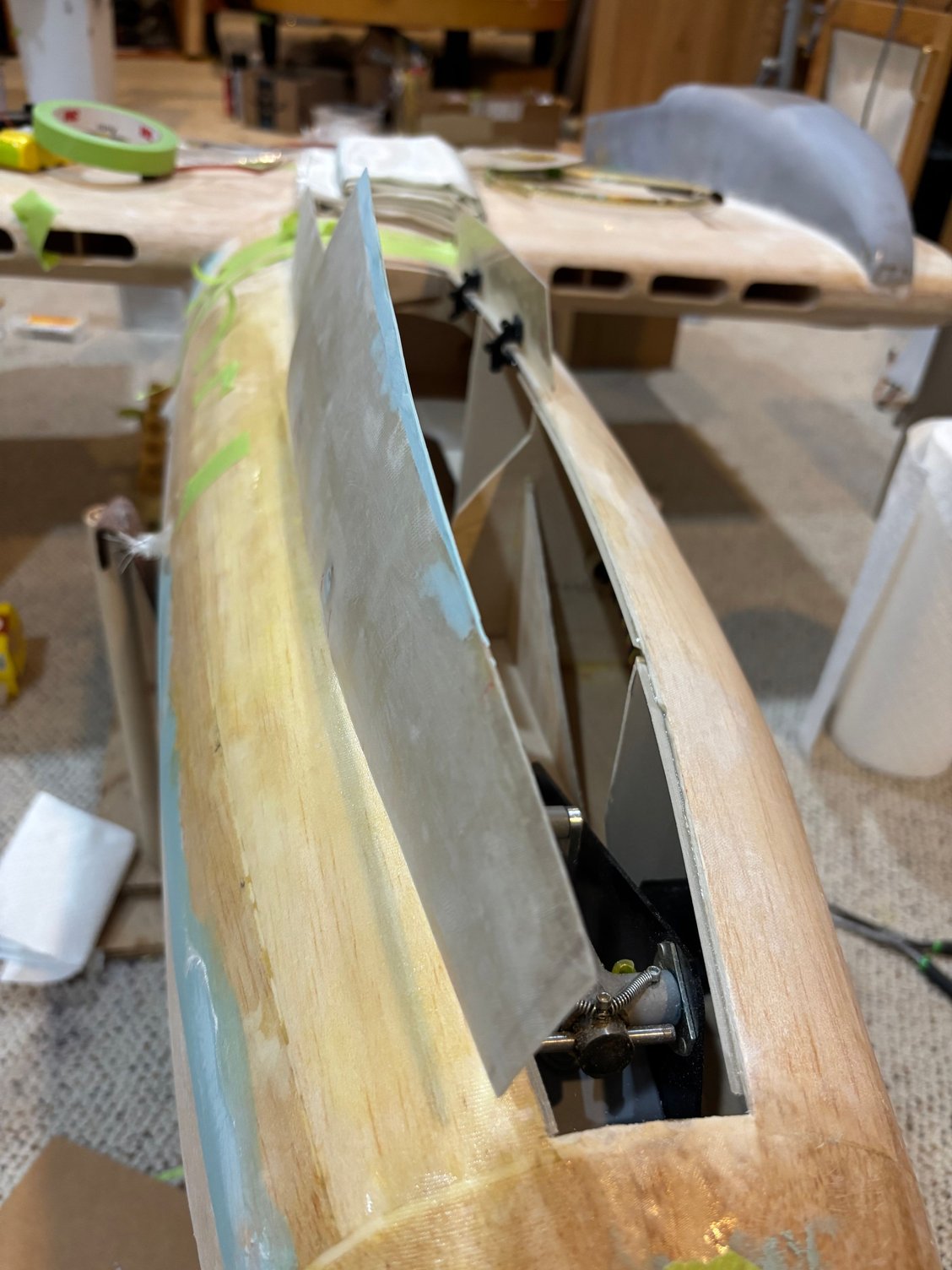

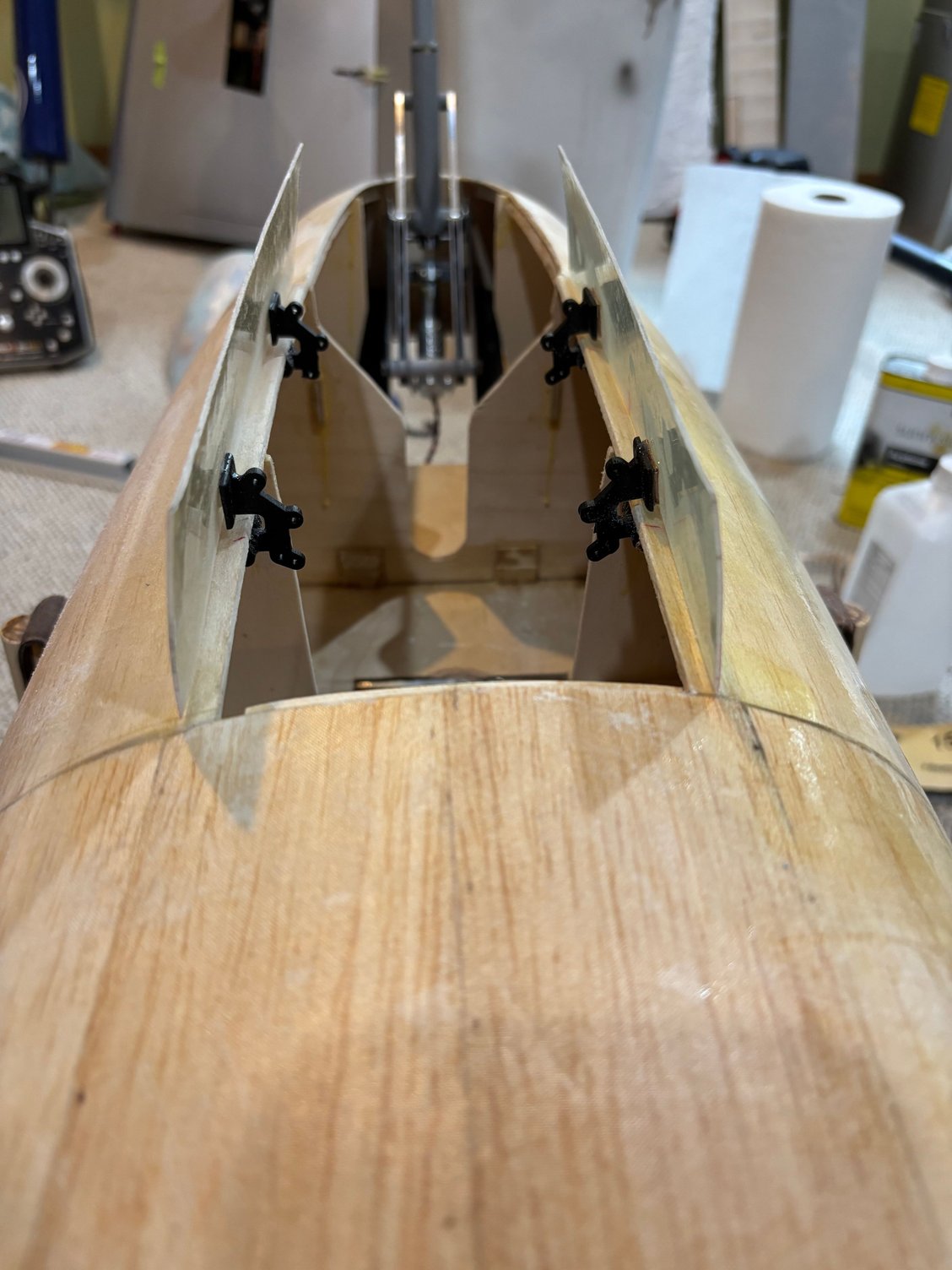

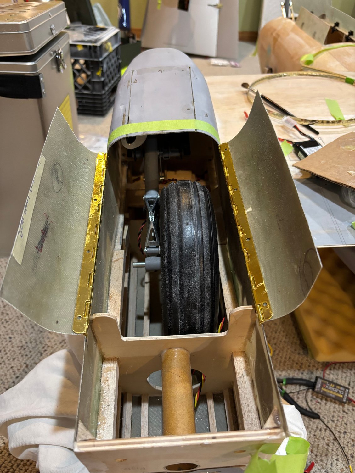

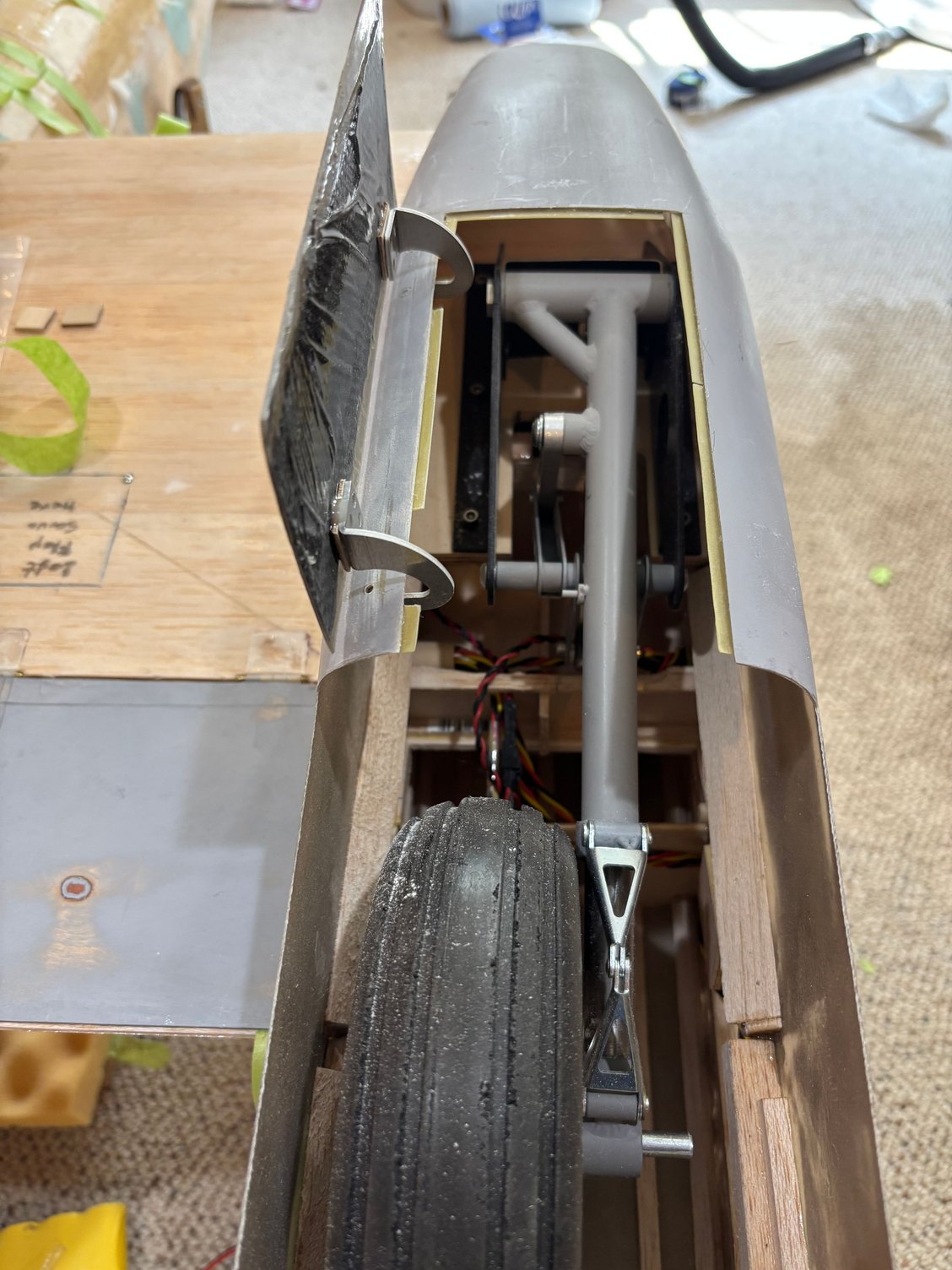

Clamshell nose gear doors done
Old 06-06-2025 | 06:02 PM
Posts: 1,145

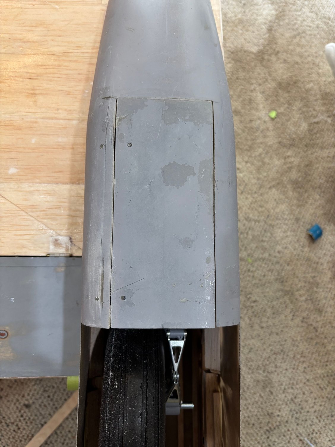

Front nose gear door mounted

Left front main gear door done. Like original, offset hinges allow wheel to move without hitting gear door. Only 5 more gear doors to hinge

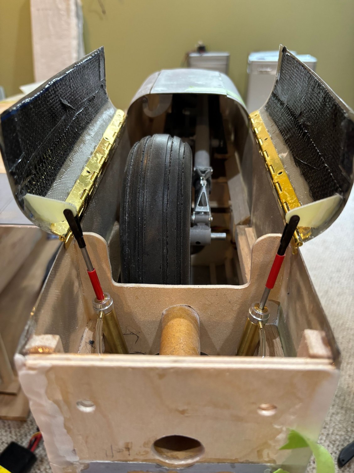

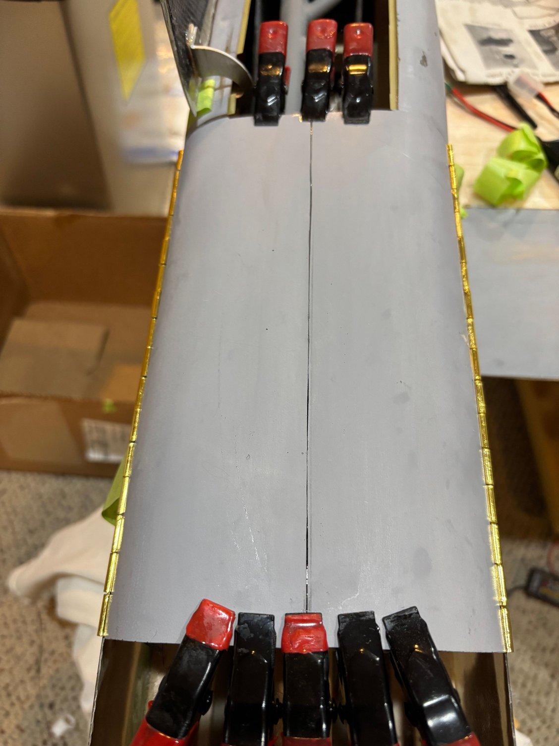

Clamshell doors over mains done

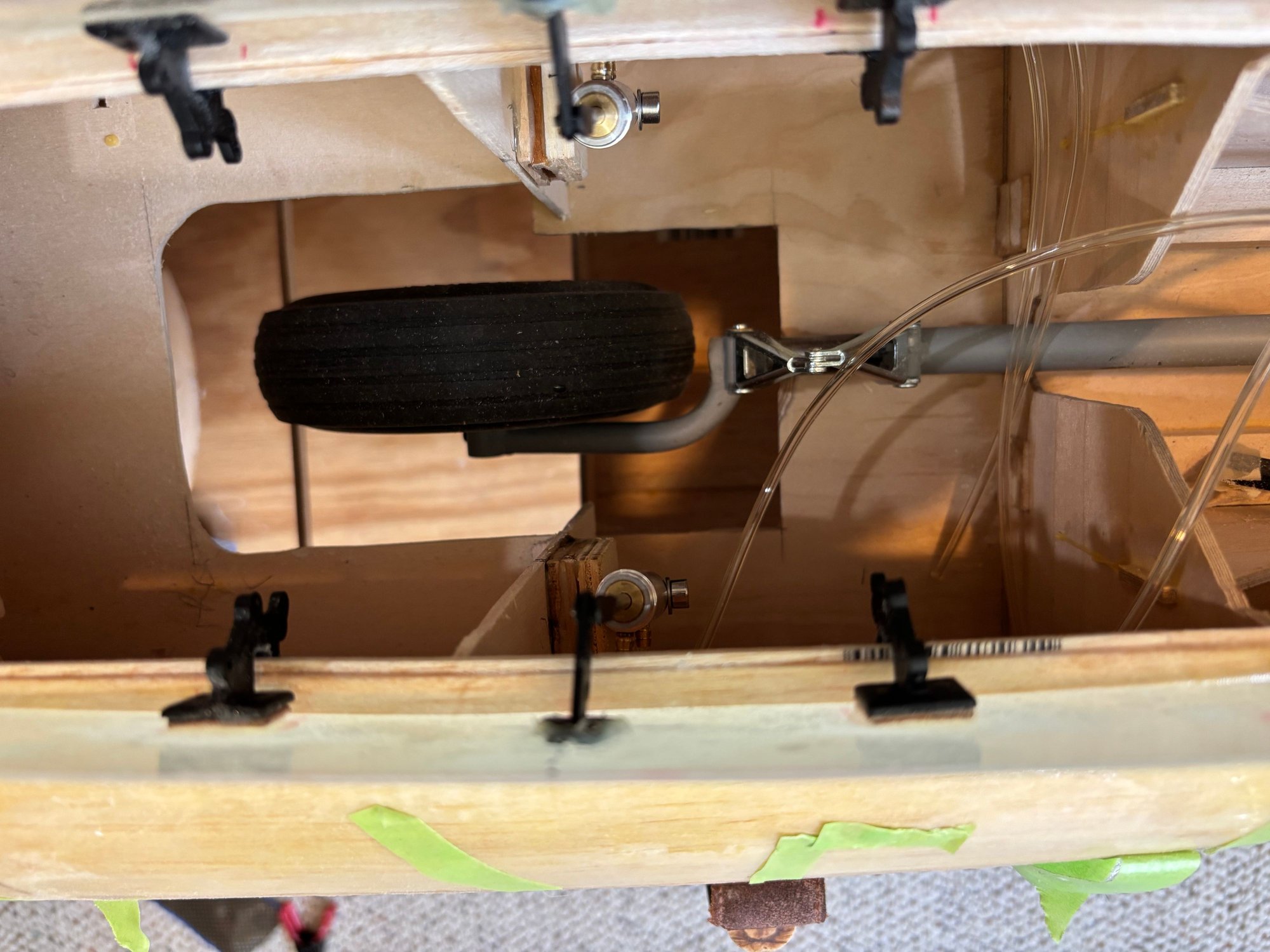

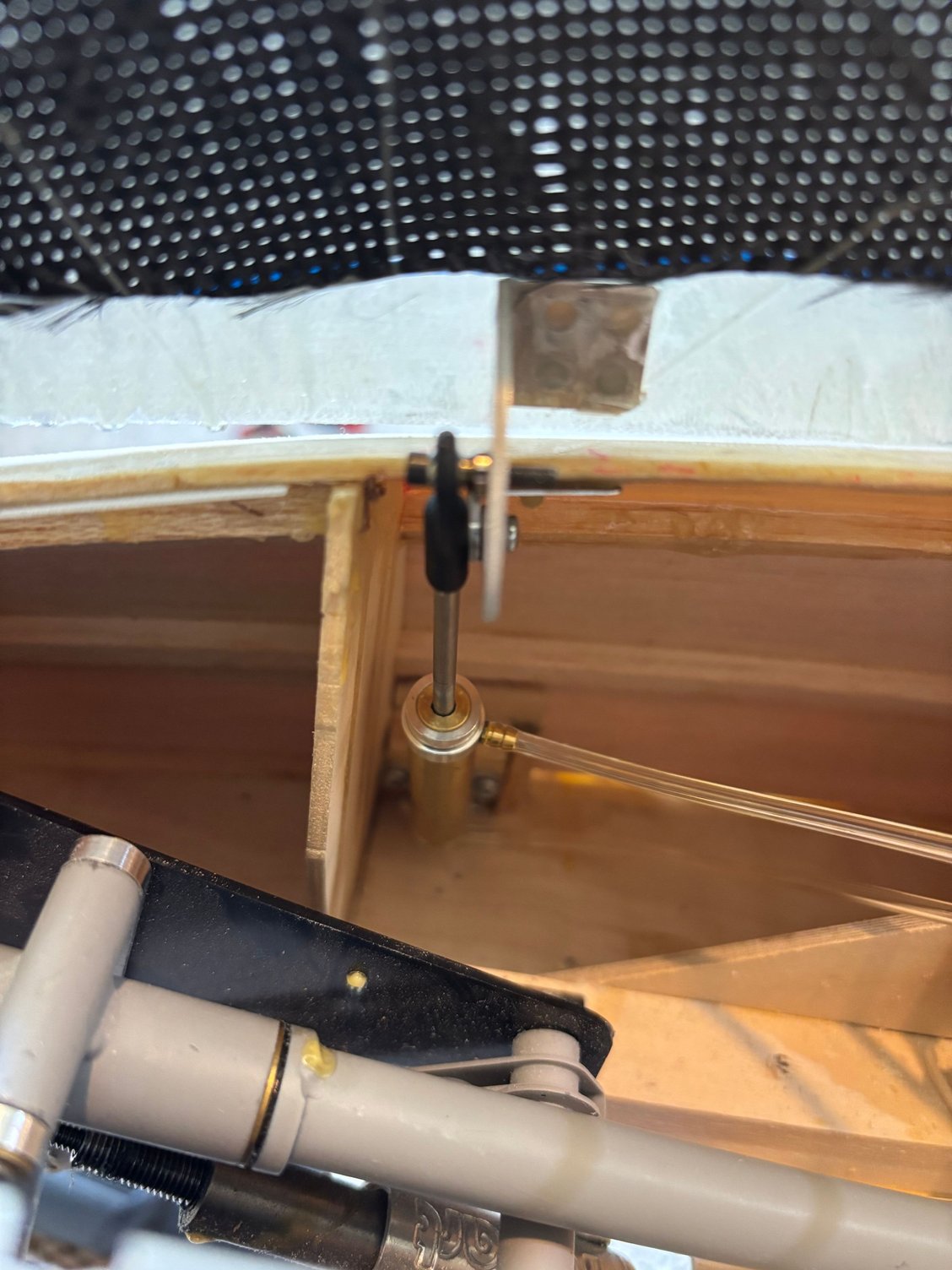

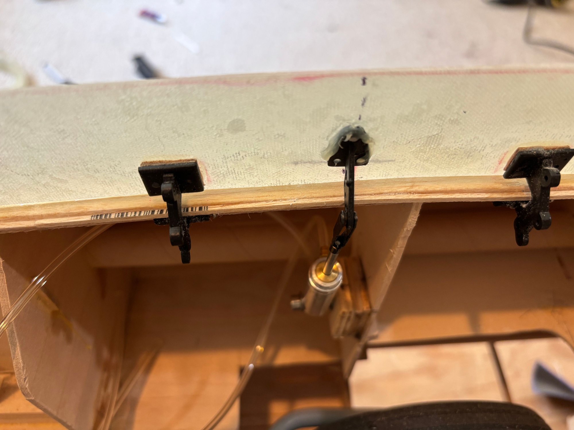

Nose gear clamshell door air cylinders installed

Front nose gear door air cylinder installed

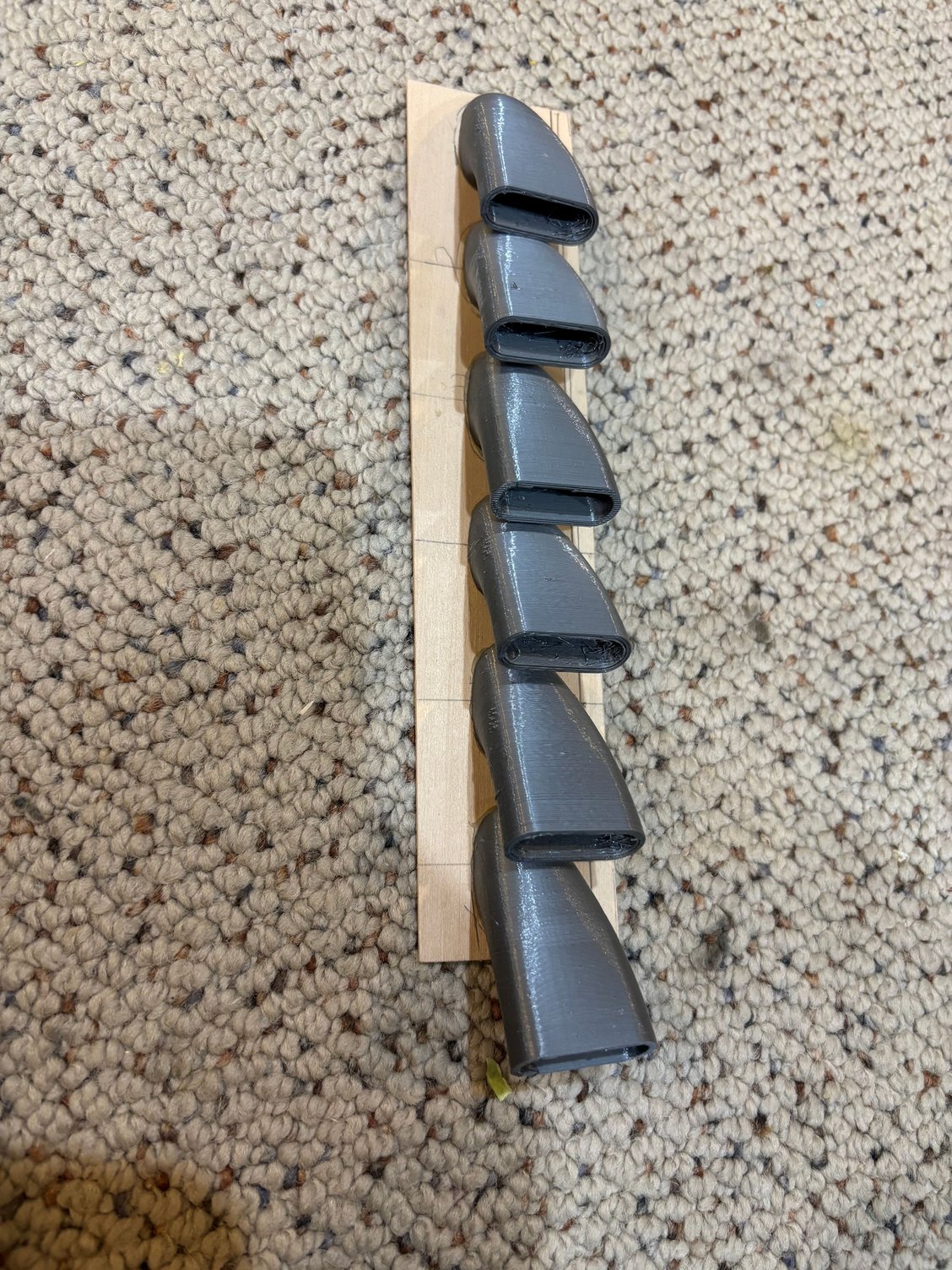

left side exhaust stacks, functional in the sense that air blowing over the speed controller can egress thru the exhaust stacks.

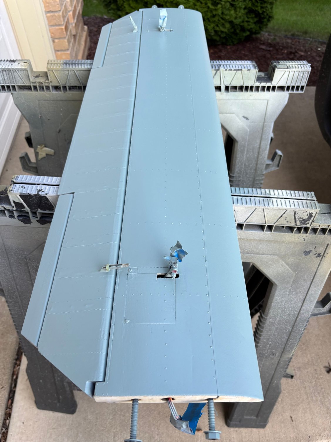

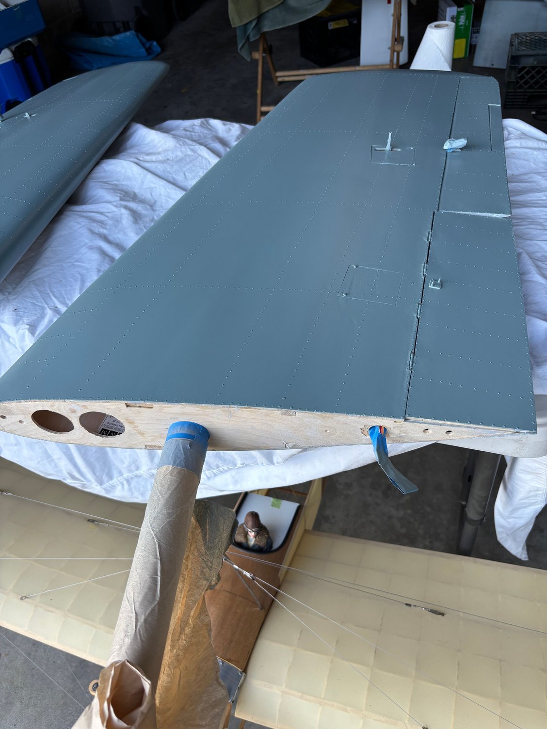

right outboard wing
right outboard wing

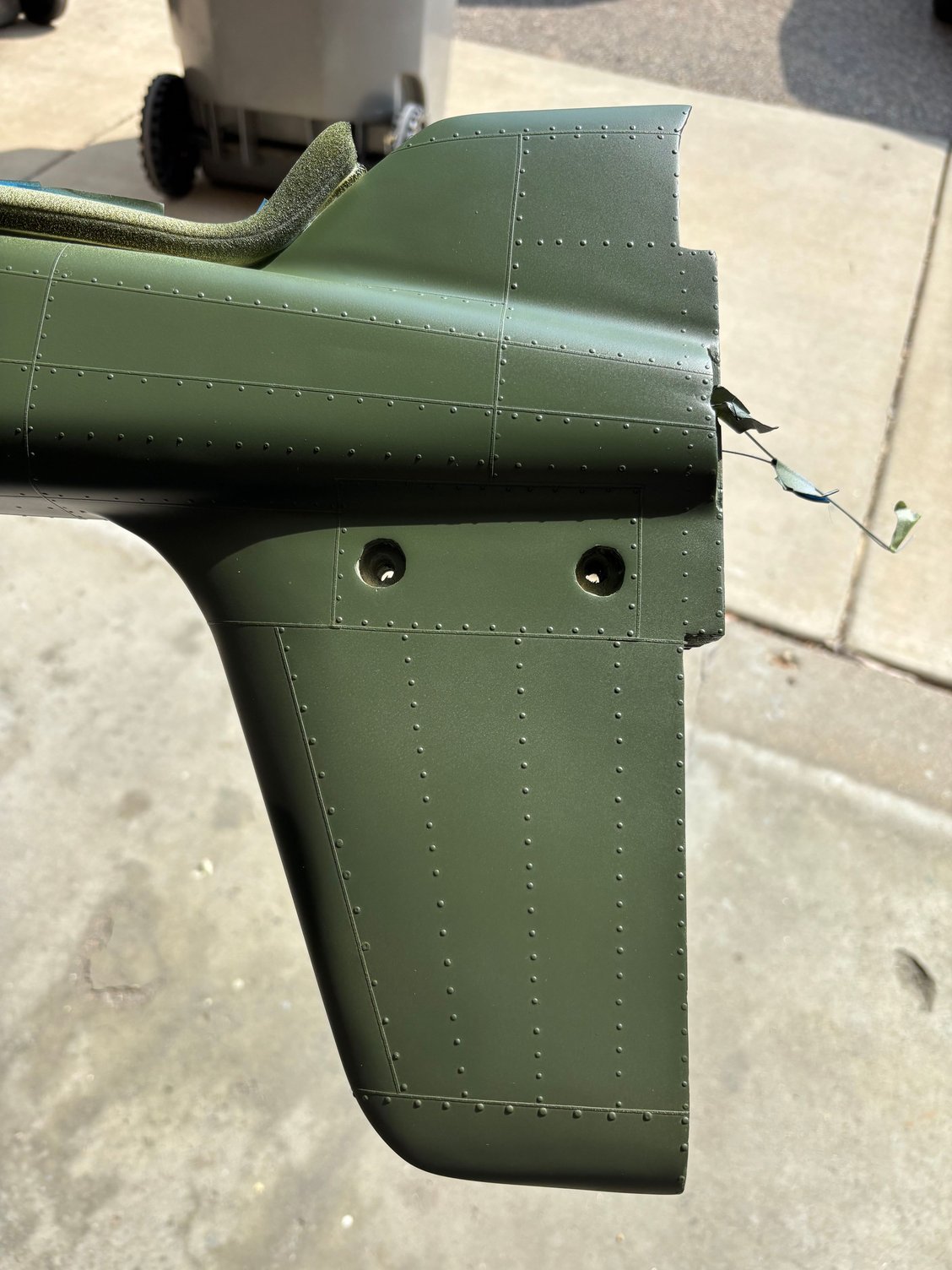

right vertical fin
right vertical fin

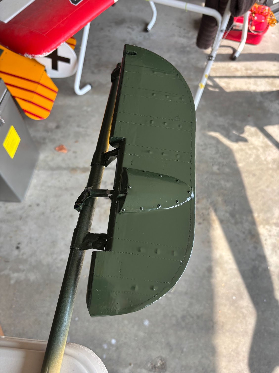

rudder
rudder
