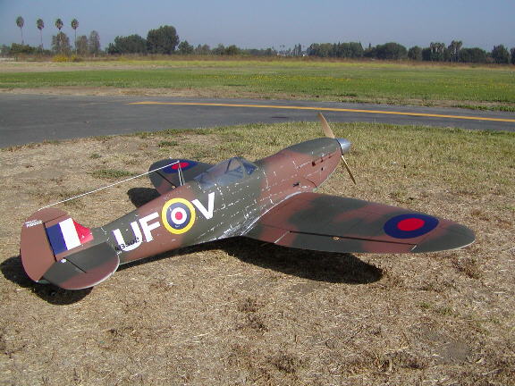

I'm about to test fly my GiantScalePlanes Spitfire MK II with a YS 110. The building of this ARF was straightforward, especially with hints from the RCU Mag article. However... After mounting my motor, I'm a bit perturbed by the incredible incidence of Down and Right thrust built into the Firewall. Without any washers, mounted straight on (the firewall), the down thrust and right thrust seems a bit extreme.. maybe 5 degrees and 5 degrees... (sorry, don't have an incidence meter to check) Anyone have this kit? Does it fly well with so much correction? Am I just getting old? Should I zero-zero and start from there?
Any comments?

I've taken out my washers to correct for the extreme downthrust and now I'm back to GSP specs on the down. I think what bothered me the most is that when I fitted the cowl flush with the 3 1/2" spinner backplate, the whole nose of the plane looked visibly crooked to the right! I've cut the right thrust in half and will see how she flies. (I'll be ready to change it back if flying needs lot's of trim...) I've read lots of threads here in RC Universe on thrust angle and guys seem to be very emotional on whether or not it's important... As a full size pilot, I'm very happy to have trim tabs on my controls and I think I'd like right and down thrust on my models.. the question is, how much?

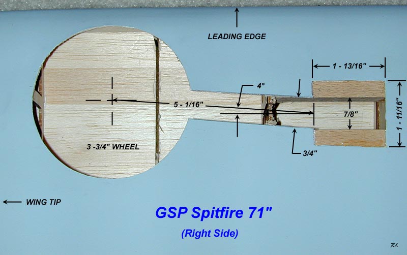

I'm getting close on my Spit. I'm waiting for a set of custom pneumatic retracts with 1/2" diameter oleo struts from Century Jet. The wheel wells have been enlarged to take 3-3/4" diameter wheels.

Great looking Retract.. How much were they and did it come with the bend or did you have to bend it yourself?

Hey Richard.. Could you take a photo looking straight down on the front of your Spit from mid canopy to end of spinner? Just want to see if yours has a noticible "right" bend from the extreme right thurst built into the firewall... Mine looks a bit weird...

I sent Bruce at CJ a very detailed diagram showing all the measurements, and he just made these retracts to my specifications for $250. The struts come with the bend, and they were bent forward 4° by CJ just as I specified. Note that on a stock wing, the struts are bent forward by 5° (this is true for other Spits too). Since I enlarged the wheel well openings to take larger wheels, the center of each wheel well got shifted back a little, hence the 4° bend.
I will take a photo looking straight down on the front from mid canopy for you. My nose is slightly tilted to the right too, but it's not too bad since I aligned the right edge of the cowl to the right edge of the spinner.

Anyway... I liked your diagram you sent to CJ... very clear and straightforward.. you are a precise builder...

I took mine up for its maiden flight today, and you were right, the plane had too much right thrust. It took half of available left trim and all available down trim to get the plane to fly straight and level at half throttle. This plane was very fast at half throttle, and it flew great. It was a floater on landing, even with full flaps deployed. I came in with one or two clicks on the throttle and 30° flaps, but the plane still came in like a rocket. I think I can chop the throttle a little bit earlier next time. The plane had no tendency to tip stall at low speed while I was trimming it out up high. I will do a stall test next weekend. Here are a couple of pics taken after the maiden flight:

And... speaking of right and down thrust. I ended up keeping the down thrust as per the kit, and halving the right thrust with spacers before the first flight. Again, flew straight as an arrow. You said you had to trim both left and up? go figure.

I have added a 1/16" thick strip of brass under the right engine mount against the firewall to remove some of the right thrust. Hopefully that will remove some of my left aileron trim. I will try to install gear door covers. The stock covers that came with the kit no longer completely cover the wheel wells since the wheel wells have been enlarged.
