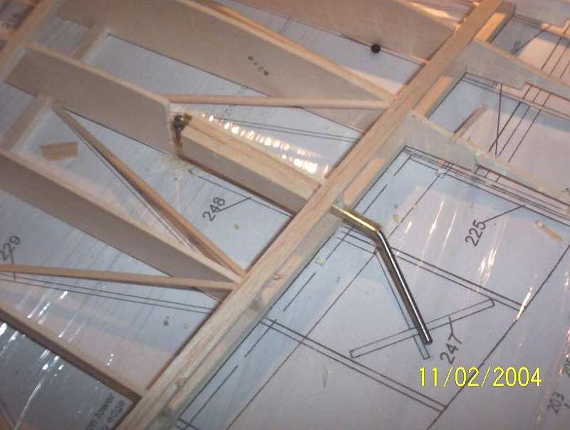

The gears if from unitract, great stuff. The build so far has only progressed to the left winghalf being framed up. Check out the crossmembers going from the wingtip to the wheel bay. Really adds some strength to it.
The wing has full inboard aileron and flaps linkages.

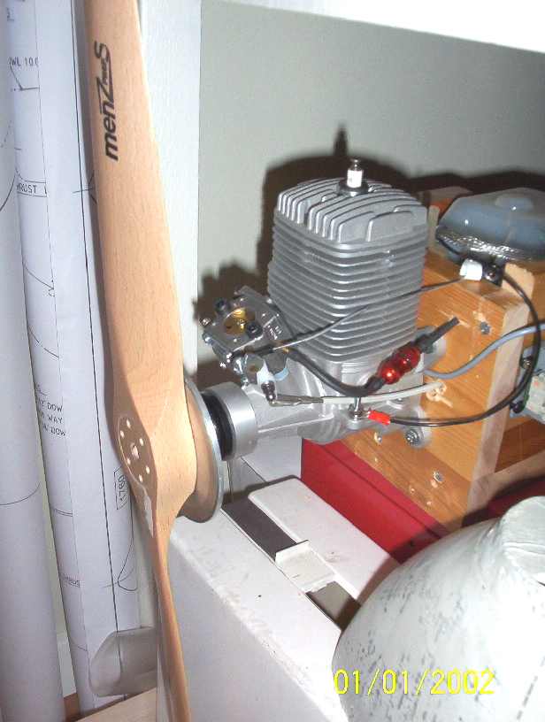

The engine is sold in the US from Rcshowcase. www.rcshowcase.com.
Don´t think u have the 45 cc version thou. Have read on RCU that some has been having problems with these engines, ignitions and so on.
But the retailer in sweden said he has sold 30 engines with only one being bad, put together wrong at the factory.
It´s now been mounted in the test stand, awaiting muffler from Bisson.
5 HP, will spin a 20x10 3 blade which should look really cool on the spit. But it´s a bit less effective thou.

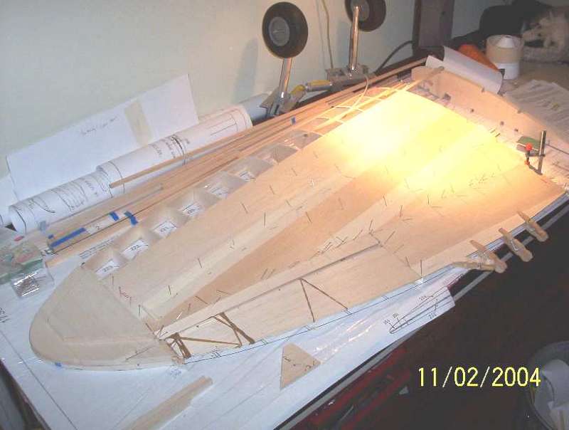

Have set up the aileron linkage. Mounted the big balsa blocks for the tips, which will require some serious sanding..
The tip has a plywood spacer in between the upper and lower tip block, should protect the wingtip from some dents.
The upper sheeting is in place except from the front upper bearer to the leading edge.
Doesn´t sound like much work when you say it like this thou.
well, some more pics. One of the internal link system. Tested it and it works really great. Totally slop free.
Its nice to se one wing half being closer and closer to finished.
