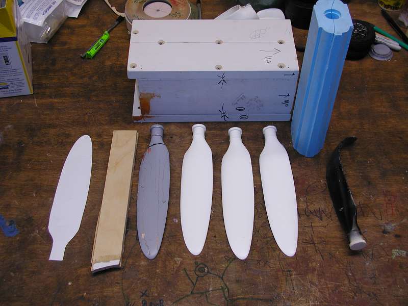

I am looking for hamilton standard 3 blade static props in 1/9th scale any ideas? I need four of them so I would rather buy them than try to make them.
Thanks,Wes

Most of the commercial offerings seem to be for 1/5th or 1/6th scale. I know that you are trying to avoid making your own but in that size carving one blade for a patern and casting 16 blades is not a big a project as it sounds. The other expensive option is to take some Bolly or other 3 blade carbon fiber props and grind sand fill and polish until you have a Hamilton blade profile. The dust from the materials is hazardous so that must be factored in. Or make one complete unit and cast 3 more from it.

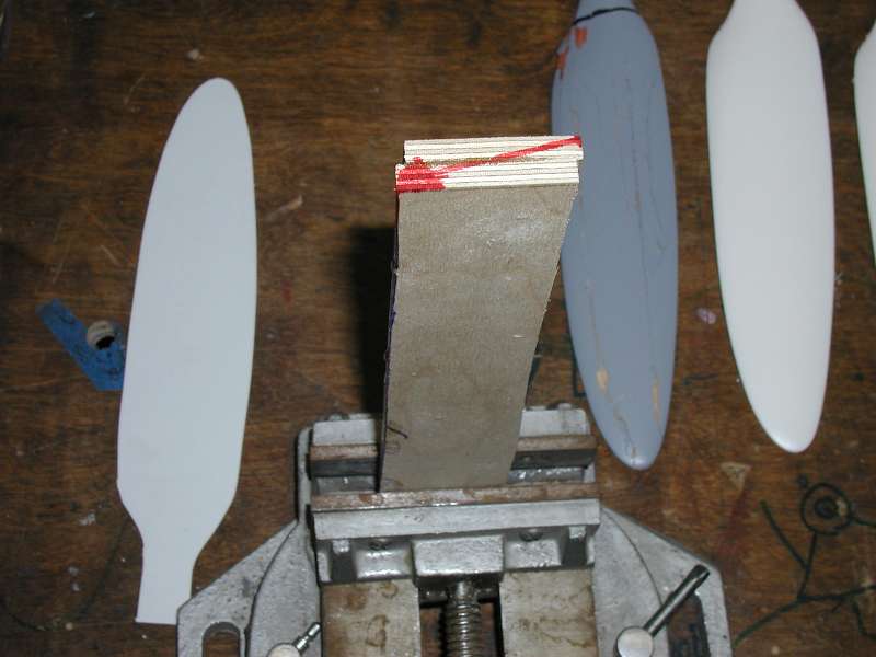

As mentioned before, It is not a big deal. Especially if they are to be static blades. All you need is a pattern of the profile shape, traced on to plywood thick enough to sand a "pitch" into. The use of plywood exposes the layers of ply to give a visual of what and how much wood you have removed to create a pitch.
Plus ply prime and fills fast and easy. This would create your master blade that you would pour RTV silicone rubber around, then use urethane resin to make all the blades you want. RTV silicone, small kit $20.00, resin,$20.00
Again, non flying blade just needs to have the right paddle look and not a functioning airfoil.
All the stuff you need you can get from Smoothon.com. Or seach the net for it if web site fails to hookup.
