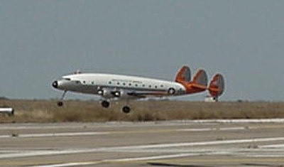

I'm wondering if anyone out there has any experience building Don Smiths Lockheed Constellation....I am presently finishing a Ziroli B-25 (101") version with about 4 weeks worth of work to complete this airplane. I already have the plans, glass and a cowl to find an engine that fits in relatively well.The Connie will be made into a "MATS" military version and should roughly be 140" with the tip tanks.G-23's seem to be an ok fit and they fly his B-17 quite nicely.I'm not at all impressed with the Century Jet gear set-up as it isnt very scale and the struts have very short shock absorbing distance......By the way it will be the "1049" variant which is the longer version... Thanx...Bill...

TLH1o1...Do you know who's gear that Miguel used on his Connie...Looks like it "was" a gorgeous airplane....Dont like to see one go "down"....Bill
My Feedback: (81)
Well....to make a long story short, the wire running from the antenna to the computer board was seperated in the transmitter...so no antenna. I had heard this was a problem with 8UAP radios. Mine was one of them. I talked with Futaba and they acknowledge that they had some of the early 8U radios go out with cold solder joints in this region. I was introduced to this problem by 3 other guys in Texas that had had it happen or had seen it happen in the past. Turns out my radio was in the "affected population".

Found these pics of Miguel's Connie, that were taken at Top Gun.
http://www.franktiano.com/Warbirds.htm
Miguel will be using Sullivan boat tanks mounted in the wings between the nacelles for fuel.

CONNIE MILITARY VERSION
I WAS STATIONED AT PMRF B/S KAUAI,HI STSTER SQUADRON OF POINT MAGO CAL.
WE HAD THE LAST MILIARTY (NAVY) VERSION
ARE YOU GOING TO PUT THE SONAR DOME ON BTM OF FUSELAGE?
DAN MOFFETT
