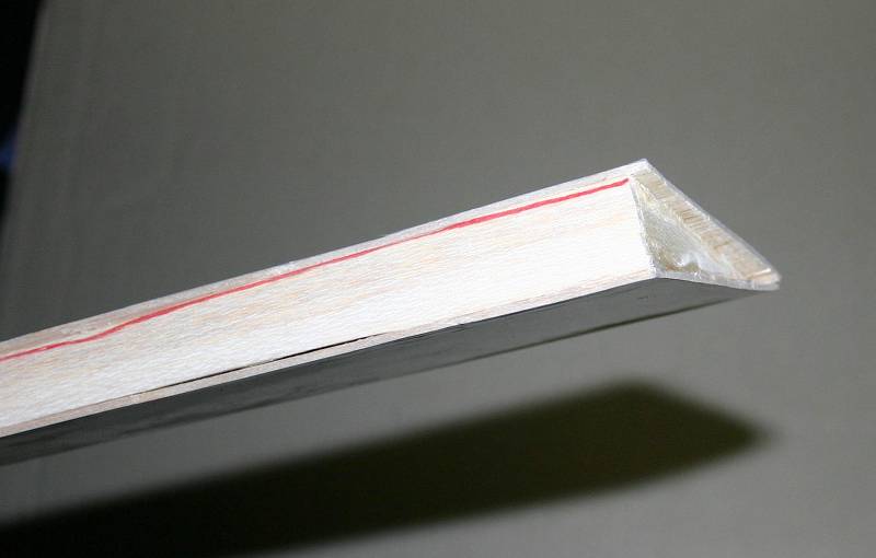

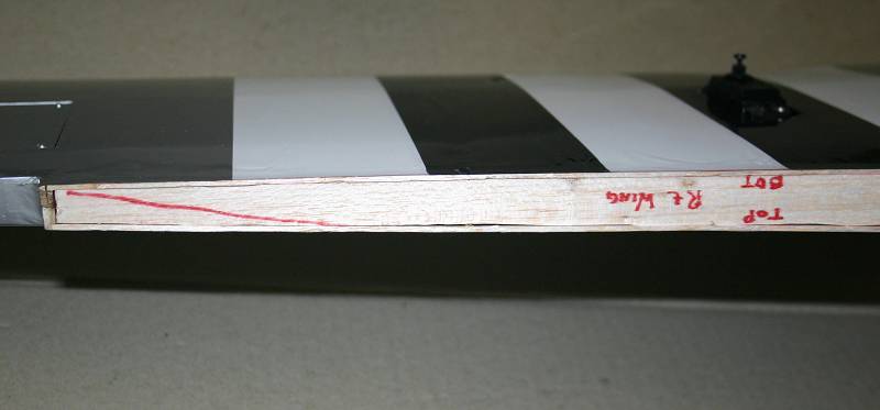

Now before cutting the lines I have to decide how to handle the bind point between the flap and aileron, and the flap and the wing caused by the angles of the hinge line and the sides of the surfaces. I’m making an every day flyer so looks don’t realy matter so I’m going to make the gap between flap and wing large enough to clear there and play the aileron to flap by ear.
The way we handled this on Bill’s P-51D and My Me109E was to make the top line “C” 1/8 in further away from the center of the wing where it meets line “B”. That allows for a nice tight parting line between the surfaces.
To cut the sheeting I used a razor and straight edge, concentrate on making sure the sheeting is completely cut. Then I turned the razor on the ribs pushing it through (about half way each side). You will break some if the ribs see the pictures instead of cutting them, that is bound to happen. For those just make sure you keep all the pieces and once the two halves are separated put each rib back together squeezing the sheeting between my fingers until I can zap everything back together and back to the sheeting. As long as we put it all back the way it was we wont change the AOA of the wing.

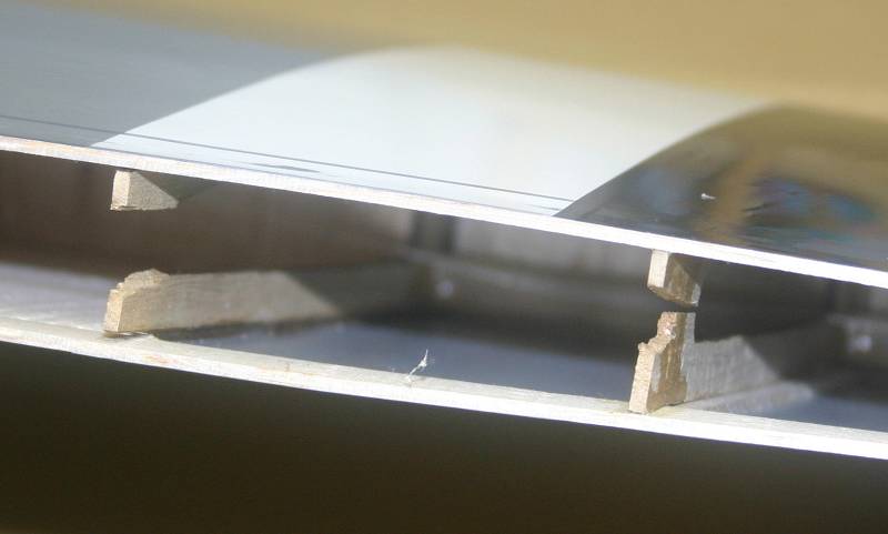

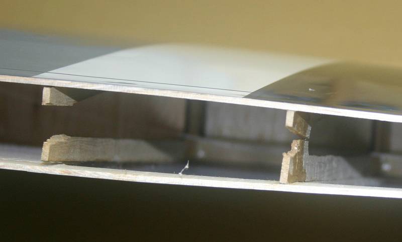

3105 & 3107 shows the typical wing rib damage.
3122 & 3119 Shows typical flap rib damage.
3143 flap rib repair, notice the rib tags are gone and the sheeting is glued back down.
3148 & 3150 wing rib repairs notice the missing tags have been replaced and CAed into place. Any cracks in the ribs have been realigned and reglued.

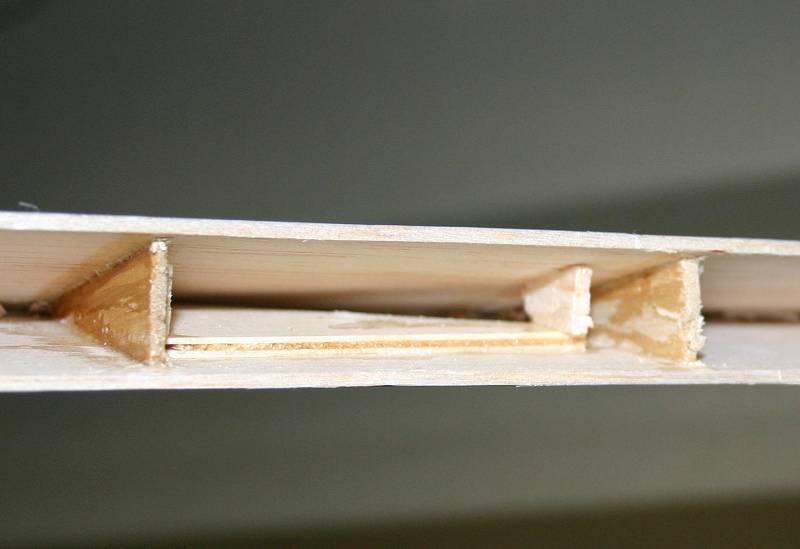

I removed the D-Day stripes from the top of the wing after looking at the momokote from inside told me that they were layed over the gray covering. I pealed up the covering with an x acto to lift an edge and pulled it off. It pulled up very easily which tells me I’ll need to go over all the seams before flying.
When I opened it up (cut the flaps out) the rib thickness was a little thin. Plenty thick for its intended use but not thick enough to support a servo with all the center balsa removed(done at the manufacturer to keep it light). If it was 3/32 or thicker with the lightening with the lightening holes or a 1/16 with out the lightening holes that would be fine. So the way I will handle this is to run a peace of shear webbing from top of rib to bottom of rib just behind the aft servo mount. That will tie the two rib halves together and should provide a stable bond joint to stand up over time.

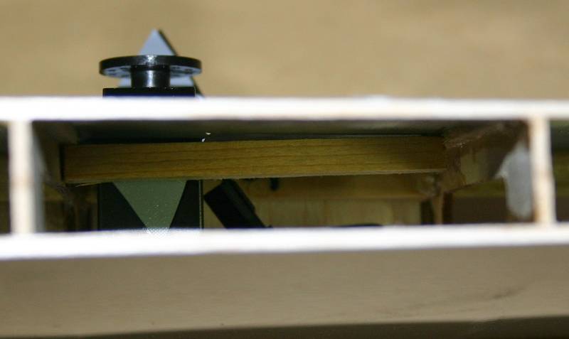

There are two types of servo attachments I can install once the rib halves are tied together, flush mount or in the breeze. Again, I’m building this as a dog fighter for next summer so I want it as simple as possible so I’m going to use “in the breeze” so Lets talk about flush mount first. The flush mount is going to look just like the aileron where the servo mounts to ply and that is screwed to a box in the wing. Both methods are built into the wing the same, I will install two hard wood rails between the ribs. One has the servo mounted to the rails the other has the ply mounted to the rails. So I make two rails per wing that are tight between the ribs where I cut the wing. I will mount one with glue to the main spar on the bottom of the wing. Then from the out side of the wing find the edge of the hard wood and layout the size of the servo on the monokote. This plane has D-Day stripes so I’m going to try to keep the servo in the black stripe. So I’ll cut diagonals across the square I made of the servo’s size on the monokote.
Put small amounts of masking tape across the ends of the diagonal cuts to keep them from tearing any further. Place the servo in the hole cutting the monokote to allow the servo ear to rest against the rail and screw it down to it.
Push the other rail up against the servo after gluing a balsa 1/16 spacer to it. When everything looks good glue it in place, screw the other servo ear to it, if you need to use this to hold it in place that’s ok also. Once the servo is mounted to both rails, the rail is glued to the rib and the compression strips are installed remove the servo and the 1/16 spacer. Carefully fit peaces of ¼ balsa between the hard wood rails on either side of the servo, then iron the monokote to the rails and balsa then reinstall the servo.

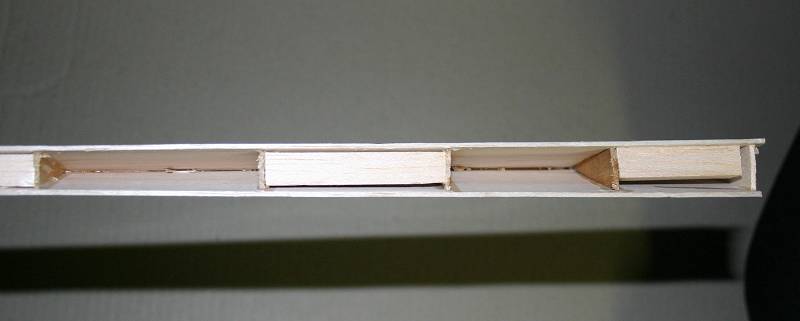

In my case one of the black D-Day stripes runs adjacent to a rib so I will be mounting the servo right next to that rib. It is also the reason for the bay I chose for the servo. Either bay next to this one is also adequate for the servo bay (for that matter any of the bays are acceptable). The limiting factors are servo lead lengths and driving the flap at its center.
3616 & 3618 – Shows the front servo mount which is mounted by pushing in place and Caing. The Caing is accomplished by dropping the glue in place or polishing a pushrod putting one end where you want the glue to do and running the thin CA down the rod.
3647 – servo front screwed into the forward rail, with covering X – cut as described earlier.
3651 – shows the aft servo mount before the compression strips.
3658 – How I hold the pieces in place.
3664 – aft servo mount after compression strips.

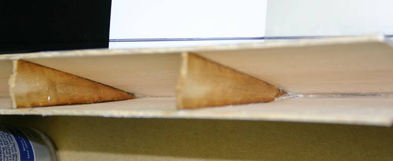

Included here are pictures of the hard point for the control horn. There are two ways to do this conventional and with expanding foam, I prefer the expanding foam but most people do not have the experience to do it. So I’ll describe it first than do the conventional which is what I will use on this plane. My reason for using the conventional method on this plane is that the TE of the flaps have a gap between the top and bottom sheeting instead of being glued together. If the foam gets between the TE and the covering it will bubble out. So the pictures of this are from Bills plane which is a H9 ARF P-51D.
The two part foam is available from tower I’ve inclused a picture of it. I cut and glue in the ply (and use marine ply, not lt. Ply), marking the covering side for where the ply is. When the flap is all buttoned up drill two ¼ in holes in the flap end cap bay to fill with foam. One hole is a fill hole one is a pressure relief, never pour into the pressure relief hole. If you plug both holes the pressure will blow the flap apart so it is good to practice first or get someone with experience to help you. Anyway as the compartment fills the foam will start to come out of both quarter in. holes. Leave it and let it harden, the next day the overflow will cut right off easy.
The conventional method is to put the ply down then put balsa between it and the top flap sheeting not much is needed, I used scrap from around the shop I believe it is 3/32. When putting the ply in you have to know where the hinges are going because if one is going in the same bay as the control horn the ply has to be pushed back to allow the hinge block to glue directly to the bottom sheeting. I’ll explain why it is ok to put the hard point so far aft later when it is time to hook up the linkage.

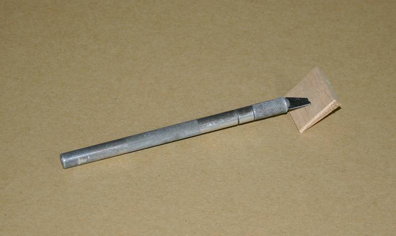

Using an X-acto knife and razors I shaped the wing TE cap and flap LE cap to fit into place. A final sanding was used to make sure it fits correctly. The end cap needs to fit with just enough force to hold it in place while the wing is held LE up and TE down, or the flap held TE up and LE down. If you tap it while in that configuration the end cap should be loose enough to dislodge or drop out. The purpose here is simple; if it fits tightly it will deform the sheeting and ruining the seam between the flap and wing. It must be inside of the top and bottom sheeting, no part of the end cap can extend forward of the LE of the sheeting of the flap or aft of the wing TE. Also when removed the open end of the flap spread ( this is the end closest to the root) this is typical of thin wood like I have here (not the case with the H9 and Kyosho). When you look at the flap end caps notice that there is a gap to the sheeting, this is the only area I plan to squeeze the wood to CA it. Accepting there will be some miss match there.
Joe

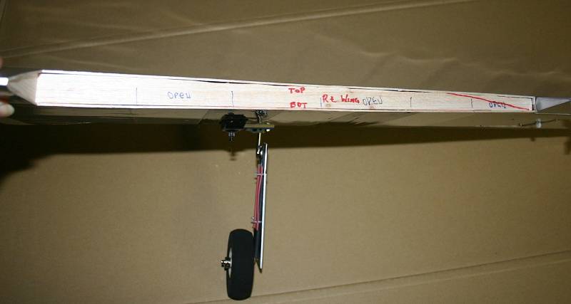

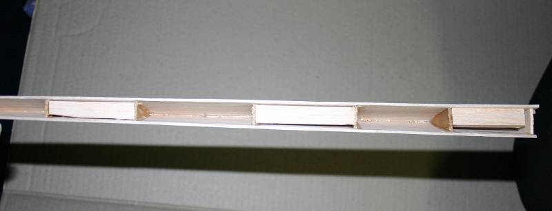

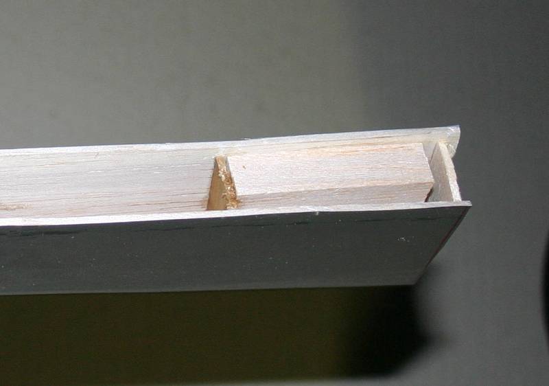

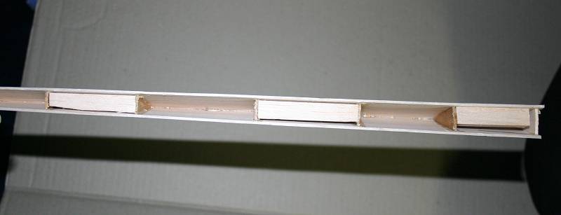

To put the hinge blocks in I had the ½ inch thick balsa wood left over from the me 109. I cut it into ½ x ½ strips and from those fit blocks between the ribs and flush with the bottom sheeting. Then removed the blocks and sanded them to be flush with the wing and flap end caps. The top and bottom sheet on the open end of the flaps spread when I cut it free of the wing so when that hinge block was installed I had to hold it in place while pushing the flap against a flat surface.
On that same end of the flap I had to add end caps. I made the mistake of cutting corners on the Kyosho me 109 and did not put the end caps in on the flaps and the wing, they are both fuel soaked now because I did not close up the area and cover it. To do this right we must go back to when I measured the line. I drew both the top and bottom line at 3 inches from the root rib. The root rib is installed at an angle to give us the dihedral the kit calls for. That means the lines I drew for the flaps were also drawn at the same angle. This is the intended out come, because as the flap is deployed there are pinch points if the flap end is cut square.
Understanding that the ends of the flaps are not square is important because before I hinge the flap I’m going to cut a little of the end of the flap to give me room for the gap and monokote so if I square it up there will be a large gap on the bottom of the wing. You can see in the end shots that I left plenty wood for removal before I run into the end cap.
Joe

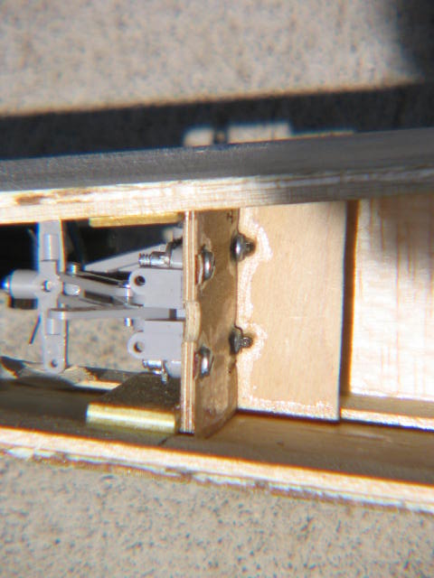

Well I’ve got a set of KMP retracts that I thing will be much happier in a 8# plane than in the 13# plane they were intended for. I want to run the air lines before I button up the flap area so I need to install the retracts to know where the lines will need to go. To install the retracts I need to open up the gap between the landing gear rails. I removed all the material from the aft most rail . The reason for this is simple, it is a fact in engineering that any material is three times stronger in compression than in tension. One can then conclude that the rail loaded in compression (aft) can be 1/3 the rail in tension (front). While there are a lot more factors involved in the actual stress to each rail the important thing is to realize that the first point of failure is the front rail.
The rails in this plane are five layers of light ply so for some time I considered removing the front rail and replace it with maple. That would allow me to rotate the retract mech. With out adding spacers behind the aft ear. But I want to see if this setup will work So I used
#6 x 3/4 sheet metal screws to hold down the retract mechanism. Once everything was set up I removed the screws and the retracts. Soaked all the rails and joints I could with CA, also the screw holes. Lastly I painted all the joints with epoxy and foamed all the blocks to the top sheeting.

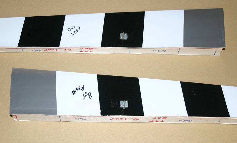

I’ve also installed the control horns on the aileron and flaps. Please take note of how far back on the flap the control horn is. Basically I set the flaps to work between 0 and 45 degrees, so the hole in the control horn wants to be over the hinge line at 22.5 degrees or half the travel. Doing this will help give good accurate control of the flaps all through its travel. One of the biggest mistakes I see with flap setups is that the linkage is spongy at one end of its travel. A spongy deployed flap will make staying in trim with the flaps deployed impossible, and provide a great deal of frustration.
I’ve marked were the hinge blocks are on the end caps and stripped the covering off were I plan to glass the center section.

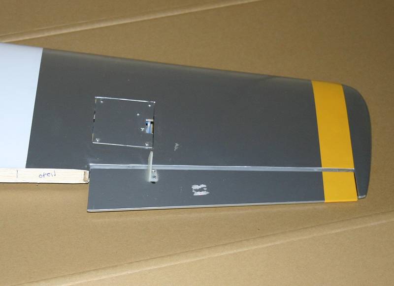

Now comes the part were it all goes back together. I covered the bare wood and ran out of silver ultra coat and used aluminum monokote and on the top surface the difference in shade is obvious. I’m not going to go back and fix it because I figure the factory covering job is only good for about 12hr of airtime, less than I plan to fly this plane in one season.
I used 3/4in reinforcing tape on the wing center section because that is what the LHS had available. On the bottom I layer over that two layers of 3/4oz. About 7/4 in. wide. I covered over the bottom but plan to leave the top uncovered just to keep an eye on how it looks.
I’ve strung all the aileron and flap servo wires before I buttoned up where the flaps had been removed from the back of the wing so I can get in there if I need to. Hooking up the flaps I plan to use a standard y harness and have the pushrods come off the same side of the servos (ailerons have the pushrod coming off opposite sides of the servo to give the opposite direction movement. Notice that I have mounted the control flap horns centered on the servo not offset to the side of the servo the pushrod is coming off. The reason for this is to keep my cost down. The other option for y harnesses is one that reverses one of the servos (now they need to be hooked up like ailerons, pushrods coming off opposite ends of the servo). Lastly and no longer made is a y harness that allowed one servo to be trimmed to the other. The important thing to have in all these is the trimming feature, when looking at the reversing y make sure it has the trimming pot because that is what you are buying it for.
The first time I use the flaps even with all my attempts to keep the surface area the same (left to right flap), angle is =, servo output arms and flap control horn all move through the same arc it is still possible that the flaps will cause a small role when deployed. It can be very slight ( a quarter or 1/8 role in a pass ) and can be trimmed out by adjusting clevises. But that takes time and for someone who does not understand what is going on they will end up changing the clean flap position also, retrim it and when the flaps come down the role will still be there. So to avoid the frustration I tell pilots new to flaps to use one of these y’s with a servo trim option to trim it out.

I managed to get the Robart retractable tail wheel working with the retract servo now installed into the airframe. I have both the rudder and engine trottle servo's inplaced too. I now am into getting the tail wheel stearing hooked up and figured a way to do this. It's a tight fit back there and work goes slow.
My elevator servo lead takes one 18" extension, but will take a little work to route the wire around the tail wheel retract unit. I am using a used retract servo for the tail wheel retraction...only because I have a good used one in hand. I am using Airtronics 94322 ball bearing servo for the rudder, and a new 94102 for the elevator, in the tail. I use Airtronics gear, and I am really happy with this gear.
I know I am adding a little whight in the tail, but I'm only using one servo back there. I'm doing my best to keep things light, but when I balance the model, I will know. Until then...I'm keeping my fingers crossed. This is also a practice model for me...installing gear I've never worked with before.

Bobby, the rgw is the with my fingers shifted on the key bourd. where is that spell check anyway.
I used the hinges that are 1/8 dia look at the pic's I photoed the packaging. the mfr stocking number is on the packaging.
