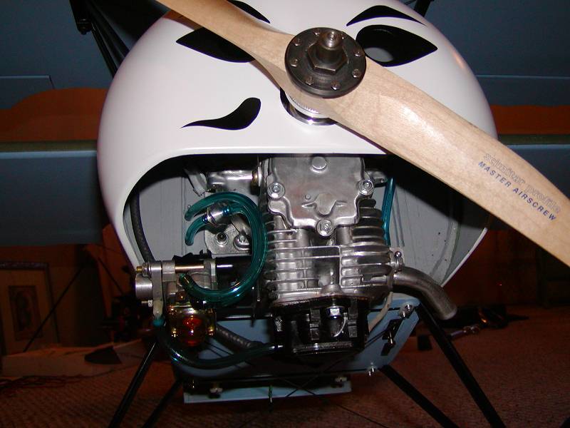

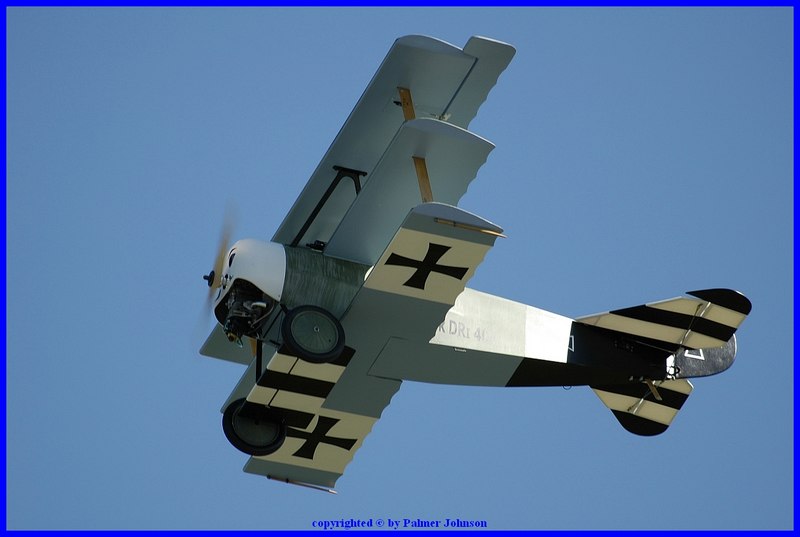

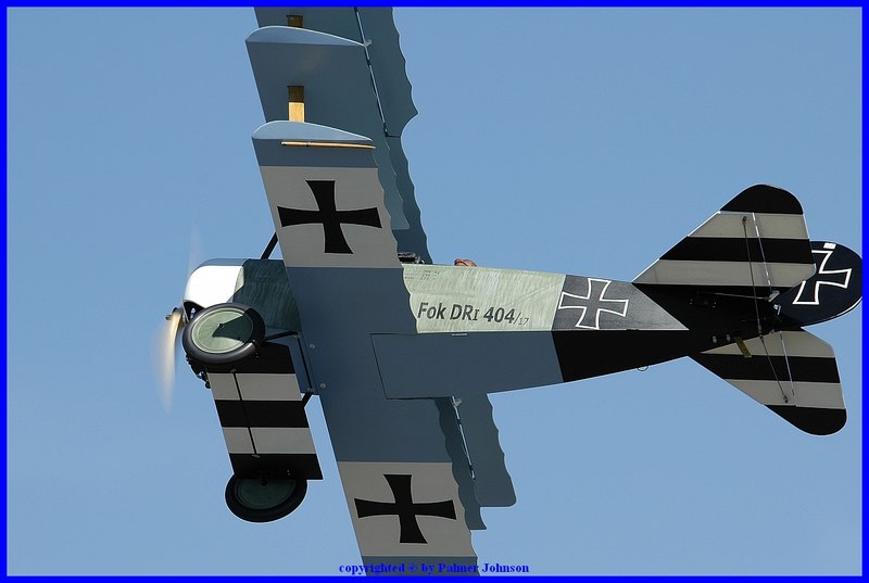

Here is my Balsa USA DR-1 with a Honda 31cc four stroke. Straight forward build, great flier, not hard to take off or land. I just love it specailly the sound of the four stroke. I've changed, repainted the cowl sence these pictures. I just didn't like the white. What ever you decide the triplane will make a great add to your hanger.
