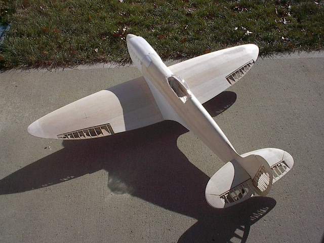

Just ran across this thread, and decided to chip in. I am building a TF Spit as well, and have it framed up and am getting into the tedious mechanical hookup stage, minor details, and then will be ready for the glass and paint. See the pic for my Spit in bare bones.
I completed the TF FW190 last winter (pics on Wulfman's site), and flew it all summer. What a joy to fly for a warbird! I hope the Spit flies as well. They should look good together in the pits.
I did not have any real problems building the Spit, errors in the manual and all. Most is common sence and thinking things through. Then again, this is my 4th warbird. in the last three years.

Hi RCnutKC,
Just saw your post as my computer was down for a while
and wanted to pass on my compliments on your Spit. Are you
using flaps l didn't see any in your pic? Also is the wing sheeting fragile, and are you glassing and painting or using monokote?

Hi Dave:
Thanks for the compliment. Pics can hide a lot of flaws, however...
No, I am not using flaps. I made this decision based on: 1. They are split flaps, so they are not that obvious. 2: In a 60 sized plane, they are not needed to fly (or land) the plane. 3: I wanted to save weight. If I was building anything biggger, or wanted to scale the plane out much more, I would definitely add them. I made the same decision with my FW190 and never regretted it, the plane flies great (better, lighter) without them.
Yes, be careful with the wing sheeting. Do not sand anymore than necessary, and take time joining the skins to line them up. Select heaver balsa for the forward skins, and put the ligher skins on the rear of the wing. 1/16" is the right choice, as you are saving weight. You just have to be more careful until the plane is glassed or covered. I only cracked the skin once, and a little thin CA fixed it right up.
I am glassing my plane with Sig .56 oz cloth, the lightest I can find, and Z-Poxy. That will be followed with laquer primer, then Model Master Enamel paint, details and panel lines, and then sealed with an automotive clear Urethane with flattener. Worked great on my Yellow Zero and TF FW190. My colors are medium Sea Gray underneath, Ocean Gray and Dark Green camo on top.
I am using an OS61 FX in my Spit. Great engine, with lots of power for a 60. Don't let anyone fool you about it being too little, it pulls my TF FW190 around with ease, actually over scale. It will be fine unless you build a brick.
I just finished the cannon housings and barrel tonight, check out the pic!
Cal

:thumbup: Nice joint at leading edge l'm jealous! l am leaning
towards using flaps for realism and help at landing. A fellow club
member who owned one complained about having to come in very
hot to avoid stall and was hard on his and eventually sold it.
He also put his finger through his wing a few times but used
monokote not glass. l am undecided yet but is the strength of
the glass a good trade for the added weight and of course then
you are painting your project. Other posts on this subject warn of
a heavy plane never coming close to the advertised weight by TF.
That is one reason l went with a Saito 91 plus the awsome sound
Warbird scale builders would cringe
at the thought of using monokote instead of a camo paint job and they
are right but the ease of monokote is tempting, we'll see l have
time to make a decision. Thats it for now, time for some zzzzzz
l am going to the hobby shop in morning for a few items.
Who said xmas is over.
Dave

Hi Dave:
The Saito 91 will be a good choice for this plane. It is about the same power as the OS61 FX two-stroke, so you should have enough power without overkill. I agree with you about the noise, although I am still partial to the simplicity of the two-strokes. Since some are needing nose weight, it may be the better choice.
I too have read the weight discrepancy with TF kits, and have read the reviews that come in 1-2 pounds over the TF specs. I wonder why? Case in point: I put in retracts, cockpit kit, glassed and painted my TF FW190 and it was just over 9 pounds. The specs said 8-10 lbs. Then I read reviews where people were coming in at 11-12 lbs?? I think a lot of it has to do with building techniques, wood selection, and how you glass and paint the plane.
I think, unless I have to add nose weight, that my Spit will be coming in at about 8-9 lbs. It is slightly smaller than the FW190, and the retracts are lighter. I have read reviews, one monokoted, that were over 10 lbs!
I have to take issue with those who think a glassed and painted plane is MUCH heavier than a film covered one. If done right, just is not so. A carefully applied glass and paint job is not much at all heavier than film. Think about it: Monokote has a relative thick plastic layer, and a paint/glue layer. There is some weight there. If you use .56 oz cloth, and ONLY enough resin to fill the weave, and they use thin paint layers, you will come out comparable. Maybe not lighter, but certainly not much heavier. Those who add a lot of weight are 1. Not prepping the surface enough first (you should have all dents, cracks, etc filled with lightweight filler) 2. Using TOO much resin 3. Putting on TOO much primer or not sanding excess off. 4. Using a heavy or too thick paint layers.
Consider painting, it is much more impressive. Of course, there is always a trade-off, and a lot depends on whether you want a sport plane that looks like a Spitfire, or a nice looking semi-scale plane that you can fly like a sport plane. True scale die-hards will look elsewhere, the kit needs too many mods and details to be true scale.
Cal

I've built the TF Spit as a "sport kit" (no flaps, has a fixed gear). I like to build simply, but make a war bird otherwise look like a war bird. I covered my Spit with flat olive, grey, black and gloss white (invasion stripes) Monokote. I used lustercote olive and grey paint on the cowl, with Testors Model Masters RAF dark sea gray paint on the upper surfaces. I oversprayed everything with lustercote clear flat.
Just finished it and will have to wait for awhile to fly it (Winter in Wisconsin).
I love warbirds, but don't like the complications of buying, setting up and repairing retracts and flaps. Other warbird pilots at our field almost never use their flaps.
I'm also trying to show my fellow club members who oggle warbirds at the field, then build Four Star Forties because they shy away from warbird building and flying, that they are really not that tough. This is the 3rd TF kit I've done as a sport (simple) plane. The P-39 and P-51 preceded the Spit. They're all powered by OS .61 FX engines. I can fly at half throttle for 15 or more minutes and use up only half a 12 oz. tank. They all have flown like a nice .60-sized Sportster or a stick, i.e. stable, reasonably slow landings.
Get losts of ooohs and ahhhs at the field while flying them. Can fly them anytime, not just special fly ins because they are so simple and foolproof. Just have to land a tad faster than with a sport plane. After awhile, you gain enough experience flying them, that passes over the field can be flown at such an angle, that you don't even reveal the gear hanging down. Had one guy swear I had retracts in my P-39. He couldn't see the gear hanging.
Used Great Planes hinges. Epoxied them in. I wouldn't trust CA hinges on this big an airplane.
I'm not saying that retracts/flaps are bad, I just like to keep it simple. Can't wait to do the TF Corsair and P-40 the same way!

:thumbup: Very nice Spitfire dhable, clean looking.
How did you find the wing sheeting, very fragile? Did you do any
prep work before you applied the monokote? Also which pilot
figure did you use and did you use a cockpit kit? l'm sure your Spit
will turn lots of heads at the field.
Dave
