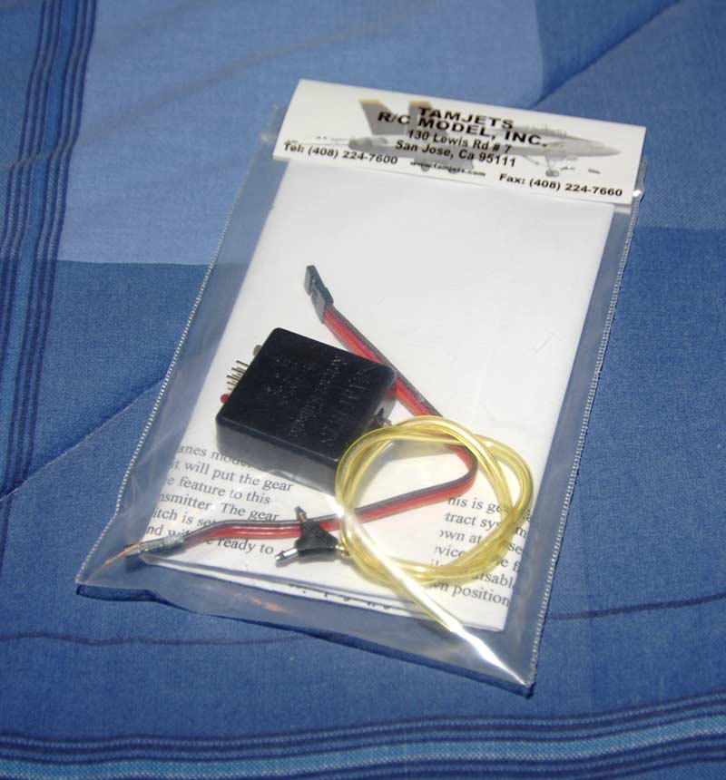

Default Retract fail safe
I just picked up one of these Tamjets gear fail safe's for my Byron corsair. It's supposed to be a failsafe for when the air pressure drops to a certain level, it will automatically drop the gear for you. It looks like it will also be a failsaife if i turn the radio on with the gear switch in the up position.
I know it will probably save me some scrapes and having to repaint the bottom of my airplane!
http://www.tamjets.com/original/prod...roducts_id=226
Chris

Here's a photo of the package. I should have it in my airplane by this weekend so I can check it out. At least it's small and light..

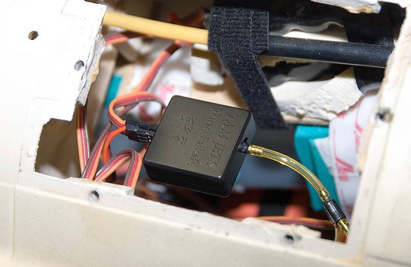

Old 08-16-2006 | 12:46 PM
LuvaraAir's Avatar
Posts: 198
Received 2 Likes on 1 Post
From: Silicon Valley, CA
Default RE: Retract fail safe
I finally found some time to install this thing in my airplane. Works great so far. I set the pressure I wanted it to fail safe at, leaked some air, and bam the gear dropped as soon as it got to 60psi. I haven't flown it yet, and I'm even contemplating leaving the pressure low and watching to see if it drops the gear for me.
Here's a pic of the unit in my corsair. There's a piece of velcro on the back and it just sits on the fuse side next to the retract servo/valve.
Chris
