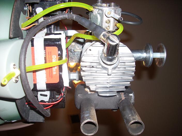

Very nive thread!
No news about electric...
I selected an AXI 5345/14 behind 12s2p a123 under the hood.
No CG problem ;-)

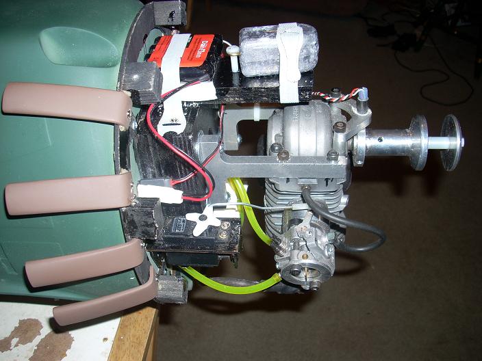

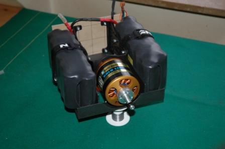

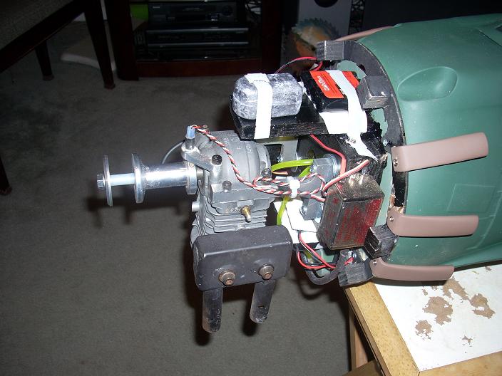

Here are a few more pics of how I mounted my Briellei 46GT & Batteries to the motor mount on the firewall

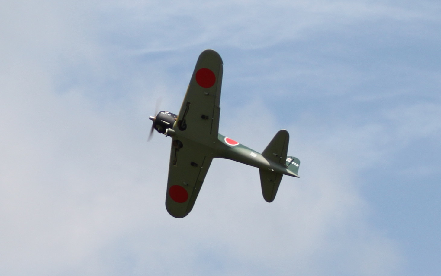

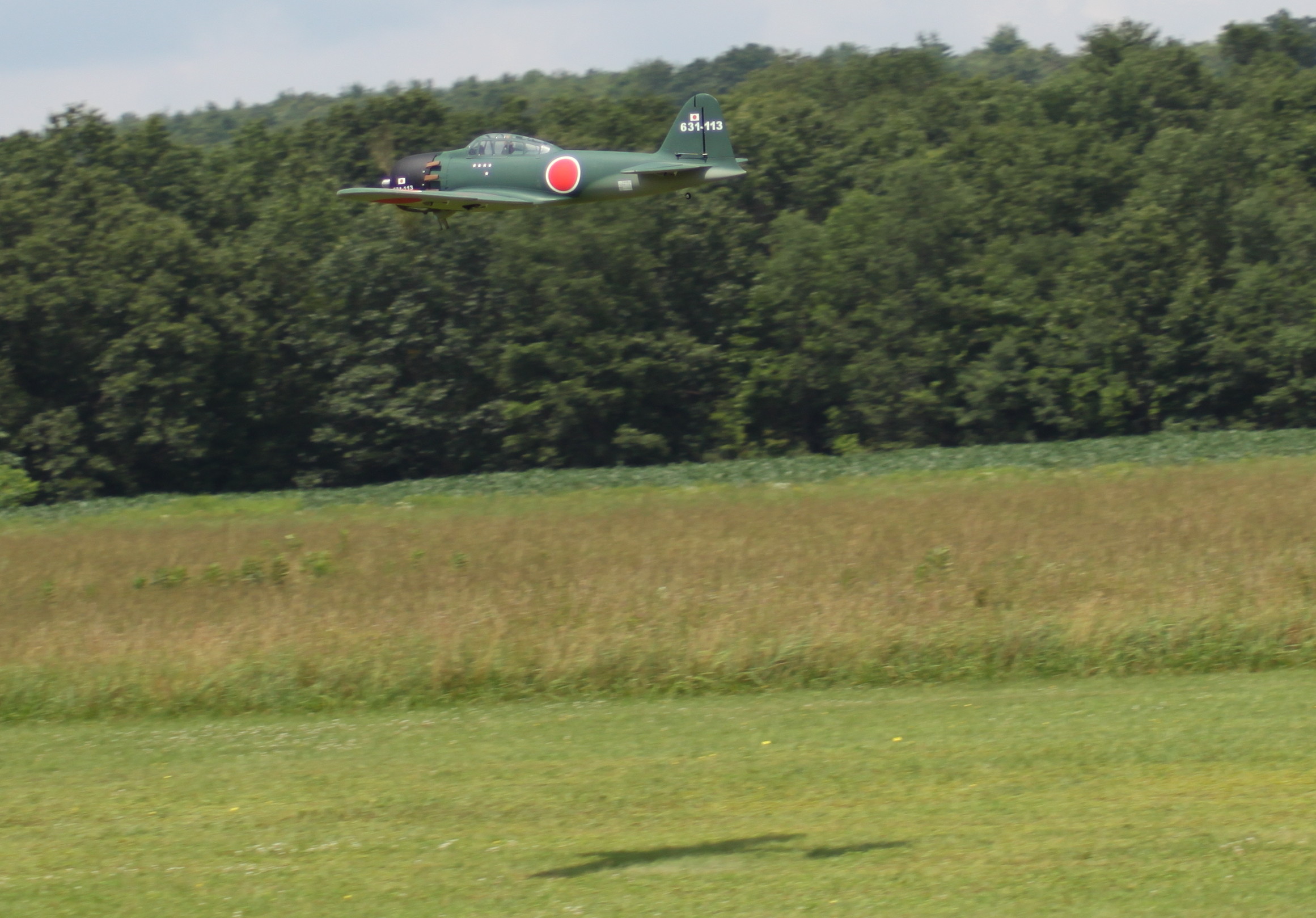

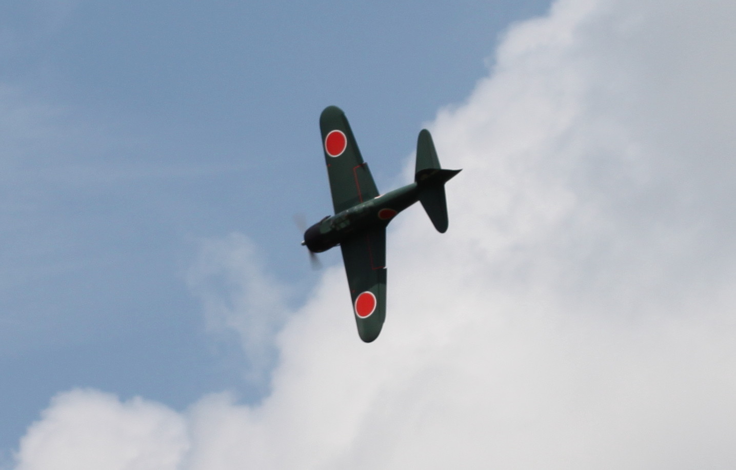

Mine is close to 20lb., may have given a wt earlier in the thread, it fly’s great at that wt.. the engine is still rich. Just need to remember to carry T to the ground.
pic's of:
Low pass
Out of plane barrel role
MPT
Joe

This is it!

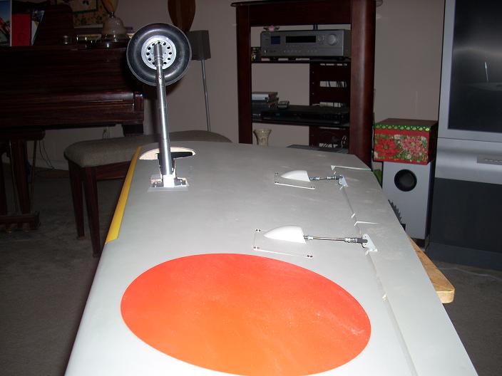

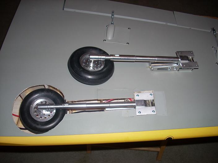

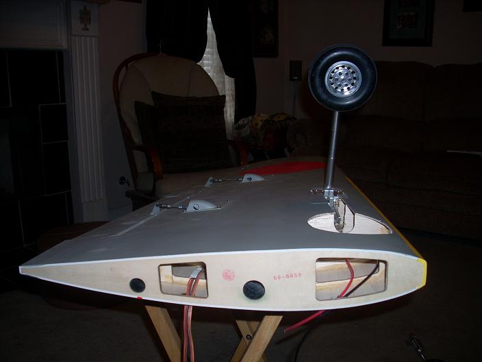

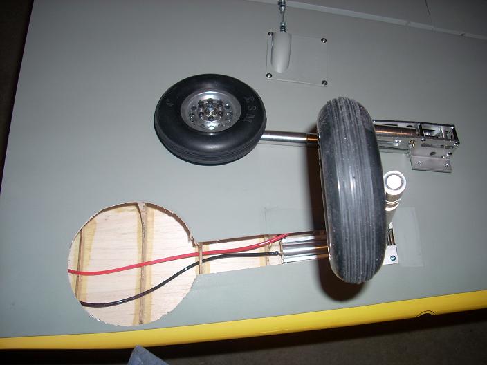

I Well I finally have one of the ESM landing gear mounted to a wing. Here are a few pics of the ESM gear and the wing it is mounted to. Now I am working on the other wing than I'll mount the air tank and swith into the fuselage.

Thanks ramboman,I'll follow your progress and it should help me make a decision. I'm going electric with my 60 to 1.20 stuff I'm just not sure how large I want to go. Given weight needed to balance this bird you ought to be able to put enough MAH in her to fly for an hour. LOL

JSTANTON***How long are the struts on the ESM gear?
