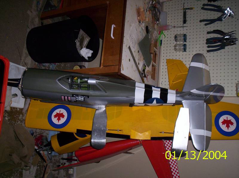

I Have a p47 with aproximately 6 foot wing span i will send pictures later but any idea how big of an engine do you think i will need. I hope to put a 1.00, or 1.20 glow, i don't know the weight yet.

Dave a lot will depend on the weight of the model. Right off the bat a 1.2 will not be enough.

Is the plane an ARF or built from a kit?

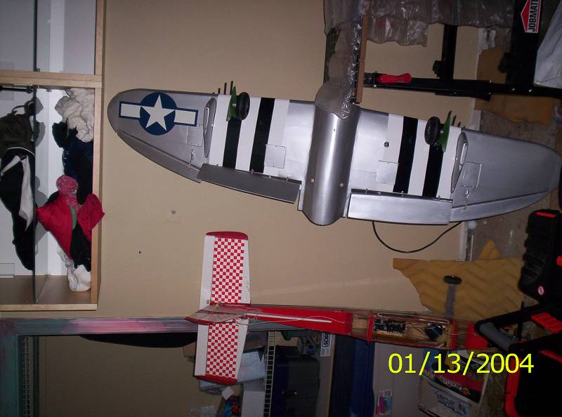

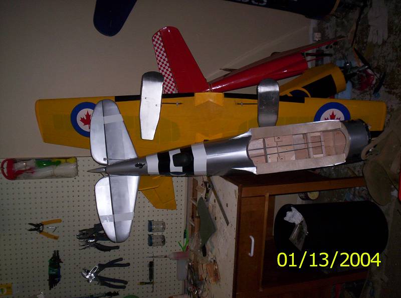

ORIGINAL: tailskid
no clue, but here are some pics.
thanks for your help

dave I posted some info for you in the beginners section thats a Top Flight P-47 you can get the manual for down loading @ http://www2.towerhobbies.com/cgi-bin...?&I=LXHU86&P=0 its handy having the info for repairs and getting the CofG and specs.
