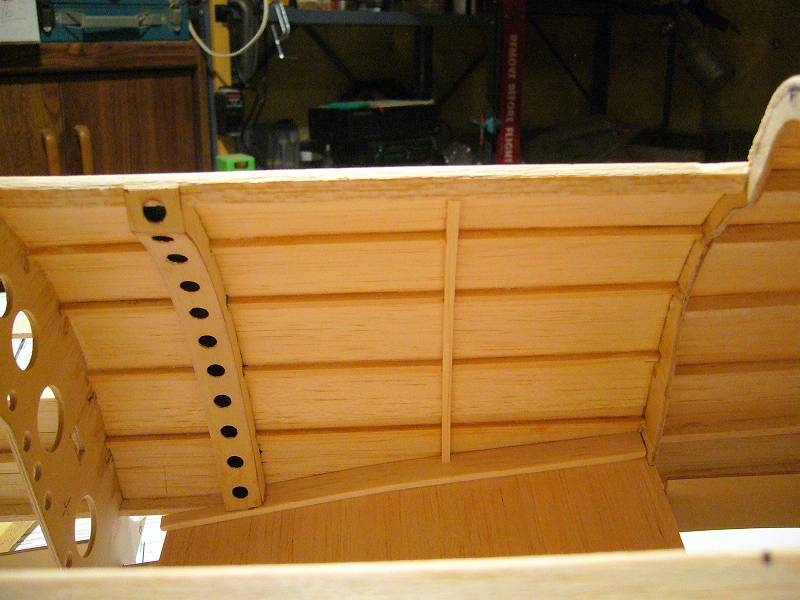

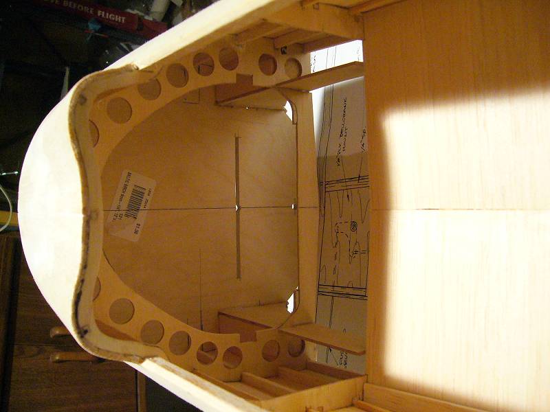

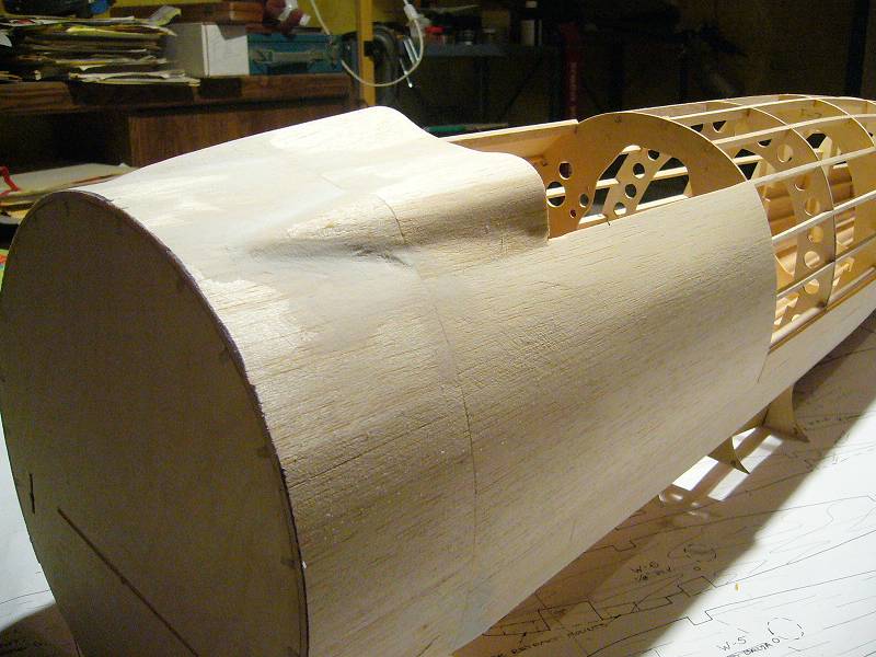

here are some pics of my Ziroli Zero. Will try to get the former outlines sometime this weekend... May spill into next week.
Jeff

Man, that is a beautiful beautiful zero constuction...
The gun humps look really good.
I just wish i saw these pictures before i cutted all the fusalage formers...
Whay havent you cut some holes in the back formers as well ?

ORIGINAL: Ravivos
Thanks! The gun humps are 2 layers of 1/16th soft balsa to get the skin to follow the curves of the former. The forward inch or so is a shaved block. As for the lightening holes, I thought about it - but decided against it as I am using lite ply for aft formers. Thought they might be too fragile. As it turns out, it would probably be ok if you keep them reasonable in size. All you are trying to do is hold the outer shape. Just remember not to squeeze in that area!
Jeff

ORIGINAL: G.F. Reid
jmmodguy, nice work. That last pic, I assume you're building a plug to lay a fg cowling?
Thanks for the compliment! yes! I am jumping - somewhat slowly - into the glass layup arena. Don't want to do it twice. It will be "closer" to an A6M3/5 cowl that the one Mr Z offers. It will also have separate cowl flaps. Not sure yet if I want to go glass or thick ABS for the cowl flaps. I am also planning a scale (size and shape) glass spinner to go with the cowl. I have a huge hunk of maple that I will be using to make a a plug.
