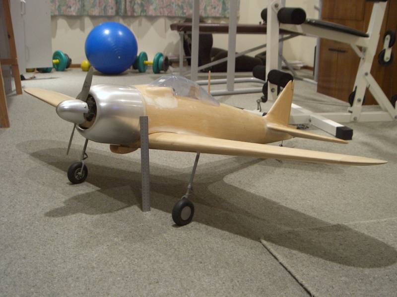

Planning a scratchbuild of a Zero from 3-views and my own plans. Has anyone built this plane using the scale surface areas, decalage, etc. Have read in this forum that a 0-0 setup is essential, but was told the same thing about my scratch spitfire but it flies great even with the small tail. One person mentioned he had a 0 incidence wing and a neg 2 degree tail. actually this is 2 deg pos wing incidence. Any info will be appreciated, pro or con. Thanks in advance. I posted this in scale with no replies so far.
Joined: Apr 2006
Posts: 144
From: Kaiapoi, NEW ZEALAND
Hi.. First off ..my Zero has 1.5 deg.pos for the wings , and 1.75 deg pos. for the tail plane. This in effect gives the engine a slight down thrust,and in fight a slight nose down attitude.The spinner is a marutaka aluminium spinner.bought it from a chap who no longer had a use for it.Yes it is the scale shape that is why I jumped at the opportunity to have it. I have a full documented book on the Zero with all the models and has been a real help with finer details. This has been a long drawn out build but nearly there now. Good to see a few Zeros being built. Cheers
Scratchonly, what size Zero are you planning? The Platt kit has several of the tricky to make parts in quality fiberglass, including the spinner, exhaust stacks, etc....OR....looking at your user name, you may not be interested in any of that..
I have a Platt kit with all the works. I also have a book here on the Zero that is the most in-depth, intensive study of an individual plane I have ever seen. It is absolutely loaded with foldout engineering style drawings, foldout artist's renditions, clear archival photographs and full color three views of dozens and dozens of planes..Even the individual components of the plane, weaponry and engine are covered in minute detail with factory style drawings...and all large enough for a middle aged guy like me to see...
Only one problem. There is not a word or English in it. Not even an Arabic alphabet. It's all in Japanese. [&o]
I'll bet the decalage information you seek is in it but it will remain a mystery if it has to come from this book.

G.f. Reid....thats fine mate just get someone who can speak Japanese and get then to read it to you.....I am a bit more fortunate as mine is in English .cheers.
Posts: 296
From: zionsville, IN,
Which book is it? I have several of them (JN version) and my son is fluent in Japanese. Reads writes AND speaks! He has helped me decipher a lot of my books.
I am in the middle of a Ziroli Zero and have changed the forward 5 formers as they are horribly wrong. I am using my Japanese docs as well as the Tamiya 1/32 scale A6m5 plastic model. It has a ton of detail and it is easy to scale the part sizes using a scale with 1/32" marks. 1/32" = 1" full scale, then scale back down. 4.76 is the constant for the Ziroli... Getting ready to start on the wing so I can get the tail mounted. Engine will be a G-62 with a Torquemaster drive from Mick Reeves and to keep the carb in the cowl I am using a Toni Clark carb elbow. Engine is getting CD mod by Ralph Cunningham in AZ. I am making my own spinner and cowl. Ziroli cowl is wrong shape. Glasswork is OK - just doesn't look right. Am thinking about a Solo prop too. If you have any questions let me know!

I want to use my saito 91 so I'll start with the cowl diameter; should be about 64" span, about 1/7 scale. The canopy is the only thing I would like to purchase; I have no idea where.

By the way, the Zeke looks fine!
jmodguy, I have no idea what the name of it is. I'm scanning the cover for you. I have a set of the Ziroli Zero plans. I never looked at them all that closely as he sent it by mistake when I ordered my 70" T-Bolt plans. I called him and he just congratulated me on a free set of Zero plans, then sent me the Jug plans. It's a bit large for me.
I've got a lot of the Platt stuff. Two sets of the fiberglass parts, full kit, one or two sets of plans, retracts, full figure Japanese pilot, etc., etc...Been on hold for several years.
Scratchonly, your plane sounds to be about the size of the Royal plane. If you can get hold of a canopy, it would probably work.
By the way, the Zeke looks fine!jmodguy, I have no idea what the name of it is. I'm scanning the cover for you. I have a set of the Ziroli Zero plans. I never looked at them all that closely as he sent it by mistake when I ordered my 70" T-Bolt plans. I called him and he just congratulated me on a free set of Zero plans, then sent me the Jug plans. It's a bit large for me.
