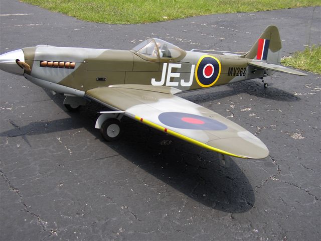

LDM -
I'm with you on the no flaps deal. I have a World Model's Spitfire GS (80" ws) and using an OS 1.60 with a 16x10 Xoar wood prop. This plane has split flaps and it really helps in landing the plane. I used decals from an old Pica kit that recreates the Johnnie Johnson markings similar to Cermark's spit. I then sealed all the decals and shot the whole plane with Top Flite's Lustracote flat clear. This is one of the best flying planes I have ever flown (that is quite a few) and the 1.60 really hauls this bird through the air. Huge difference in trying to land this plane without flaps as opposed to using them. Because of the smaller size for the Cermark spit, it's probably OK landing without them, but it sure looks fantastic seeing a plane with it's flaps down on final approach.

MK , I first looked at the world spit at Sheldong hobbies in Northern Cal hanging in the air , very very nice ARF . Nice size and detail .

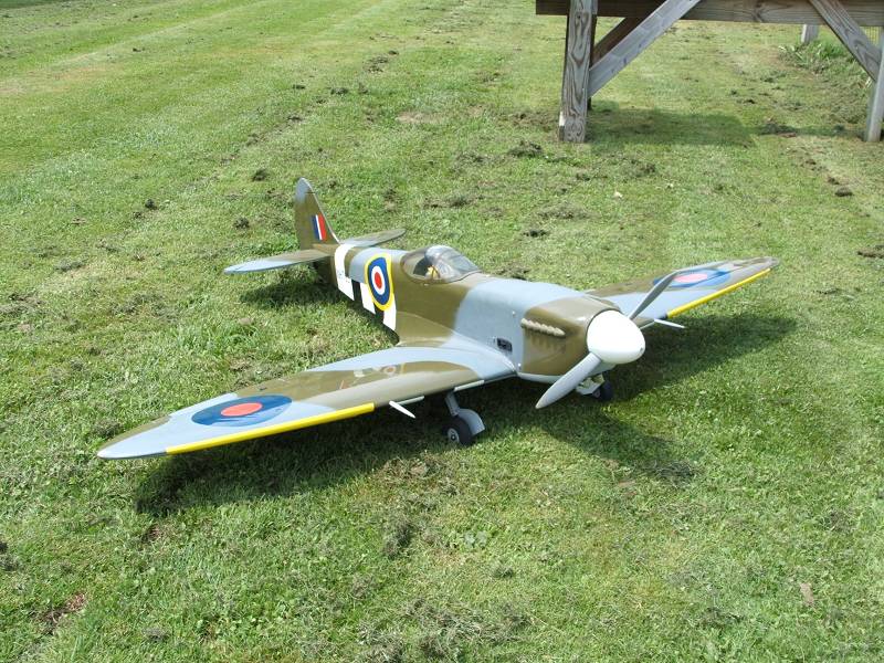

easton
The world doesn't look right because there are no wing fairings on it!!!!!
A spit without wing fairing is like a spit without an eliptical wiing
I bought replacement fairings from the Top Flite spit and peeled back the covering and put them on and smoothed the covering back over it. NOW you have a Spitfire I also changed the markings to make it British instead of Cech(?)
I was leaning toward this because I wanted to go gas and it loked like a perfect fit (like in my car) I have a 30% Yak gas and it is such a hassle to get it up my stairs and to the field I stopped flying it so much
