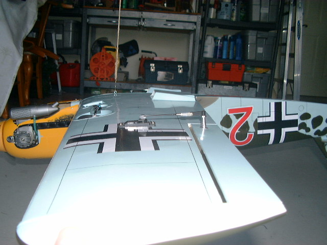

One more thing ... balancing!
Book says CG between 88 and 90 mm from LE. Doweled hook at 90 mm from leading edge. Glued in with epoxy. Hooked it up in the garage. CG slightly in front of 90 mm. No additional nose weight required. Horizontally a slight tendency to the muffler side. Nothing dramatic. In other words: She is ready to fly.

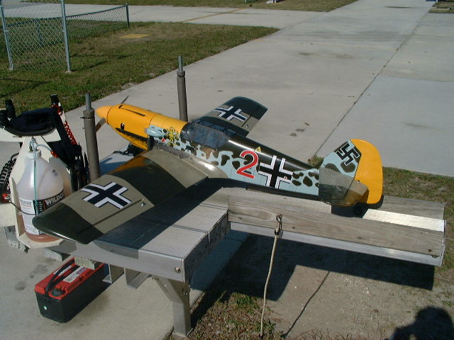

Maiden flight report: The OS 50 SX has an easy game to pull the Emil in the sky. Tail lifts after 10 ft. After giving her 2 seconds more to build up speed, the whole plane lifts right up in the air. The 109 reacts promptly to the sticks. First flight with 35% differential on the ailerons which will unable the plane to quickly roll. On second flight I removed the differential on the ailerons and dialed 25% rudder in to support the turns. Now she manoveurs!
As I predicted the greatest disadvantage are the retracts. Although mine would retract on standing, the airflow prevent mine from retracting. I am running on a 6V receiver battery. Also, the mechanical retracts became wobbly but will withstand the landing forces. I am working on a air retracts solution.
Landing is easy. She flows right in on idle. Just like a low wing trainer.
No video this time. Can't control the sticks and the fumbly video at once. Will post a vid later.

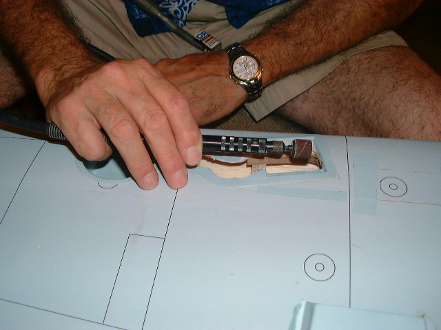

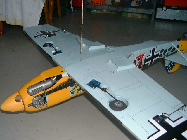

Conversion to air retracts using Robart 606 HD at 85 degree. The 606 is almost a drop-in solution. 3/16 wire. Little Dremel work on the hardwood rails. Fill the former wholes with tooth picks and epoxy. Also use some Dremel work on the wheel wells to accommodate the air cylinder. Heat up the retract wire with a propane flame in order to bend them at the same angle. In an first attempt I tried to install the air tank on top of the wing. More useful is the solution to put the air tank inside the fuselage along with the valve as shown in the photo. 2 additional air-restrictors prevent the gear from popping up or down too fast and with too much kinetic force.
This solution is extremely well and I can highly recommend the use of the 606.

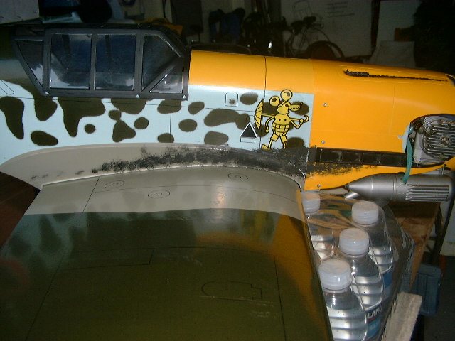

The OS service has been very generous with me. They sent me an OS 55 AX in exchange for the OS 50 SX. That was the 2nd OS 50 SX that died on the same problem: Worn out ball bearings within 6 months of use.
The OS 55 AX fits perfectly in the mounting pattern of the 50 SX. No alterations were necessary except those on the cowling allowing the increased size of the muffler.
