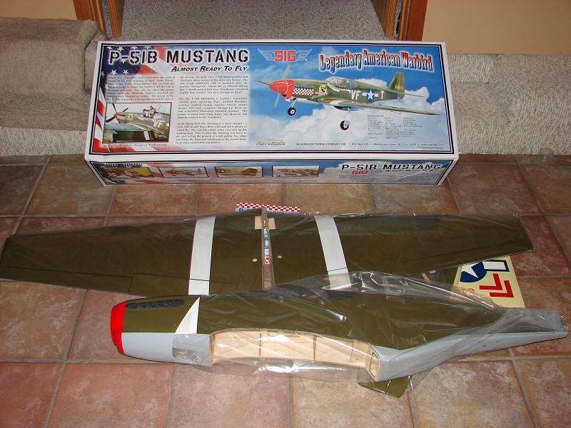

Here it goes I ordered it last week and it arrived today. It is of course the lovable Sig P-51B - made in China (proclaimed on the box).
This will be the normal, by the book build. I doubt I will deviate much as I don't have a lot of time for that. I've taken it out of the box to ensure all of the bits are there and I will hopefully start it this week. I need to get my hardware together and go buy a few servos and other bits.
I've built quite a few Sig products and so far this one looks to be on par with those - won't really know until I start.

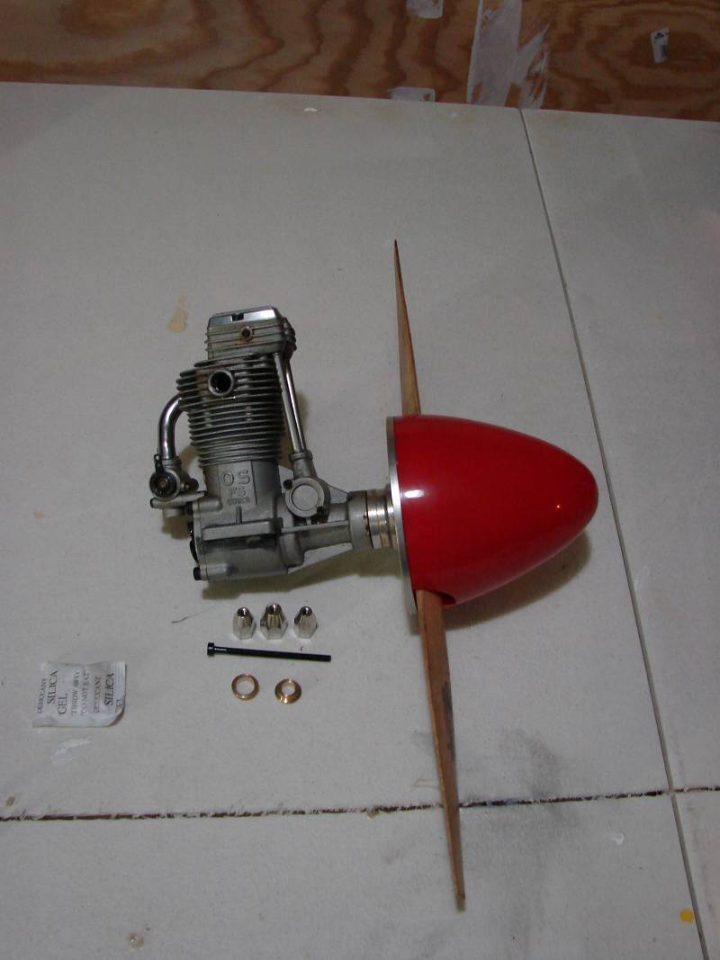

I'll power it with my faithful Pre-surpass Os-!20 4 stroke. This is far from the most powerful engine out there but it looks good, runs reliably and sounds great.

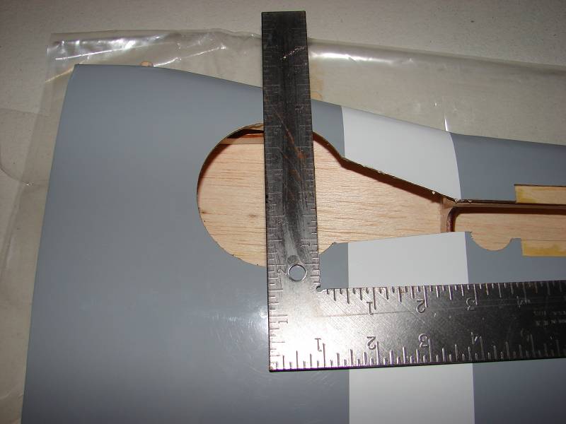

Well, I got the box down to the garage today and I really pulled everything out for inspection.
First I looked at the wings and they are very nice - I think 'noflaps' did a great job on his but I am not sure if he added larger wheels. The wheel wells would really need to be made much larger than they are for larger wheels (obviously) but there isn't a lot to work with there and I Would be concerned about taking any wood out. At this moment I am thinking of probably staying with the stock wheel size, maybe going up to 3" but I am definitely not using the stock foam wheels. They are ridiculously too light for the application. I would be surprised if they lasted a dozen flights. I hope Sig saved money on them, I'll buy some nice replacements.

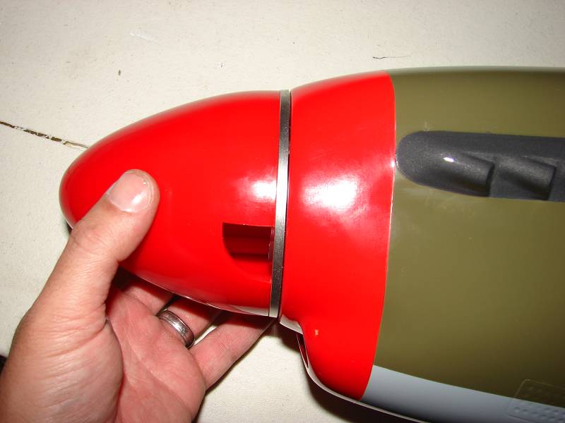

Next I looked at the spinner and cowl. The spinner is a nice plastic spinner but its shape isn't right. Eventually I am sure I will replace it with an aluminum 4" spinner but this one will do for now. I know some folks have asked about the spinner's continuity of the shape of the airplanes nose, basically it is somewhat flattened in the prop cutout area, you can see it in the picture. All in all though it is a very nice spinner with good hardware included.

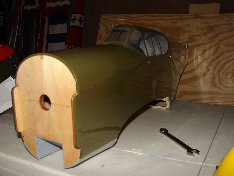

Following that I took a brief look at the fuse it isn't perfect but it looks good. The covering needs to be shrunk up and stuck down in a few places but it is a good job overall. Only slightly better I think than I could do myself. I believe eventually the airplane will have to be recovered but for now I will enjoy it as is (since that is the idea behind an ARF). I will say that I am again disappointed in the placement of the fuel tank for an inverted engine on another ARF. The tank is designed to be about 3/4" higher than it should be. My experience with inverted engines is that the tank should be ~1/4" below the carb centerline but at least in line with it. Above the centerline and you start to have idle problems, it is easy to fix but I don't think it should HAVE to be fixed - they designed it for an inverted engine, there is plenty of room - design it with the tank in the right place for crying out loud.

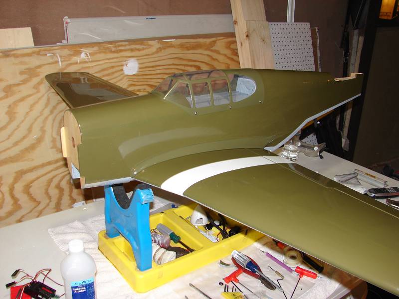

Alright, I have to say - so far this is an awesomely done ARF. The covering is probably the part where it is lacking the most but that's okay really because if it doesn't last it will be easy to rip it off and do a fantastic recover on it. In fact...this thing is so nice it may negate the need for me to build the top flite kit.
Now...onto the progress:
I finished most of the wing today - I get half days on Friday so I worked pretty much from 1pm -4pm and then for an hour and a half or so after my son went to bed. The flaps went well just by following the instructions - you just have to ensure that you push those hinges into the hinge line well enough to eliminate the gap and ensure proper alignment with the contour of the wing. The manual suggests using a reversing y-harness. I didn't do that - I just used 2 channels on my radio and tied them to the same knob (one in reverse). I also reduced the travel of the servo to about 25% which gives me about 60 degrees deflection (I imagine that is enough) and eliminates any binding in the horn openings.
The ailerons don't require any mentioning as they are just ez hinges and are very well done.
Next came the gear - I am not a wizard with mechanical retracts and I've stripped enough retract servo gears to keep some extras on hand.
Totally not required here.
I'm a boy scout - reading directions is not in my nature - I know how to do everything already. But on a lark I read these and boy am I happy. These guys have everything measured and even have a template to bend the pushrods to in their! They tell you the measurements you need on the rods and what it should be at the servo horn. I followed them exactly, when I was done it darn near matched the pictures (very close) and holy crap! they are the smoothes retracts I have ever installed. Ever. So, I hope the gear hold up and I hope that I can put some struts on there in the near future. Since I haven't had a chance to get to the LHS I just put the stock wheels on there.
All I have left to do is the wheel wells and then the gear doors.
Tomorrow however I think I will skip that and start on the fuse.
The Landing gear is done.
