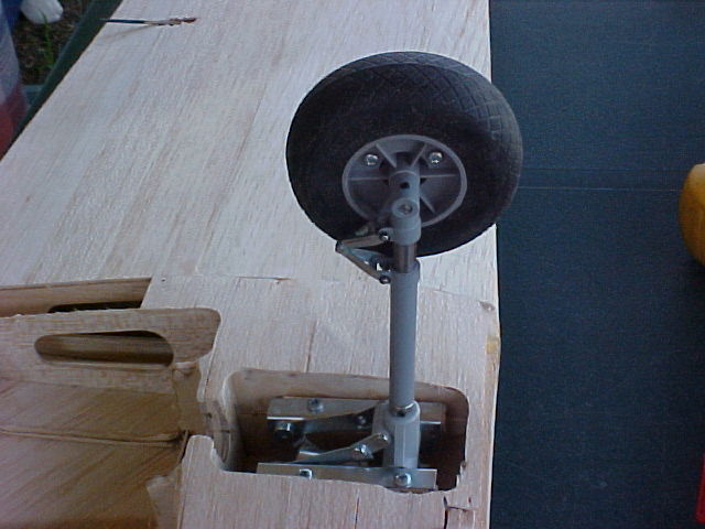

BUILDING TF COURSAIR 60
I AM PUTTING ON MY ROBO STRUTS ON THEY SAID TO USE #36 DRILL . WHAT SIZE IS THAT AND HOW THE HECK DO YOU TAP SOMETHING THAT SMALL IT IS FOR THE SET SCREWS ON THE STRUT TO SECURE IT. PLEASE HELP .
ROCKY

Go to a good quality hardware store and they will have a #36 drill and the corresponding tap.

THANKS I WENT TO THE HOBBY SHOP AND THEY DID NOT HAVE A DRILL BIT THAT SMALL. GREAT I'LL GO TO DAY . AGAIN THANKS

A # 36 bit is the recommended size for a 6-32 tap. Be sure to get a small tap wrench with that or you will have heck getting it straight. Good luck. Jim.
