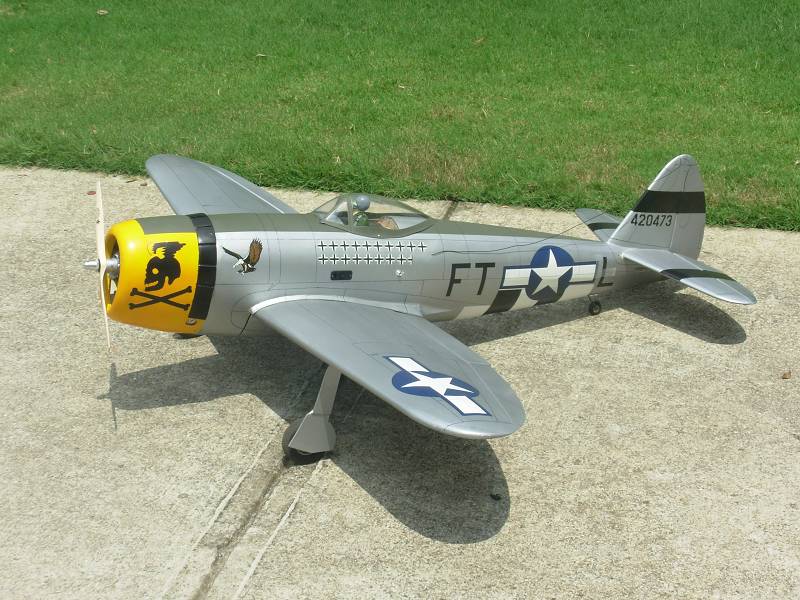

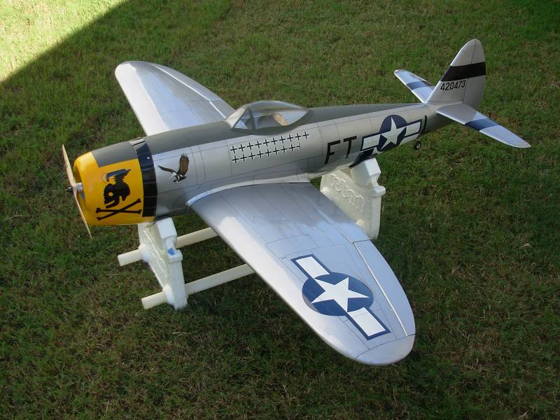

I can only recommend the sharpie and clearcote. This is how it might look.
Mike

I would not be that worried about weight. Mine has a .61 and flies great. As far as flaking, I'm not sure. I only have about 15 flights on this plane, but so far so good. I used Top Flite Lustre Cote. Just spray lightly and try not to glob it on. If your garage is an icebox like mine right now, I would wait until it warms up a little. The paint will not cure properly and you will have problems later.
Mike

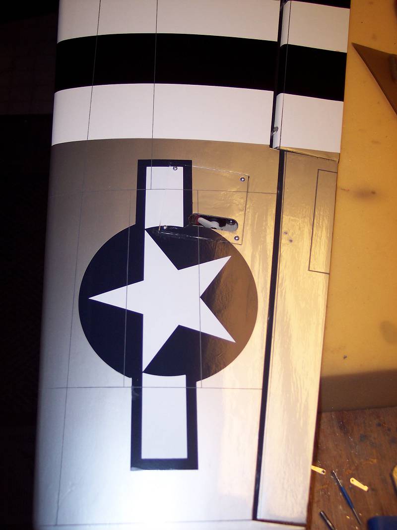

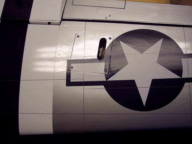

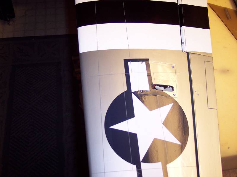

Just tried the paint system today. Used two pieces of tape close together to mask the line and sprayed it with a med. grey mix of Pactra R/C car paint. Did the underside of the wing on my TF P-51. I am pleased with the results. Clean the covering first with alcohol. The line is cleaner proof but not raw fuel proof (at least not 15%).
