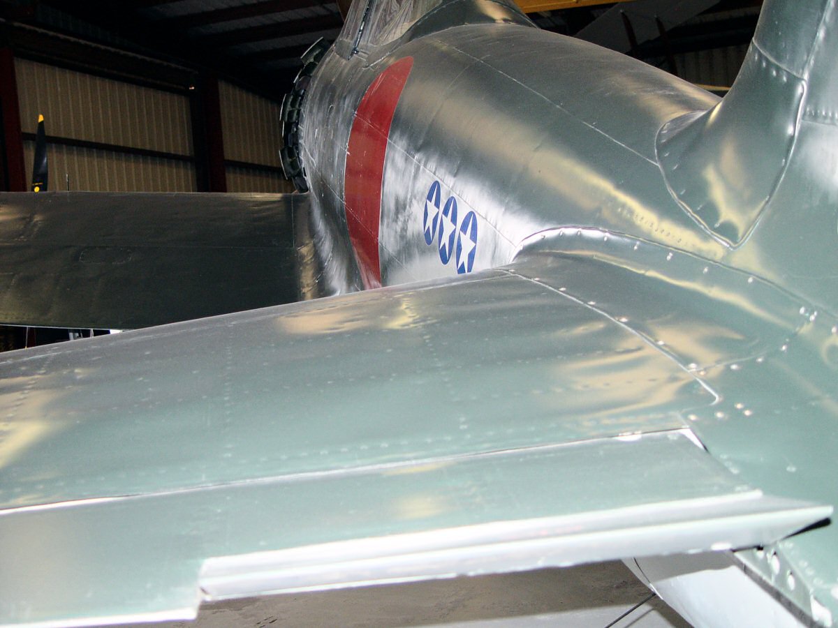

Old 01-15-2010 | 09:56 AM
ccostant's Avatar
My Feedback: (38)
Joined: Jan 2004
Posts: 581
From: Hopkinton, MA
Default RE: Panel lines and rivets
They look like flush rivets to me. Check out the pic.

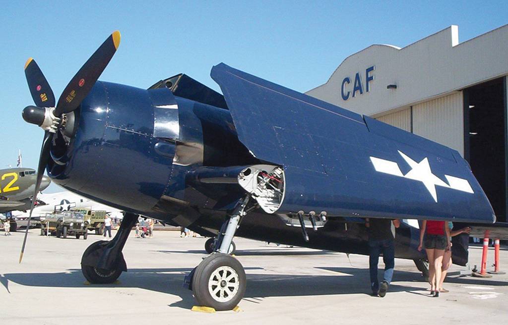

Old 01-15-2010 | 01:03 PM
G-Pete's Avatar
Joined: Oct 2005
Posts: 3,217
From: Allen, TX
ORIGINAL: ccostant
Sometimes that is misleading, Airplanes in a Museum. Many times to keep the airplanes airworthy the whole set of rivets are exchanged. That means better (and flush) rivets will be used. Better to look at pictures back in time.
Good example is the Hellcat, hard to find a airworthy F6F with raised rivets on the fuselage. They had raised rivets on the fuse...
OOOPPs almost did not see the Hellcat nice legs...

Old 01-15-2010 | 05:11 PM

ORIGINAL: G-Pete
They look pretty flush to me.
http://upload.wikimedia.org/wikipedi...-4_Hellcat.jpg

Got to agree with Chad that the Zero probably had both. Some rivets do appear raised and some definitely look flush. The Zero pictures I have are from Chino Airport. It's probably one of the best examples we can use for our scaling detail. I would think when they restored her they tried to keep her as original as possible.
Incidently I have a YA Zero that I just finished glassing, ready for paint. I usually paint outside so it will be spring before I face the flush or raised rivet problem.
