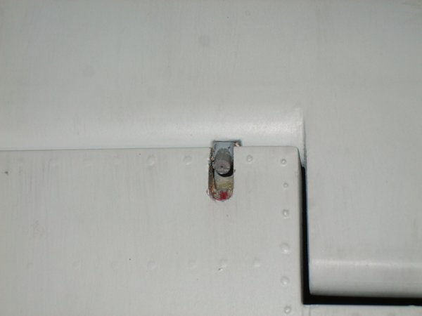

Every now and then someone will ask how to replace a broken hinge. In most cases someone responds with the usual use a brass tube to cut it out, but I'm not sure anyone has ever posted pics on the how to. This week I had to replace a robart hinge on the elevator of my TF GS Corsair so I took some pics to demostrate how I do the job.
Anyone with with a different approach or other methods or suggestions feel free to jump in and add your comments.
Pic. 1 Here I have cut and cleared a short slot over the broken portion of the hinge on the bottom side of the horizontal stab.

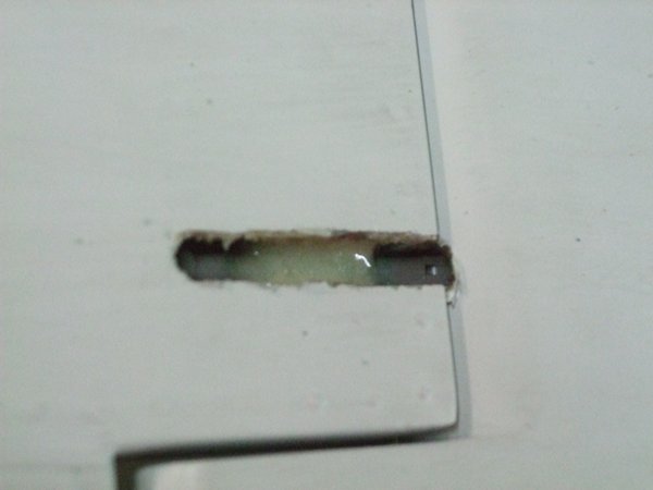

Pic. 2 I have used a very small cutter in the dremell to cut off the knuckle from the section of the hinge in the elevator half.

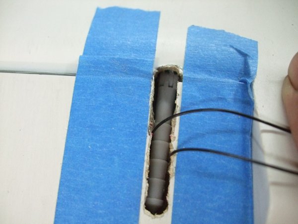

Pic. 5 Increase the length of the slot to expose the rest of the hinge, here I have looped some steel fishing leader around it to pull it out of the horizontal
Pic. 6 The busted hinge out in less than 5 minutes
