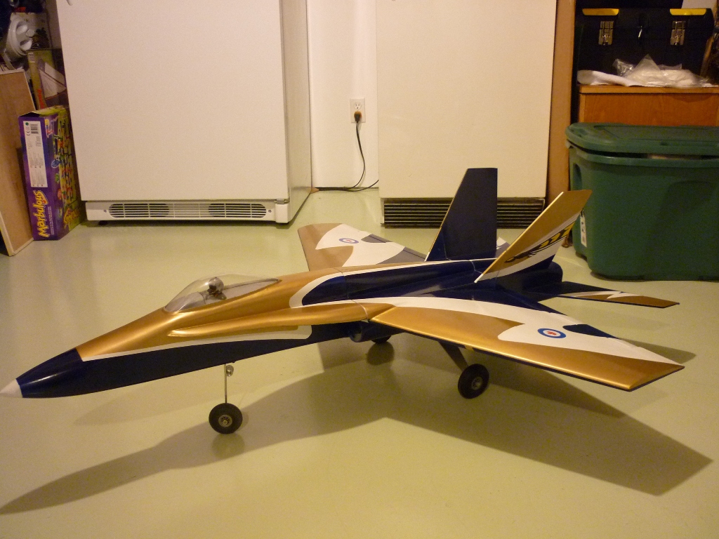

I used the polyC method last year on my pusher CF-188. I had to seal the balsa surfaces first against the water based polyC. It took several coats to fill at least 6. It is best use talcum. I used 75 oz. cloth. I generally found the surface wasn't very hard and is easily dented. I haven't tried an epoxy method yet, but one of the other club members swears by the West System.
I did find that the polyC had enough of an odour to not want to apply this in the house in the winter months.
Jim
Jim
