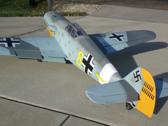

w1nd6urfa 06-05-2014 06:43 AM
2 Attachment(s)
I've repainted in desert scheme "Gelb 14" Joachim Marseille.
My flying buddy's got one too, he's repainting in Heinrich Bartel's "Rot 13" JG 27 scheme, what is interesting is that Bartel's airfield when he flew that plane is the very field we fly in (Kalamaki, Athens, Greece)

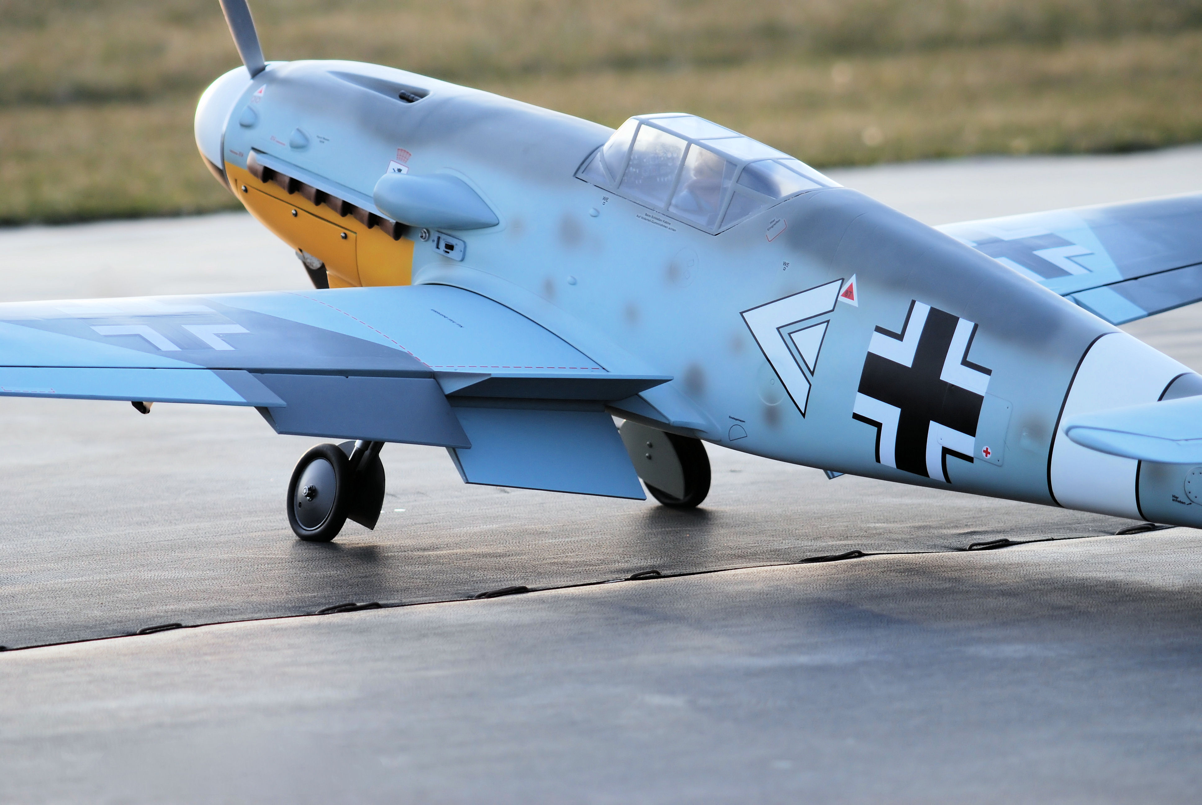

4 Attachment(s)
Iīve just didnīt know it yet. Now Iīm waiting for an aluminium scale spinner, so we can say, that this is a weight in the nose. But this is the dark site of the warbirds with a short nose. I had to put all batteries in the nose.
