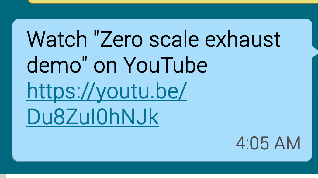

ZERO-322 04-27-2015 01:14 AM
1 Attachment(s)
https://youtu.be/du8zul0hnjk I hope this works lol its titled http://www.rcuniverse.com/forum/atta...mentid=2092462
scale only 4 me 04-27-2015 01:33 AM
haha,, cool
https://youtu.be/Du8ZuI0hNJk I guess it needed to be a capitols, your link has small case letters??
jornmarius 04-27-2015 01:39 AM
Thanks.. I repost your vid ;-)
This looks awsome !
https://www.youtube.com/watch?v=Du8ZuI0hNJk

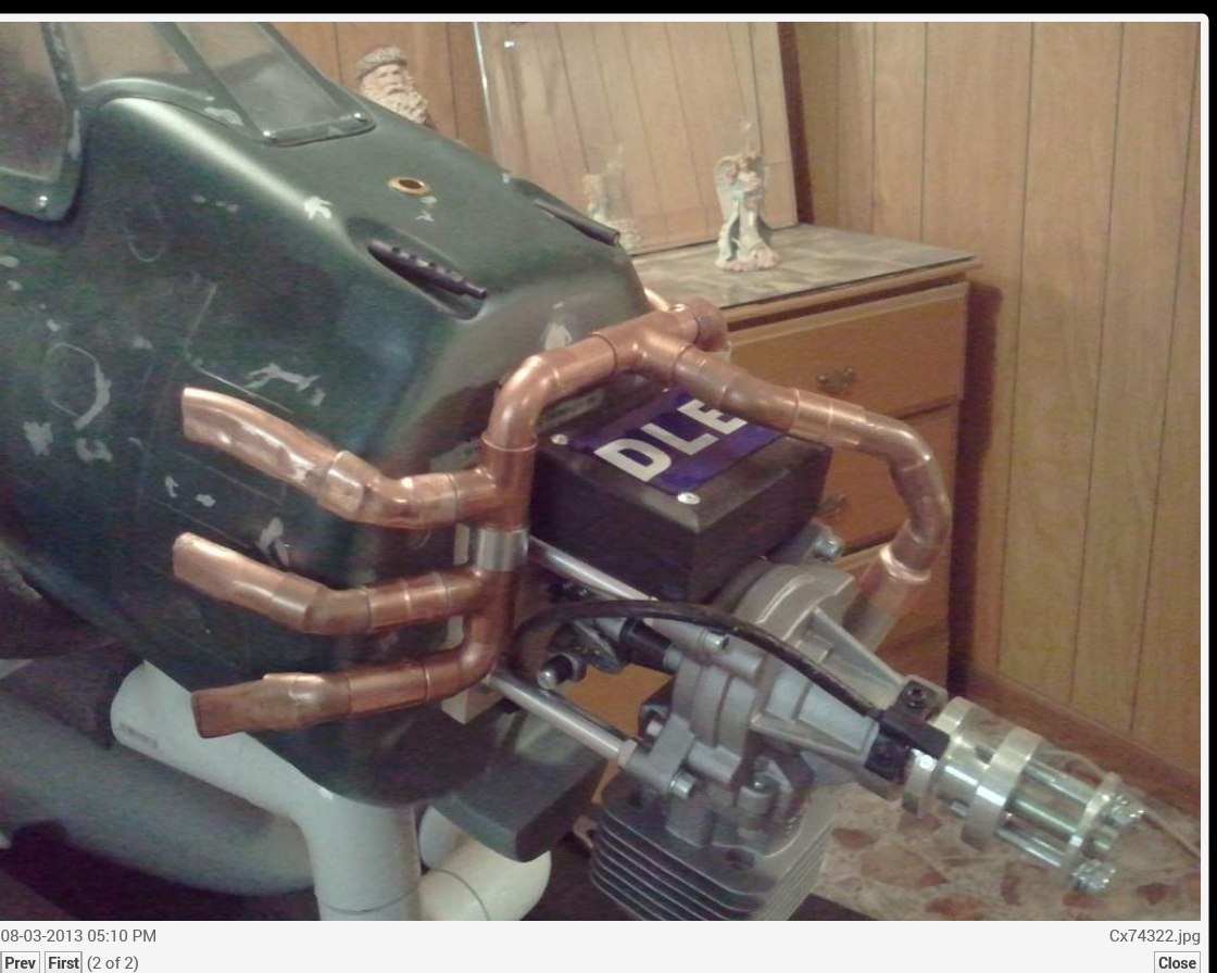

Can you please add some photos of the "plumbing" inside the cowling as well ?
ZERO-322 04-27-2015 07:45 AM
1 Attachment(s)
http://www.rcuniverse.com/forum/atta...mentid=2092512There are more earlier in this thread around page 32 or so
ZERO-322 04-27-2015 07:49 AM
http://www.rcuniverse.com/forum/atta...mentid=2092513

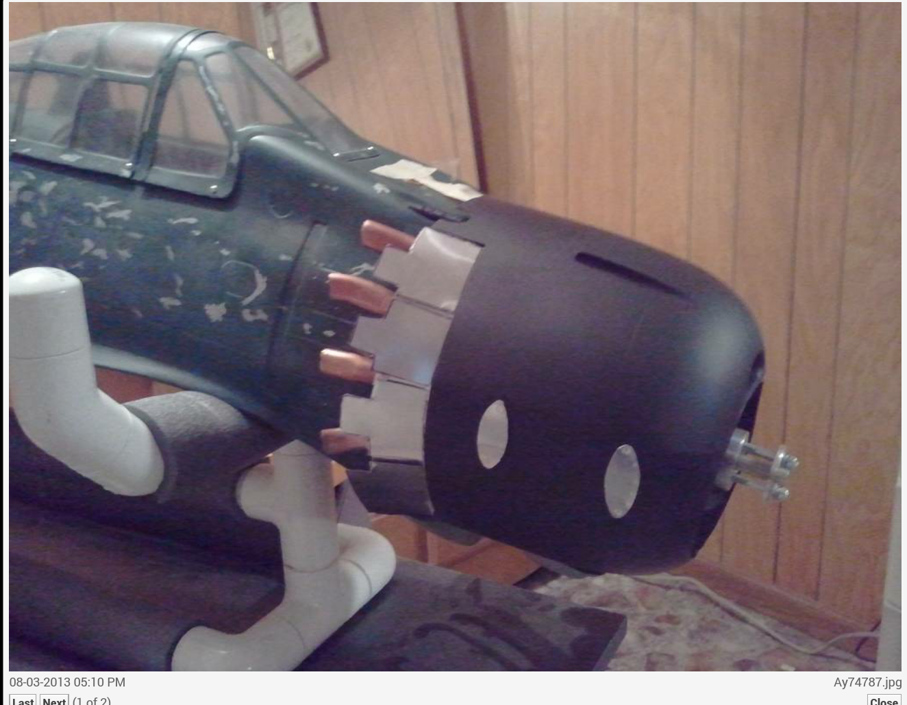

ZERO-322 04-27-2015 07:54 AM
1 Attachment(s)
http://www.rcuniverse.com/forum/atta...mentid=2092513This is with the cowling and aluminum slats installed, I figured should the exhaust rub the cowl I'd rather it aluminum rather then burning the fiberglass , they are adjustable to give me the clearances and wiggle room needed
jornmarius 04-27-2015 11:51 PM
This is looking great :-) ( although I did some effort to rebuild the slats on mine.. they could always come off using the dremel ;-), Cuz as you say, the alu takes the heat a lot better than fiberglass.
How did you fasten the cowling ? Where did you put the mounts ?
ZERO-322 04-28-2015 08:16 PM
I used the original cowl ring , I mounted it set forward of the firewall using some modified copper plumbing brackets I'll post some pic when I get home in the morning
ZERO-322 04-28-2015 08:22 PM
I took me so many tries to get everything neatly tucked and all the clearness correct , there is less then a 1/4 of the cylinder sticking out the bottom of the cowl , I cut the hole for cooling more then anything but I think I could have gotten away with not cutting the cowl at all, I can duplicate the exhaust almost at will lol I'm doing a yellow zero at the moment ( just the exhaust and engine ) I don't have the room to work on a whole plane anymore or the time

What you see pic in mine is a DLE 30 I reversed the muffler to point up instead of down the battery mounted above the engine stand outs and the cdi, the copper exhaust and the heavier cowl slats all contributed to me having to add no additional weight

Sammy I used a metal epoxy called JB weld to glue the joints , this product is rated to 600 degrees additionally after this set up I sweated the joints with Flux to seal any air or exhaust leaks, it's held up just fine for almost 2 yrs and I've run it a half dozen times, the DLE 30 was a perfect fit and plenty of power, however I've also heard of people using a DLE 20 with success , retract wise I've installed a set of Lado 60-1 electric retracts (once you go electric you never will go back ) lol , I know it will take some hunting within this thread in the earlier pages but you'll see I've also cut into the wings and installed the split flaps, all of the hard work is done , but I have yet to put a finish on mine and it could use a better looking canopy anyone know we're I can find one ?
