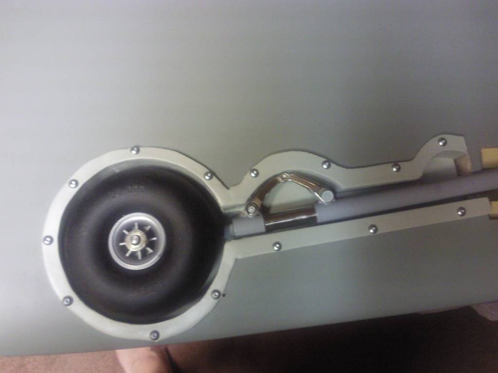

I haven't seen a recent build thread on this plane , so I figured I would start one of my own , I got started on the right wing and figured on using Robart struts with 60-1 Lado retracts , I may even attempt a sliding 3 piece canopy and a full cockpit with a full figure pilot figure not sure if i have the room for it , but we'll see , Engine I am using is going to be a Thunder Tiger 9195 120 2 stoke with a Slim line pitts to keep everything in the cowl and looking pretty , I will post new pic as I progress
I had to open up the wheel well to accommodate the Robart struts and fabricate a new wheel well , I opted to make the new wheel wells removable just in case I need to service the retract .
this is my progress so far

here is the new wheel wells painted up and fitted , I also test fit the strut and it seems to clear perfectly

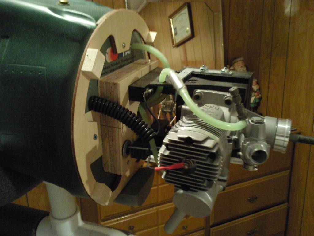

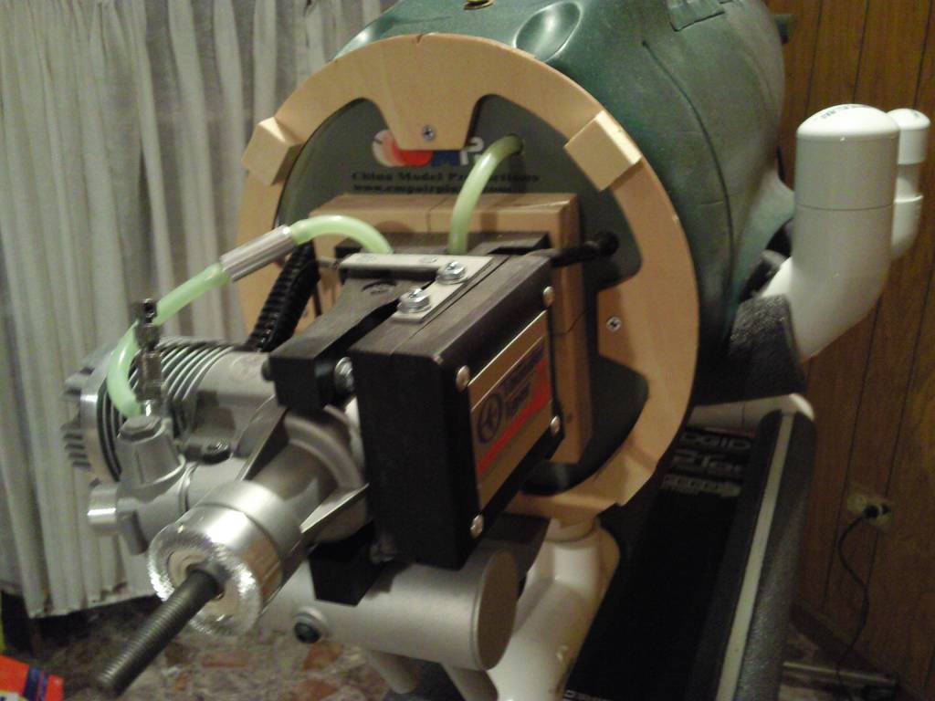

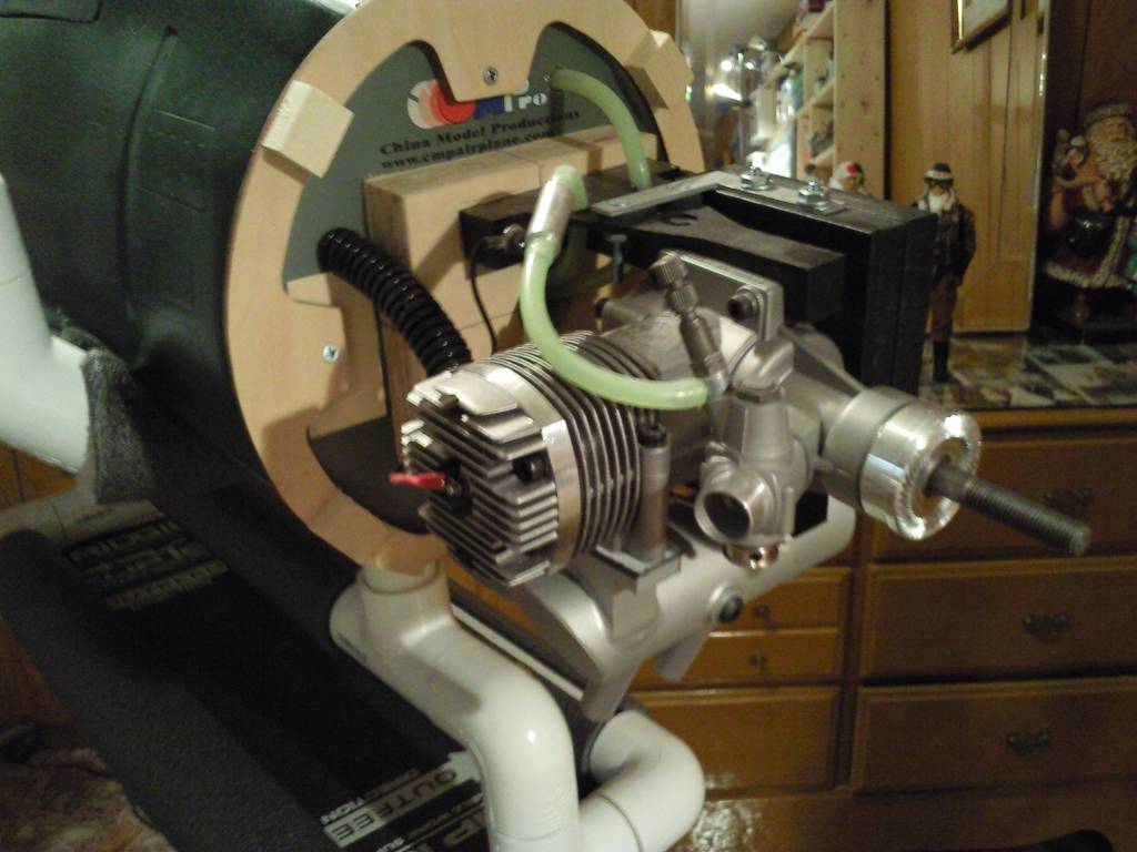

Ok since I had to hold off any more work to the wings pending the arrival of my Lado 60-1 retracts , I thought I would get some work done on the engine installation , I actually got quite a bit done today , I know that this bird is going to need some weight in the nose so I was a little proactive and installed the battery in a box off a bracket that is bolted to the motor mount , I also had to cut and install a gasket from the muffler to the cylinder head (it wouldn't clear the mount otherwise ) I fitted the cowl and cut out my needle valve access
will post my progress hopefully again soon
ID:	1254557   Click image for larger version
ID:	1254558   Click image for larger version

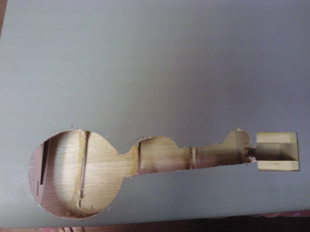

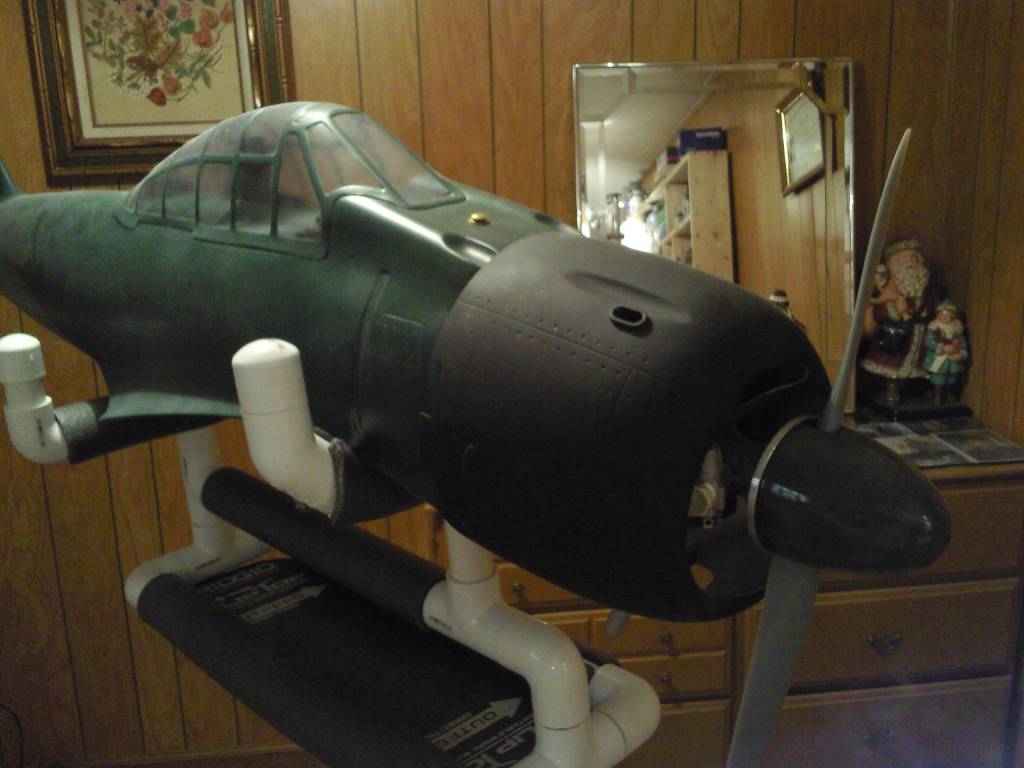

didn't get much done today , but here is a pic of the cowl fitted and cut out for needle valve access , the spinner is from World models at 76 mm I think its a good fit , what do you guys think of the fit and color I selected ?

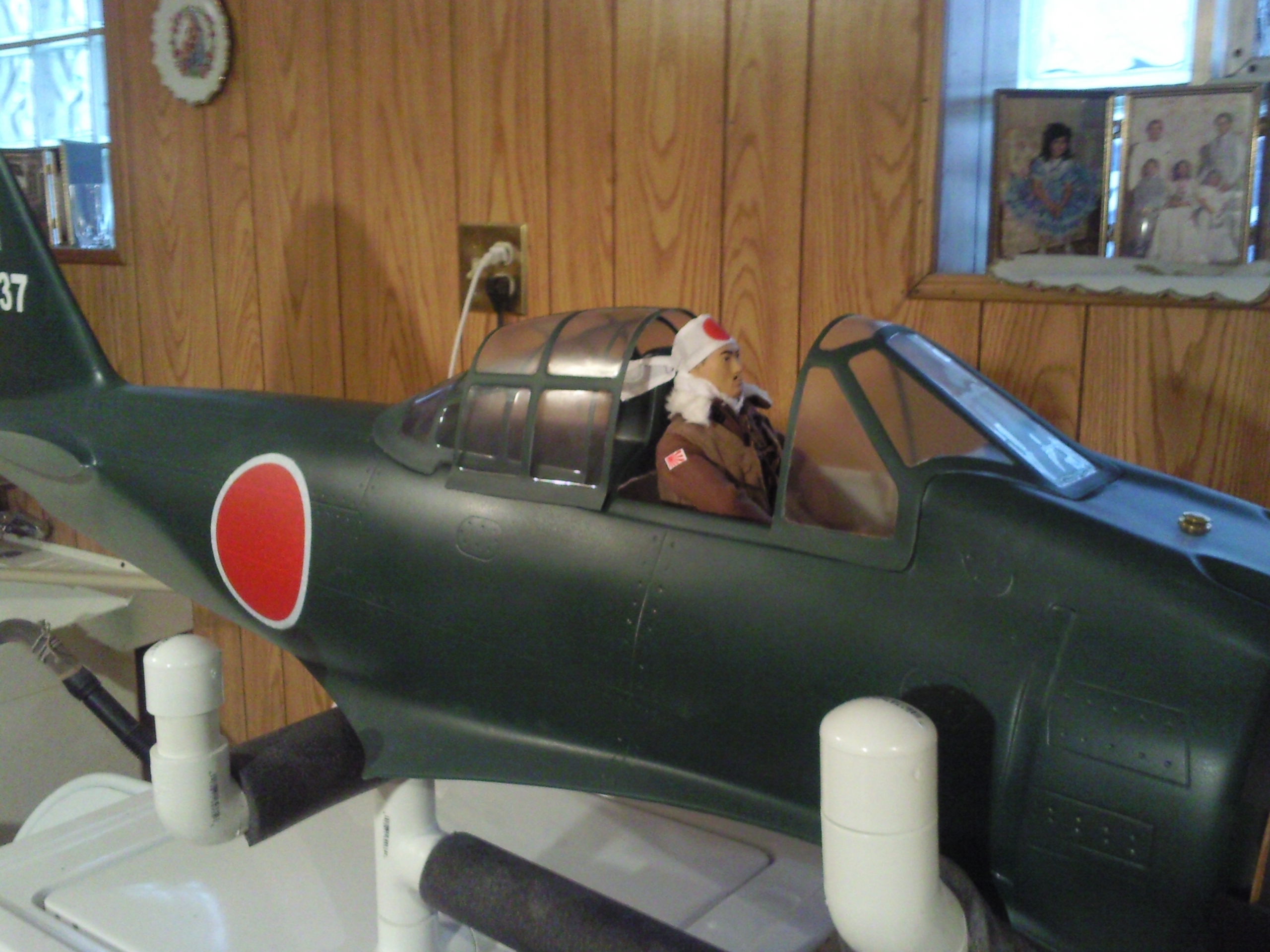

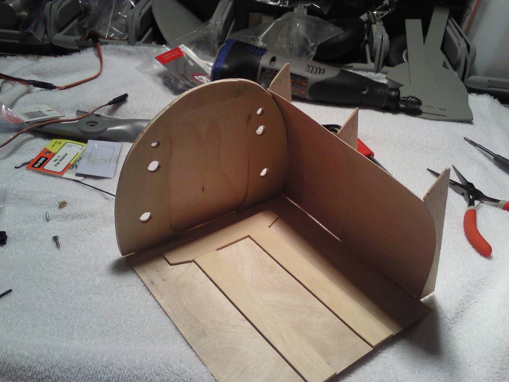

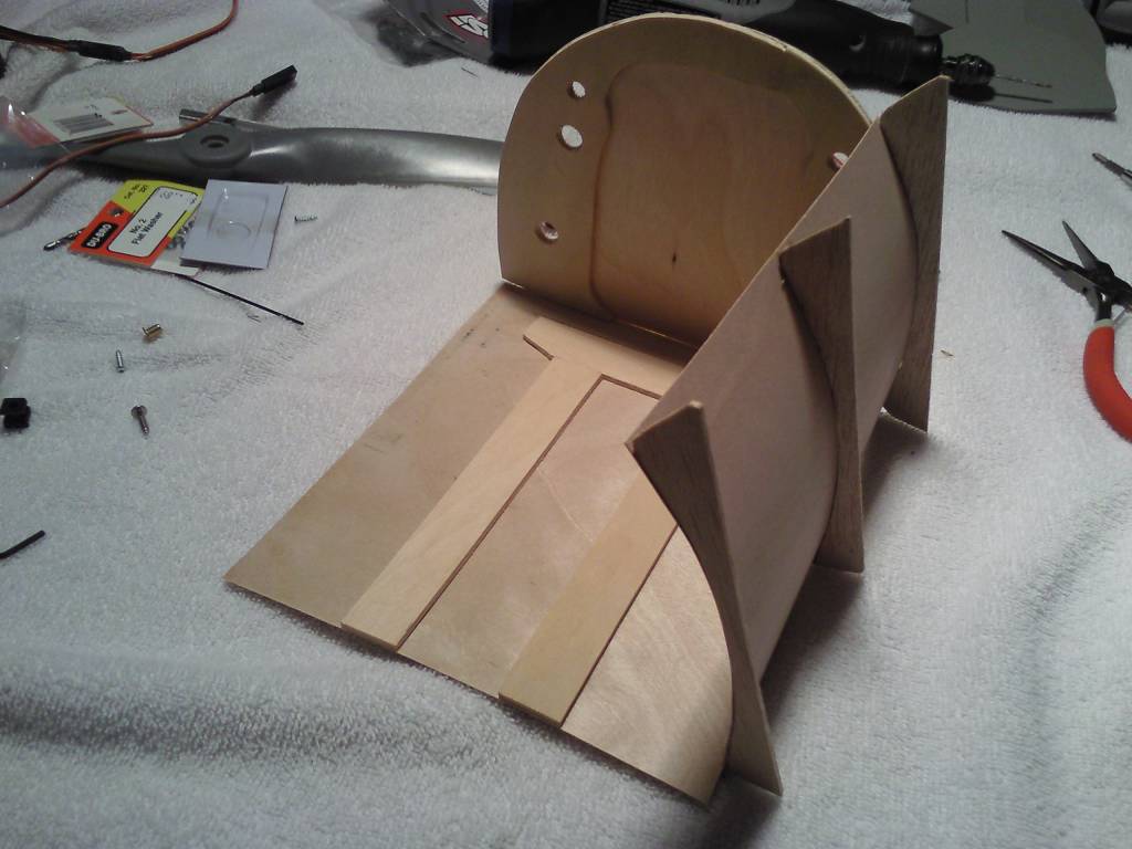

Ok so I've been inspired , I have begun fabricating a full cockpit , going off of some pic I found on the internet and a couple of scaled drawings of a A6M2 cockpit I came across a few years ago , I has to scale them down for my purposes and its been really tedious and I may have to improvise it a little bit for the sake of getting it to fit properly and still leave me enough clearance for servos fuel tank etc , needless to say It may take me a while as I have never done a full cockpit before and I would like to add as much detail as I can with the space i have
Old 08-13-2009 | 09:45 PM
Joined: Feb 2008
Posts: 1,455
From: Elmwood Park , IL
Default RE: CMP 120 Zero ARF Build thread
The cockpit so far
ID:	1255684   Click image for larger version

Ok so the cockpit has proven to be more of a challange then I had figured being the limited space that I have , none the less after a few mock ups and one proto type I think I am starting to get a handle on it , however it is going to wind up more functional for the sake of getting a full figured pilot in and hiding the switch and remote glow as apposed to be being very scale looking , all in all I will do what I can to give a good representation of what a cockpit should look like , really I am going for the look good as apposed to looking accurate
Not very far as progress goes LOL but I did cut the deck ( great so now I'm commited ! ) LOL ..... and placed him in there just to see if he is oversized or undersized for the room that I have to work with

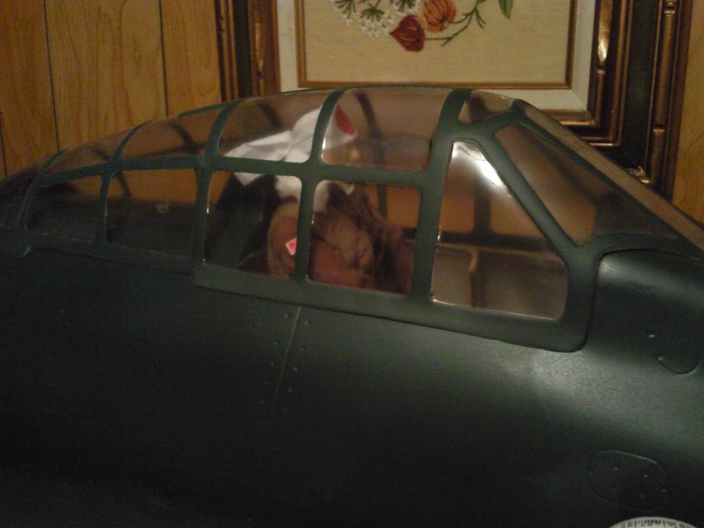

moving along at a snail's pace...... I have cut the canopy and proceeded to put together a three piece sliding canopy that will be manual operated on a magnetic latch , my progress is slow being that i am so swaped at work , but will continue to post as I go along
here is what it looks like so far

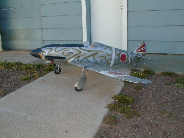

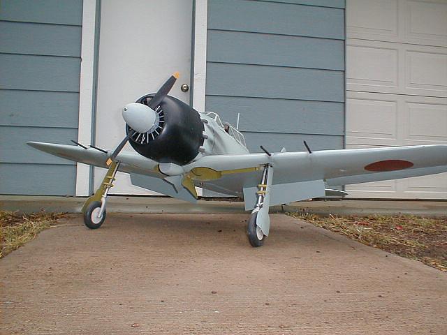

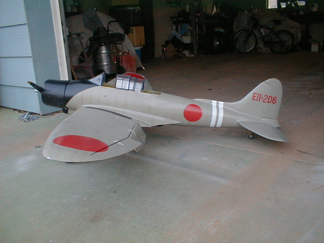

I can't find a pic of the green Zero , but it is in my gallry.
ID:	1262955   Click image for larger version
ID:	1262956   Click image for larger version
ID:	1262957   Click image for larger version

Try it again
Nice ! Very Nice ! ...... On the zero Do the half gear doors actuate with the main gear ? and is that a functional or dummy radial engine I see ?
