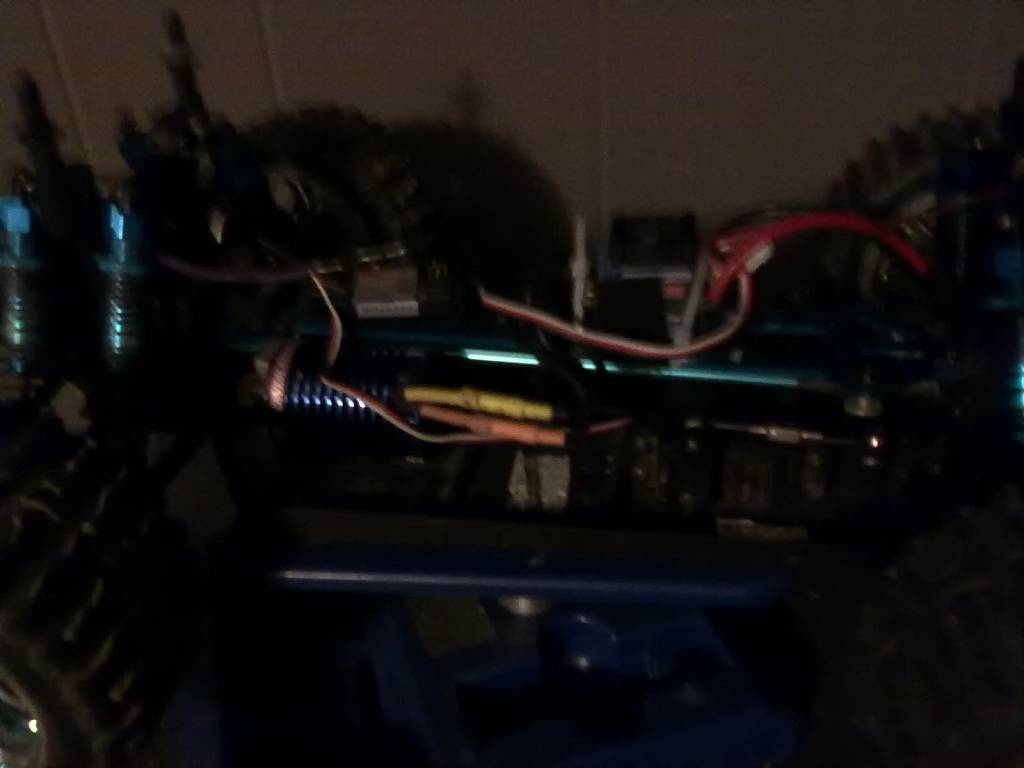

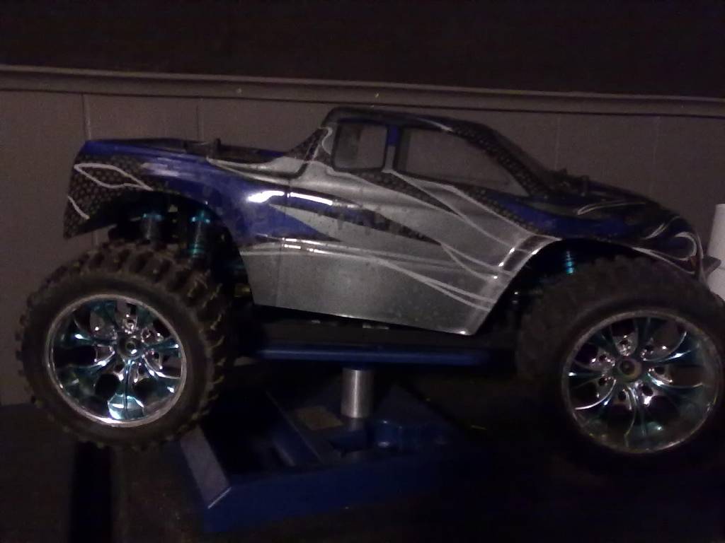

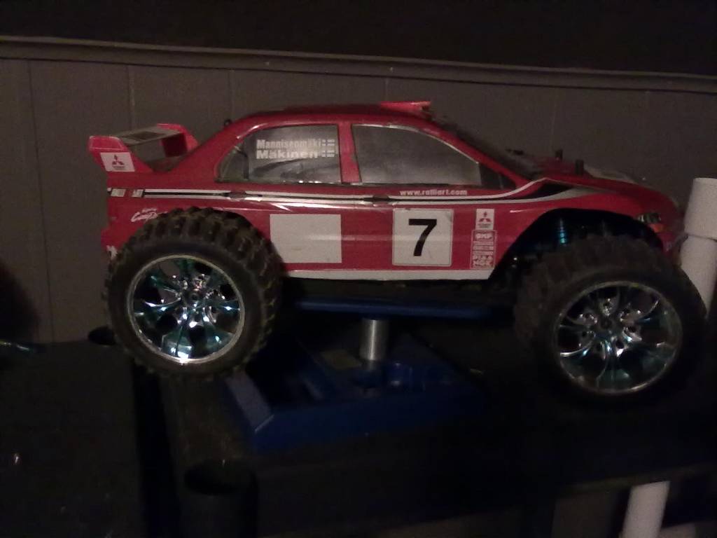

after a winter time bash with a vxl system on 3s in the cold weather, the volcano had some cracked plastic parts and needed some help.
so hear it is, i put an ezrun system in it. upgraded the steering knuckles and the rear hubs to alloy ones.
replaced an a-arm, spur gear, "C" hub and camber link.
tried fitting an old evo body on it. kinda looks cool.

ORIGINAL: rsw007
looks good. how well does that 380 motor pull that truck?
it does fine. its the same motor that comes in the larger cladera 10e!
i have used this motor also in a kyosho blizzard(tracked rc) without issue.
it may not hit 70mph on 3s lipo like a vxl motor(true 540 sized an) but it can do 50mph and not overheat at all.
same with the ESC. its rated at 35amp, but performs as well as a 70-90amp ESC's i have used.

ORIGINAL: rsw007
which turn motor did you go with and what pinion gear? i installed the 8.5t 60amp on my sons volcano with 17t pinion and its pretty quick with 2 cell lipos. cant wait to try 3 cell. i ordered the 9t 35 amp kit first but didnt think it would be strong enough so sold it to a friend for his sons rustler before even trying it. But in the rustler it runs 65mph on 3 cells.
its the 10t 3900kv motor.
using the stock epx pro pinion gear for the volcano.
these 35amp ESC's are underrated. granted, the 60amp is a better choice. it never hurts to have a speed control that is more than what you need.
and even tho the motors are really 380 sized finned out, they provide plenty of torque for a 4wd the size of the volcano.
