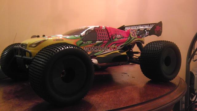

Old 01-23-2012 | 06:48 PM
Joined: Nov 2011
Posts: 756
From: myrtle beach, SC
Default RE: Monsoon XTR
here's a pic of the new Monsoon. <div>This is where I re-routed the lines.</div>
ID:	1717748   Click image for larger version
