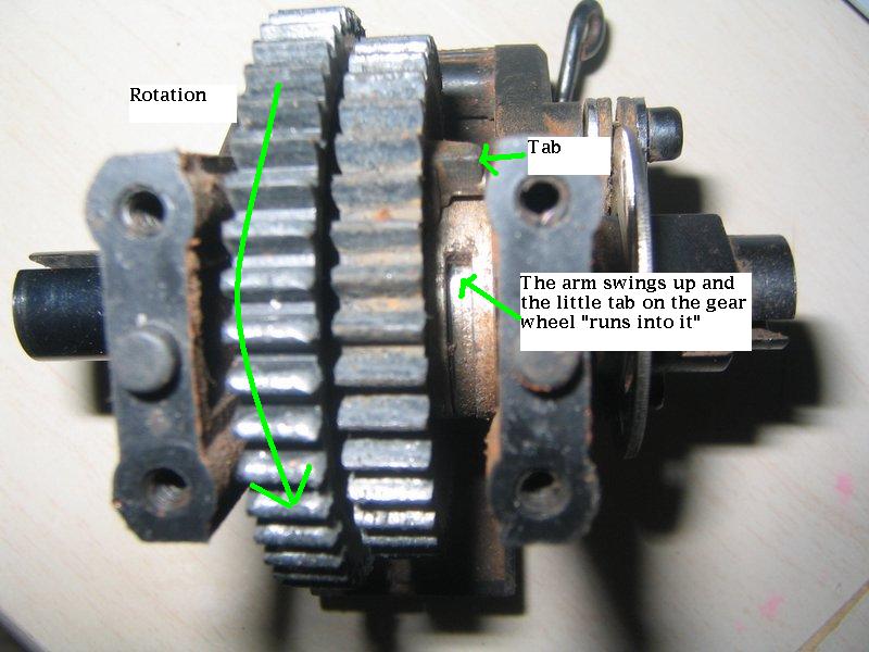

I've just bought a tornado XP with two gears, and i wanna know how to change the gears
How do you do it?

Make it go real fast....
The gears use centrifical force to shift. So once you get going fast enough they'll automatically shift into second. When you slow back down first will automatically kick back in. You'll know that it shifted because you'll hear the engines rpms drop just like in a real car. There's also a way to adjust for the shift point, incase you want second to engage earlier or later. I'll try to get some pictures posted later to show you what to mess with.

Alright well here are the pics.
The first picture is how the whole deal works. Baisically when you're running your car eventually you'll go fast enough to where the little arm swings up and then the tab on the second gear hits it and it becomes engaged. When you slow down the arm folds back down and the tab is no longer caught on it and then first gear is engaged.
The second picture is of the screws to adjust it. I wish I knew which way to turn the adjustment screw but I've never had to mess with it so I really don't know. You'll have to expirement with it. If you guys end up figuring out how turning either way affects the shift point let us know.

Popper loosen the set screw to engage earlier tighten for later. Too tight never shift, too loose falls out and gone![X(] If you adjust this take it out, DON'T LOSE THE SPRING AND LITTLE BALL!, and put blue loctite on it. It has to be at least flush with the clutch or else it'll catch on the 2nd gear engagement tab and lock the car in second. I think factory setting is about 1-2 turns infrom flush. If you still get no shift to 2nd you'll need to remove the trans and clean and check all gears and clean out the clutch of sand grit etc. that may be in it. Also make sure the steel pin is in the 2nd gear clutch tab.[8D] PS your rotation is backwards in that John Madden drawing there arrow should point up.
Old 05-25-2006 | 10:08 PM

No way, I've got the rotation right. I lined everything up and doublechecked it. Although I've been wrong before(not really)... so who knows.
I actually gave madden a call (we go way back) and he ok'd the arrow for me. Even gave me a pointer (PUN!) or two.
Maybe the angle of the picture has you all mixed up.
Anyways, to make the story short. I'm right you're wrong.

OK..OK your're right. Then 2nd gears in backwards,the centrifigal arm pops out and hits the flat on the 2nd gear tab.If the gears are rotating in the pic I don't think you'll go fast. IMO.... They look cool when you get the shift point right on and they click in and the buggy kinda bounces up and starts really movin'! right towards something that isn't moving when I'm driving.LOL
