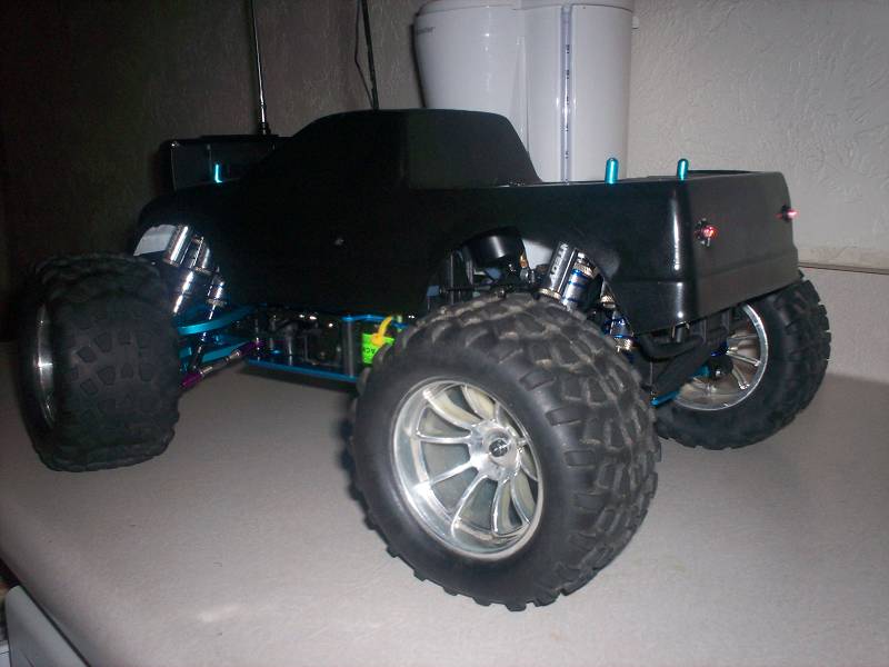

hi i just installed integy shocks on my volcano sv and was just wondering what i can do to make the suspension less stiff, with the springs it came with its too high,i feel like just snipping those damn springs, i waited 2 weeks for these things and im worried that the ride will be too stiff, any thing i can do?

change shock oil

get some softer springs. Integy makes a racing spring set with different tensions get the racing set and use the lower tension springs.

kool, also the hex nuts on my truck are for some reason smashing themselves up against the steering knuckle, i only noticed when i tried to roll the truck and it wouldnt move an inch, the alan wrench screws were tight as hell and the wheels usually spin freely, i know that loosening the alan rench screws and then the hex nut will give it enough play to spin, but from having to adjust them so often now the alan wrench screws are stripped and i cannot loosen them, am i screwed?

No, if you can't get them loose (you might have to take the whole truck) go to the hardware store and find some really cheap hex screw tips, the kind that go in a multiple tip screw driver and find one that is almost small enough but not quite, you can force it in the stripped out screw hole and get the screw out. then replace the screw from one at the hardware store. That's what we usually do. Unless someone else has a better idea. but definatlly if you get them out you need to lock tight them good when you put the new ones in.

SUCCESS!!! i got those screws out the way you said, and after i adjusted them all and put lock tight on the last screw i tightened it all the way and then the tip of the bit i jammed in their broke off inside the screw !!! LOL i guess im lucky it happened to the last one when i was done so i wont have to worry about how i gotta get it out later.as for the springs i dont know what to do, tower only has the 40 piece det for 40 bucks, i only want the 8, it sucks cuz the truck sure looked nice enuff with them when i put them on but i knew something was wrong because it takes a great deal of force to push on my car to get the suspension to give, before i could have one tire on a soda can and the rest would all touch the floor, if i tried the same thing again it looks like my trucks trying to pee in the back![X(](it lifts its hind legs up).im frustrated because i wanted an upgrade in shocks, i know i have to get a softer shock spring set but at the same time how many different types of soft are there, you got a link or a site that sells the soft racing springs alone?id love to be able to go to my LHS but im unsure if they would carry compatible springs.If i have to wait 5 days again for a damn part i might burn this truck![:@]
