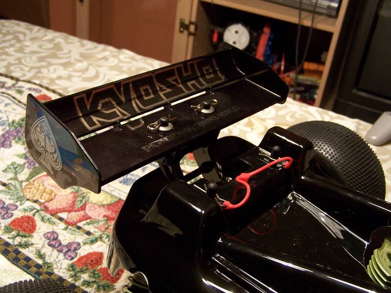

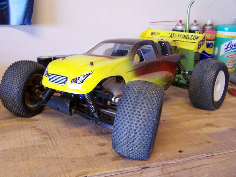

I do not know why you guys want to put a front bumper. It already has one. If you say it is because the body sticks out in front and gets hit and bent that is because the body is put on wrong from the factory. It is supposed to be notched out in the back to go around the wing mount and then the nose of the body does not stick out. I have a cen matrix body on mine and you can see how the front is and the stock bumper works just like any other truggy out there.

Thats exactly it, the body seems to sit too far out. I'm gonna notch out the body so it sits further back.

Notch it out like this...

on closer inspection, the body does have a line moulded in where it is supposed to be notched!
fits much better now
