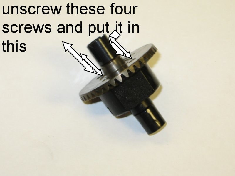

no oil. Just park packed with grease.. Have to take em apart to replace the grease. I did mine last night
don't forget. The black plastic case you see is not the diff. its inside of that and has to be taken aparts after you remove it from the plastic case..

If you are new to this hobby this is what the diff gear looks like, it sets in the front and rear diff box, you remove the 4 screws in the picture and pull off the gear and fill that cup with grease/oil, I used Multi-Purpose Lithium flex grease in mine.

you dont put the oil in the big case, it goes in the case that holds the smaller spyder gears, the big gear and small, (ring and pinion) only get greased up.
