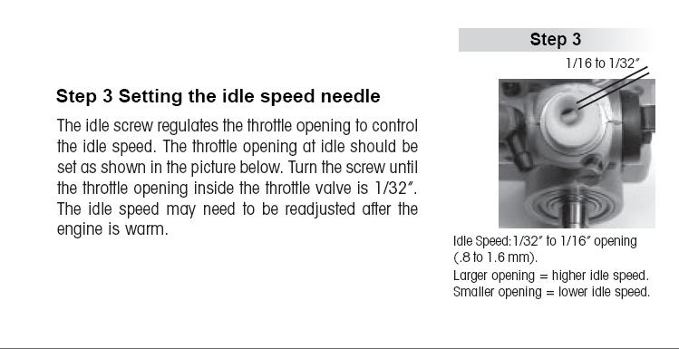

you turn the idle screw until there is a 1mm gap when you look in the carb.

Go 3 to 3 and a half full turns out on the high end needle and go 2 and a half turns out on the low end needle and go by this chart for your idle
the idle should be set so the carb is open 1mm, take the air filter off and check. if not turn the idle screw clocwise until its open a little. are you sure the glow plug is still good, they are known to go during break in and rich running. if the plug is not lighting up, the engine wont start.

Yep, the little black screw directly under the air filter. To get to the mesh, I really need to know the proper way to take the top plate off - cannot see how to properly do so without removing the servo - which seems to be a severe pain.

clockwise opens the idle, counter clockwise closes it. clockwise closes the needles for tuning (leaning), counterclockwise open them (richen). you can feel for play in either the clutch bell or the spur gear, just make sure you hold one of them and feel for the play with the other one.

Yes, I do, but no they do not have glow plugs in stock. I just went and tested it again - 1 mm opening on the idle, low speed to the silver (also 2.5 turns, and 3 tried), high speed tested at 2.5 and 3 turns - still nothing. The glow plug igniter seems to be charged, but forgot dang wrench at home when I went to test it at our shop = did not get to check glow plug. If it comes out to be the glow plug, how can you clean them? (cleaning was posted in forum somewhere, but i misplaced it).
