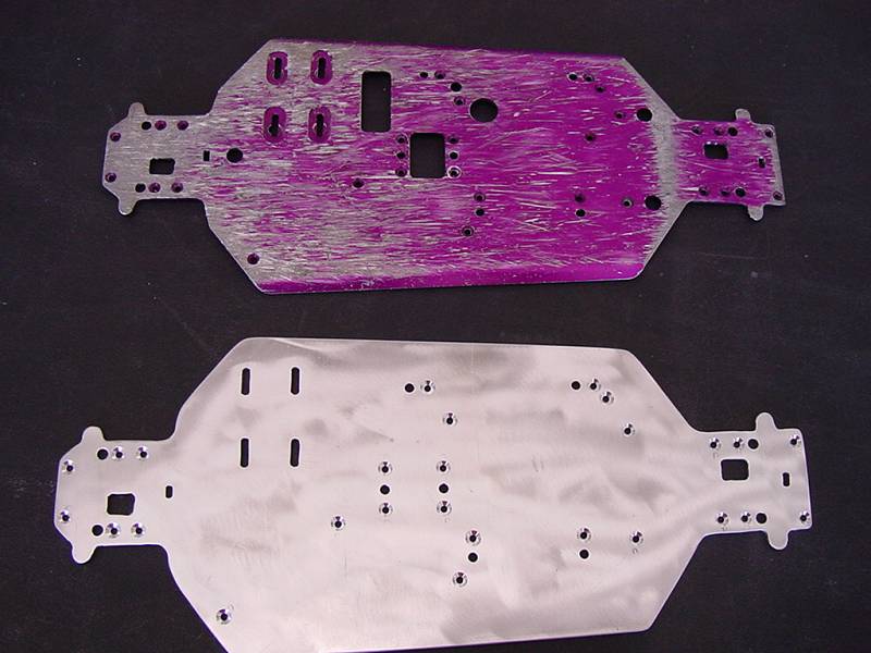

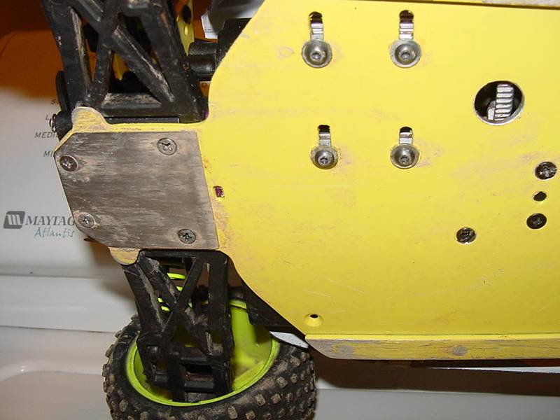

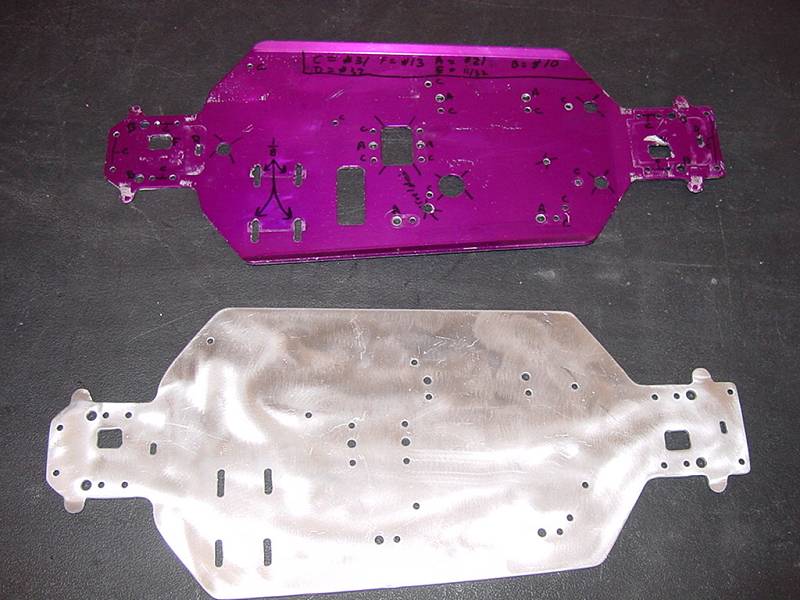

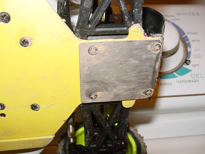

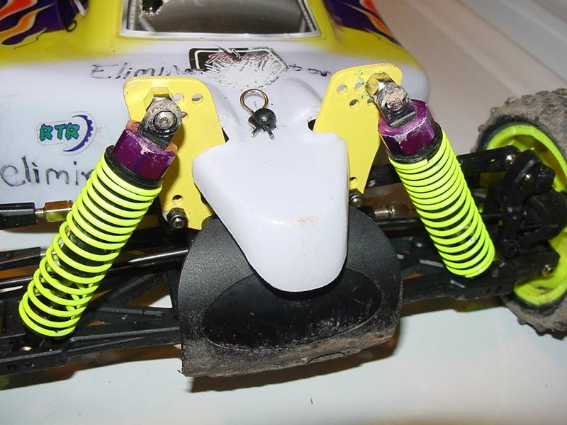

Since my son drives his Shockwave hard, the bottom chassis plate became bent and scraped up pretty bad. So, being in the aerospace industry, I made him a new chassis out of aircraft alloy (for anyone who knows, I used 0.100 inch thick 7075-T6 sheet, much stronger than the original 6061 alloy. I riveted on some stiffening ribs to the outer edges (they also work as a skid plate for the bottom). And, speaking of skid plates, I made one for the front and back at the suspension areas because he was scraping this area up pretty bad. Those skid plates are made of 0.020 inch thick Titanium sheet, dimpled for the countersunk screws. Also, I made new front and rear shock plates out of the same metal as the chassis. It has worked well so far after some hard track racing and jumping. No more bent shock towers even after 5-6 flips.......pictures below.

Old 01-15-2008 | 02:20 PM
Joined: Feb 2006
Posts: 16,490
From: howard beach, NY
Default RE: Upgraded Chassis
quite impressive, i saw the pictures of those yellow shock towers and i was going to ask what was up with that. Very nice

Old 01-15-2008 | 05:48 PM
Joined: Dec 2007
Posts: 29
From: , NJ
Cool, I just finished a design for a hurricane front shock tower. I used 5 mm thick 7075 T6, with some CNC machining done to lighten (weighs 21.4 grams)
I'll get some pictures up when I figure out how to get them out of the program.
