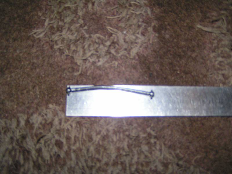

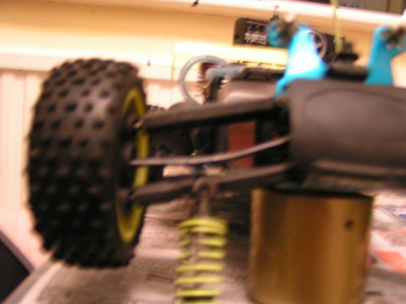

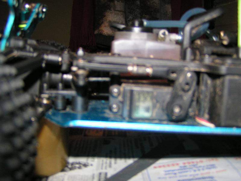

i was at my local skatepark bashing, and i managed to hit the edge of the quater turning round. this popped my dogbone out, which, me not having all the knowledge of putting it back in, had to bend it to put it back in. i did bend it back, but my steering is not good at all. the steering circle has gone from 2 foot to about 5 foot. i dont know if it is the servo, because i had replaced the rubbish stock one to a futaba s3003. any guesses? i will get some pis up soon.

Got any picture's of it ? pictures say a thousand words

You bent the dogbone by hand [X(]
My guess is that since it is bent, it is now not spinning true and is binding in the diff outdrive or the steering knuckle drive cup.
Pics would help alot.
You could try turning the front wheels by hand with the steering turned either way and see if it binds.
I have no clue if it is even possible but if you hit it hard enough you could have jolted the servo hard enough to throw it off it's center (if anyone knows what I am trying to say[sm=bananahead.gif]) Did it turn wider in one direction more so than the other?

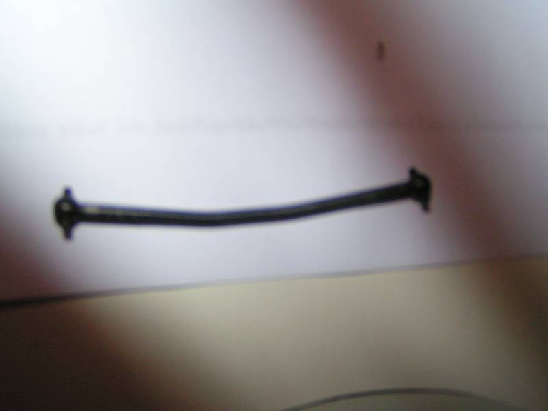

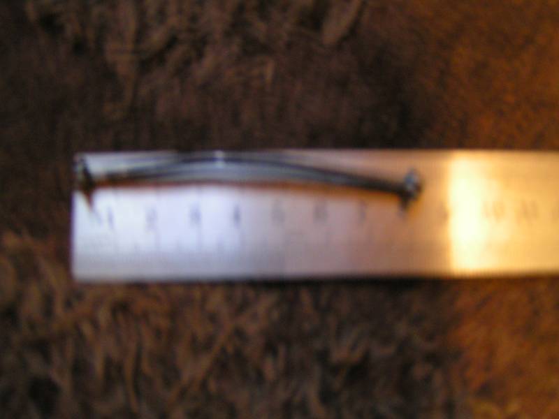

There we are.

And that is the dogbone bent back ?

Thanks, but i am wondering if this is why my steering is not working aswel as it was. the servo or the bent dogbone?.
and to macanan:
attempted lol
best way to bend back?

No, its your dogbone, it needs to be straighter then that.

Yes indeed, you need a new dogbone

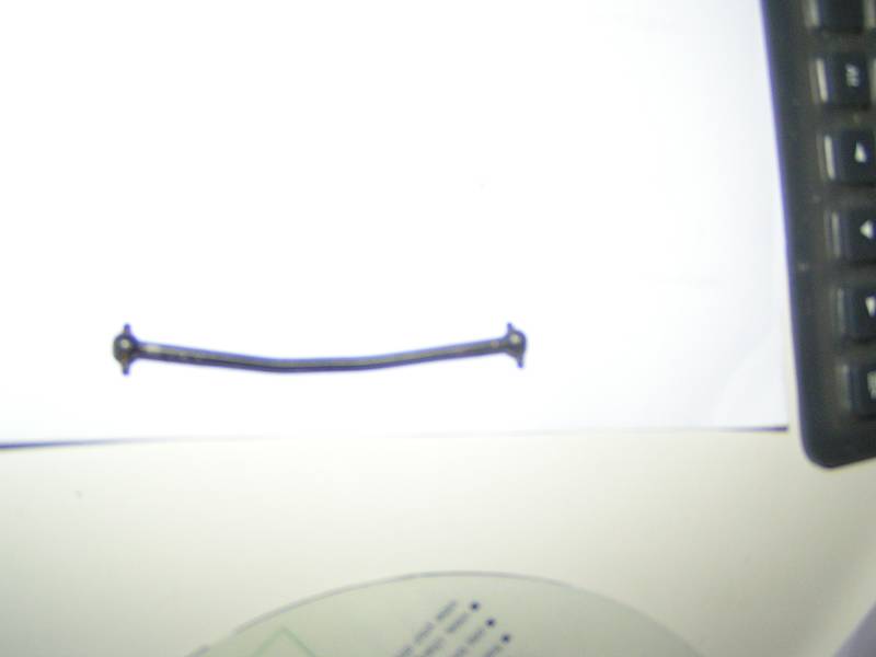

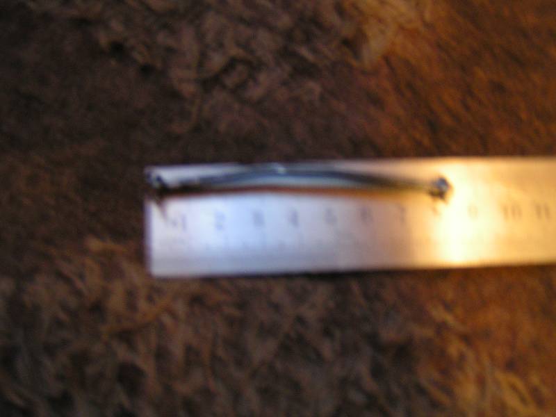

Erm...

That is really in some bad shape to even try and bend back, it would have worked if there wasn't already 2 other bends in the middle of it, you really need to order a new set, when you buy them they come in a pair of 2.
